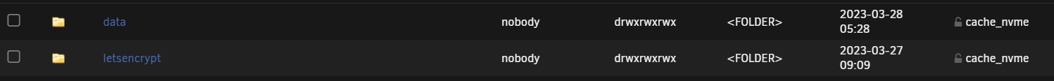

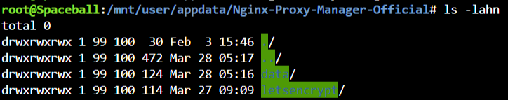

[Support] Nginx Proxy Manager (NPM) Official
Tried 'chown root Nginx-Proxy-Manager-Official' but the container still doesn't start. Is there any other log location where I might be able to see any error when it instantly fails to start?
