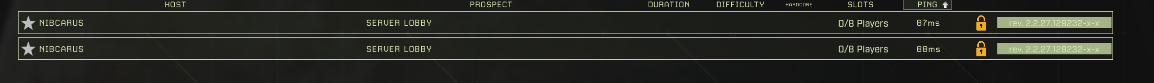

  5. Icarus issues [2024.11.04-12.48.18:450][ 0]LogConsoleManager: Warning: Setting the console variable 'r.Streaming.PoolSize' with 'SetByScalability' was ignored as it is lower priority than the previous 'SetByGameSetting'. Value remains '4500' [2024.11.04-12.48.18:527][ 0]LogUObjectHash: Compacting FUObjectHashTables data took 7.42ms [2024.11.04-12.48.18:543][ 1]IcarusOSSLog: Error: OnResUserTicket : No player found Just attempted a reinstall and getting this as my last line. What can I do to make this work/be viewable on local?

  13. I have ensured both UDP ports are open on the router, assigned to my unraid box, restarted and ensured the server is started, and still nothing. I'm curious what else it could be.
  14. Yeah I have it on a custom network as well, I don't mind waiting it out, do you have a log snapshot of what it will look like if someone joins? I do appreciate the expeditious replies and quick thinking you did to spin this up, thank you!
