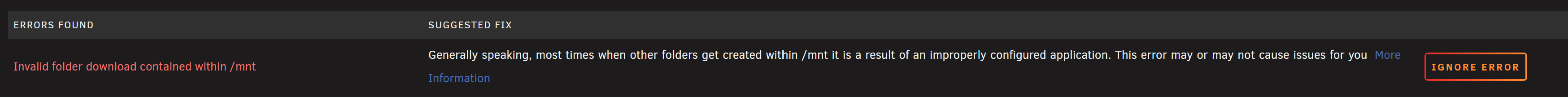

  1. Hi Lovely/Cleverer peeps than me, My server started warning me that I had an invalid folder in .mnt called 'download' a few days ago; so Ive checked every single docker containers shares and I cant find one called download. Everything thats needs it is configured for the 'downloads' folder. Ive had a look at the help files and it says to post the full FCP error and the diagnostics in here. So this is what Im doing. Any ideas? I did try creating a download folder but the error still remains. unraid-diagnostics-20260502-1415.zip
  2. Awesome. Im using direct paths. Renamed it just to be safe, all good. Deleted it all. Thanks for your help!
