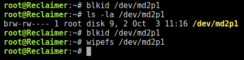

  6. it completed, output of blkid /dev/md2p1 is: /dev/md2p1: UUID="31b5f662-7d37-43fa-93ee-b65c20e8bb92" BLOCK_SIZE="512" TYPE="xfs"
  7. It's printed about 100 lines of ..... after saying "Phase 1 - find and verify superblock... bad primary superblock - bad magic number !!!" Any use installing the removed 2TB drive and trying again?
  8. same thing as blkid, returns to console without any output

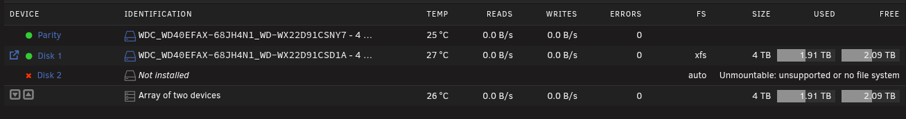

  10. I'm fairly certain I was using xfs, as disk1 is also an xfs disk and I wanted them to be the same, but i could be mistaken and was using zfs. @trurl I cannot seem to find a way to check filesystem in the webUI based on the instructions you linked, I'll keep trying but as of now, nothing is showing me a way to check it.
  11. Here's the fresh diagnostics after starting in maintenance, with parity already valid checked. then stopping, unassigning the drive and starting again. Thanks again. I'm curious what you're looking for in the diagnostics. I'd love to learn more about this stuff! reclaimer-diagnostics-20250930-1533.zip
