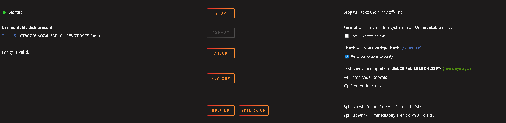

So it stopped trying to fix it now I guess. The status window kinda bugged out, so I couldnt see the final message. But I can now press FIX again if I want to fix it. But that will just result in nothing again I think. So I guess my next step is just to format the sucker....

Yes, it was running all night, then this morning I had the option to click FIX. It has been working since then on "fixing". Taking way longer than I thought, so maybe not sure it will work. But I can take the loss of the drive if needed, its a price I am willing to pay to get this up and running again.

Running through the night it just finished and found filesystem corruption. Pressed Fix....is this going to run for the same amount of hours ?
Replacement drives failing almost immediately...or after hours/days
I have started a check on the drive....looks like its gonna take many hours.

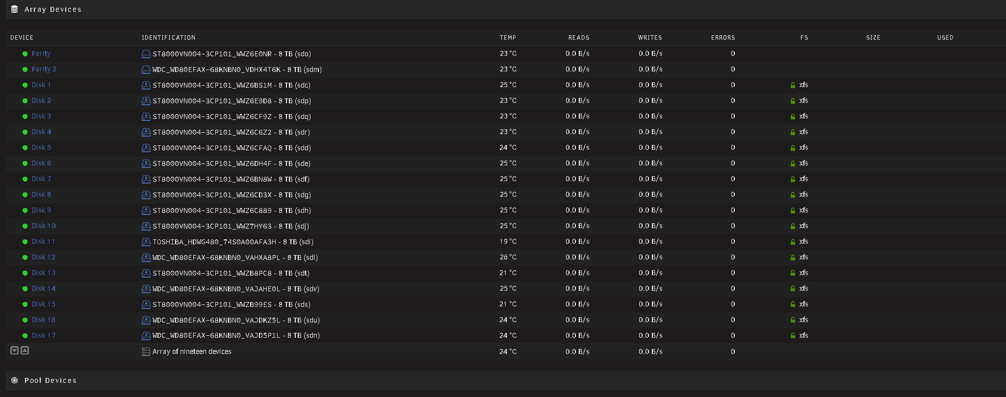

Disk 15 is now showing as unmountable: wrong or no filesystem If I click to format this, it doesnt seem this will rebuild it ?
They were the old disks but they were disabled. Emulated. So to try to use them again/rebuild, I try to have them switch places. But now it seems to have them both working again ? Right now Write Corrections to Parity is checked. I kinda want to uncheck it, start the array up in normal mode and see if I can browse the drives for any data.
After just starting the array again the first time it all looks good ? All disks are green. Do I still need to remove and assign the drives again ?
This will not erase the data in the array right ?

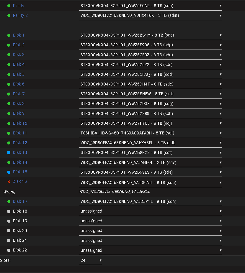

Ok, I have finally gotten hold on some new cables. So to get this working again, I tried switching around the 2 drives that were failing to get them to erase and rebuild. But as I was doing this...drive 16 suddenly reported to the a wrong drive. And it was stating which drive was the correct one (serial number), but that IS the drive assigned in that slot. What is going on ? Now the array wont start in normal or maintenance mode!
