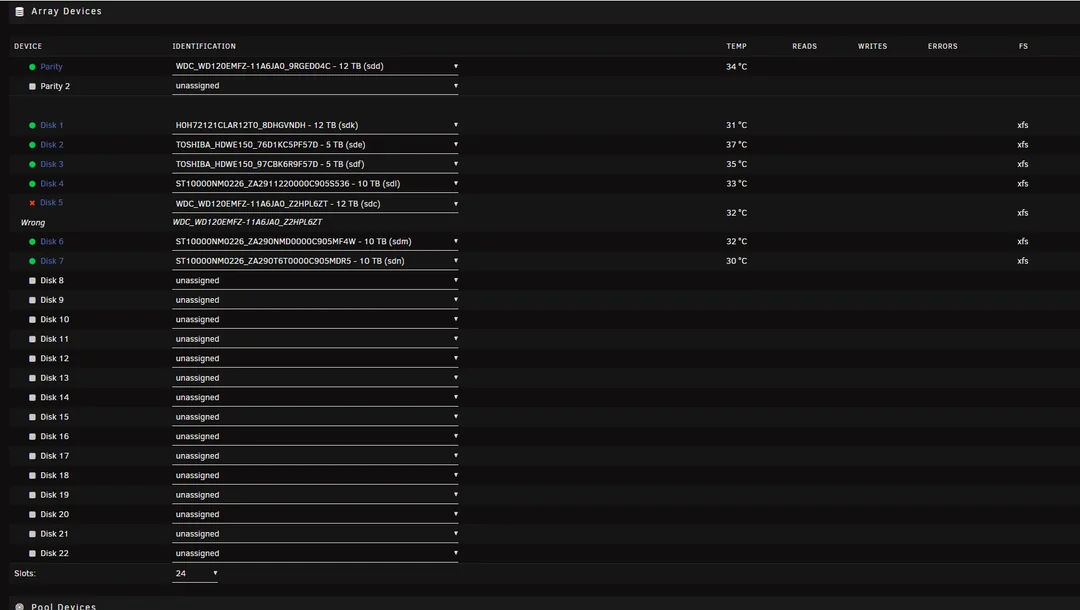

Do i have any other better options? What would you recommend? Disconnect the wrong disk w/ a new disk and see if i can boot the rest of the drives (including parity) and then rebuild the wrong disk. If I went this route, could I check the health of the parity drive first to determine if it's still in a good state? run xfs repair and accept the data loss. I believe this would invalidate my parity drive? boot up all drives, start array in maintenance mode if possible, and try and run xfs repair on the wrong disk drive, which would maintain parity.

I believe they should all be xfs (first screenshot). just to be clear, i just used the ui and buttons. Didn't do any commands.

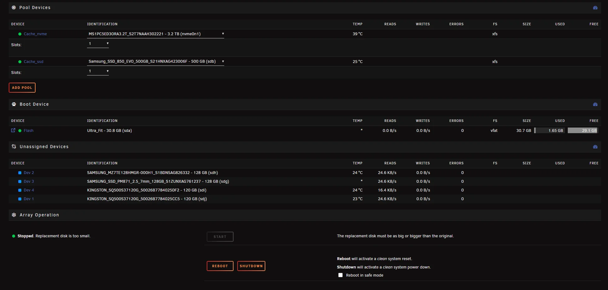

Not sure what I did wrong on this one. And unfortunately it's just been a spiral of bad misfortunes. I'm on version 7.2.3 with an 1-drive parity and on 1/12 selected the 'add pool' button. I was attempting to add 4 small ssds as a new pool to use for VMs. I named it vm and selected 4 slots. When I did this I shutdown the array (not sure why) and then noticed my disk5 in my array had a red x and i saw the error 'the replacement disk must be as big or bigger than the original.' The disk selected was the original 12TB disk. I deleted the new pool and took all 4 drives back to unassigned. No fix. I toggled the x drive dropdown between one of the unassigned drives and then back to the original. Unraid replaced with a green X, so I started the array. It indicated that the error drive had no filesystem and i believe i was getting all the normal options for rebuilding the drive (didn't take a screenshot or look to closely unfortunately). It also complained one of my cache drives also was in the same situation of needing a format. I didn't click anything more at that point. I stopped the array and shutdown the system. My plan was to replace the drive in the morning and just rebuild the drive through parity. I swapped the drive w/ the 'suspicious' drive and bagged the old one. When i went to boot up, i got no power to the devices. I determined this to be a failed/failing power supply. I bought a new power supply. (side rant of bad luck) Unplugging one of my hard-drives broke the sata power plastic l-bracket. I had to buy an adapter and do surgery to get the connector hot glued back on and connected correctly. So this one is in a fun risky state. I plugged everything back in w/ the new hard-drive and new power supply only to discover that my parity drive is making a clunking sound, not detected and i presume to be failed. I'm guessing the power supply failure took it out. So now i'm in a 2 drive failed state that includes the 1 wrong disk and 1 parity drive failed. I have two questions at this point. Given i'm not sure what even happened to my array originally, SMART passed. is it possible the original data disk isn't bad, or at least fully bad? Googling keeps indicating the newConfig tool might fix this situation, but not experienced enough there of the risk and have low confidence level. If i do have in fact two failed drives, do i at least have a option to rebuild the array accepting some loss (vs all loss). I'm posting logs, but this was after a restart. Not sure how valuable it is. Unfortunately I've had to learn a couple life lessons on this one and will be losing semi-important data that I did not backup properly. I really appreciate any advice or pointing in the right direction here. (this is before the power failure and loss of the parity) fridge-safemode-diagnostics-20260112-2302.zip
