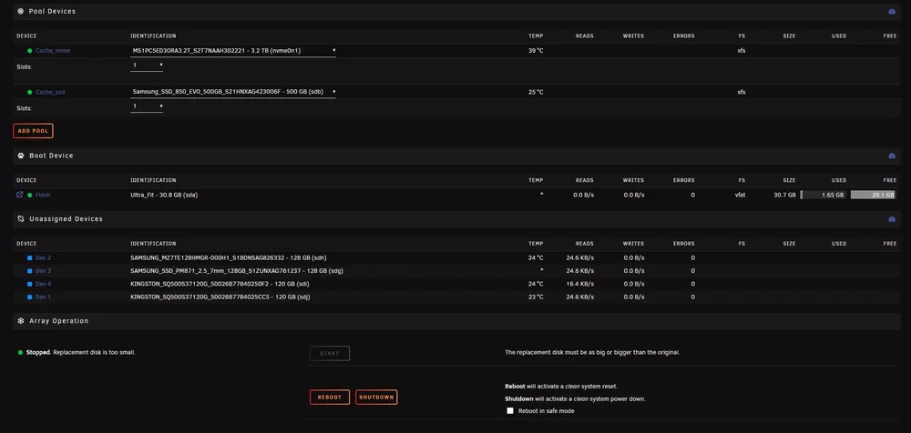

I'm on version 7.2.3 with an 1-drive parity and on 1/12 selected the 'add pool' button. I was attempting to add 4 small ssds as a new pool to use for VMs. I named it vm and selected 4 slots.
When I did this I shutdown the array (not sure why) and then noticed my disk5 in my array had a red x and i saw the error 'the replacement disk must be as big or bigger than the original.' The disk selected was the original 12TB disk. I deleted the new pool and took all 4 drives back to unassigned. No fix. I toggled the x drive dropdown between one of the unassigned drives and then back to the original. Unraid replaced with a green X, so I started the array. It indicated that the error drive had no filesystem and i believe i was getting all the normal options for rebuilding the drive (didn't take a screenshot or look to closely unfortunately). It also complained one of my cache drives also was in the same situation of needing a format.
I didn't click anything more at that point. I stopped the array and shutdown the system. My plan was to replace the drive in the morning and just rebuild the drive through parity. I swapped the drive w/ the 'suspicious' drive and bagged the old one. When i went to boot up, i got no power to the devices. I determined this to be a failed/failing power supply. I bought a new power supply.

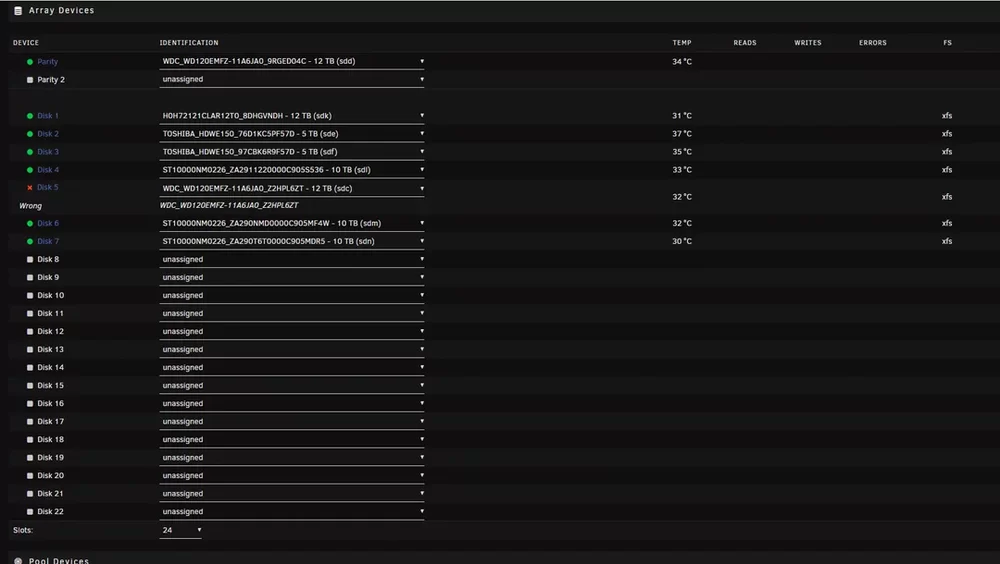

2 hours ago, peteopp said:
So now i'm in a 2 drive failed state with only 1 parity.
Diags still show parity as OK, only one "wrong" disk, to confirm, parity is no longer available?
Yes I believe that’s confirmed parity no longer available. Sorry, that was misleading, updated the original post.
After a power supply failure, the drive exhibits a rhythmic clunking and doesn’t show in bios.
Edited by peteopp
If parity is gone, the best is trying to correct the "wrong" disk.
Post the output from:
blkid /dev/sdX1
fdisk -l /dev/sdX
Replace X with the correct letter for disk5, it was /dev/sdc in the screenshot, but can change with a reboot.

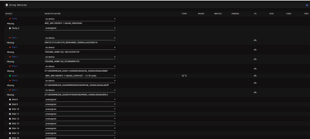

I booted just the 'wrong disk' disk 5 drive by itself.
output running command on disk5.
blkid /dev/sdX1
fdisk -l /dev/sdX
root@Fridge:~# blkid /dev/sdb1
/dev/sdb1: UUID="7cc35300-8d3a-4f85-ab57-2ef1ef23a753" BLOCK_SIZE="512" TYPE="xfs" PARTUUID="3eb93511-f9ca-461d-a5d4-151667d662cd"
root@Fridge:~# fdisk -l /dev/sdb
Disk /dev/sdb: 10.91 TiB, 12000138625024 bytes, 23437770752 sectors
Disk model: WDC WD120EMFZ-11
Units: sectors of 1 * 512 = 512 bytes
Sector size (logical/physical): 512 bytes / 4096 bytes
I/O size (minimum/optimal): 4096 bytes / 4096 bytes
Disklabel type: gpt
Disk identifier: F13208B8-A644-444D-AE9E-27348004A00D
Device Start End Sectors Size Type
/dev/sdb1 64 23437770718 23437770655 10.9T Linux filesystem
root@Fridge:~#
Edited by peteopp

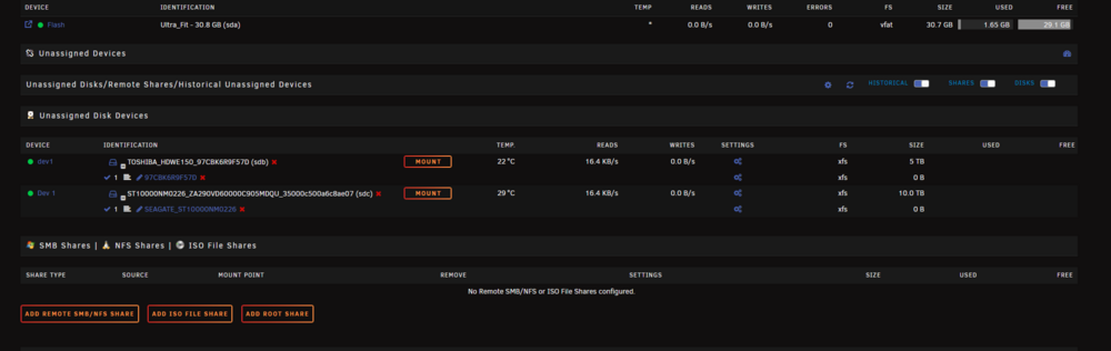

I already tried mounting one of the drives as unassigned and it threw and error and didn't let me.
Jan 16 13:42:04 Fridge unassigned.devices: Mount of 'sdd1' failed: 'mount: /mnt/disks/HITACHI_H0H72121CLAR12T0: mount() failed: Function not implemented. dmesg(1) may have more information after failed mount system call.' Jan 16 13:42:04 Fridge unassigned.devices: Partition 'HITACHI H0H72121CLAR12T0' cannot be mounted.
Do you know what filesystem it is supposed to be?
I believe they should all be xfs (first screenshot).
just to be clear, i just used the ui and buttons. Didn't do any commands.
Edited by peteopp

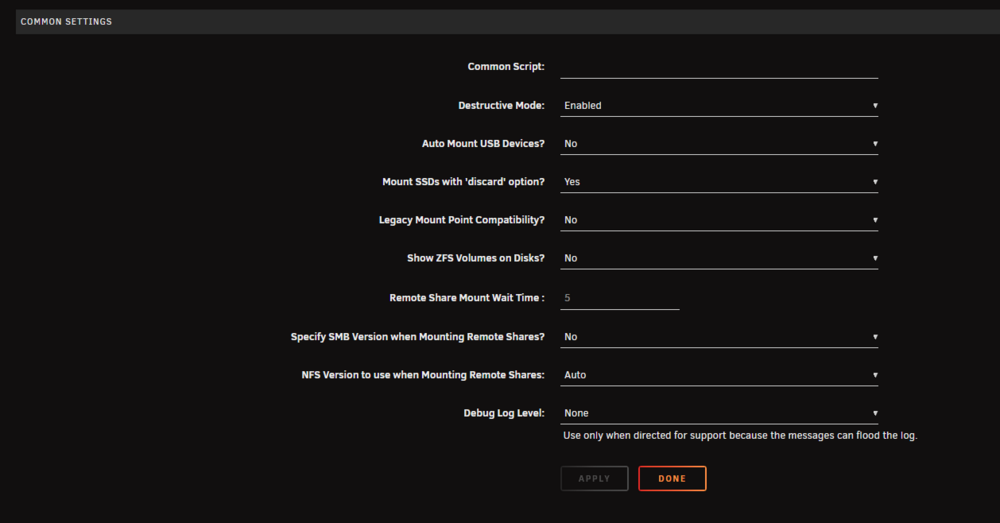

I also found my unassigned settings to be in destructive mode. Seems like a good idea to take that off for now?
