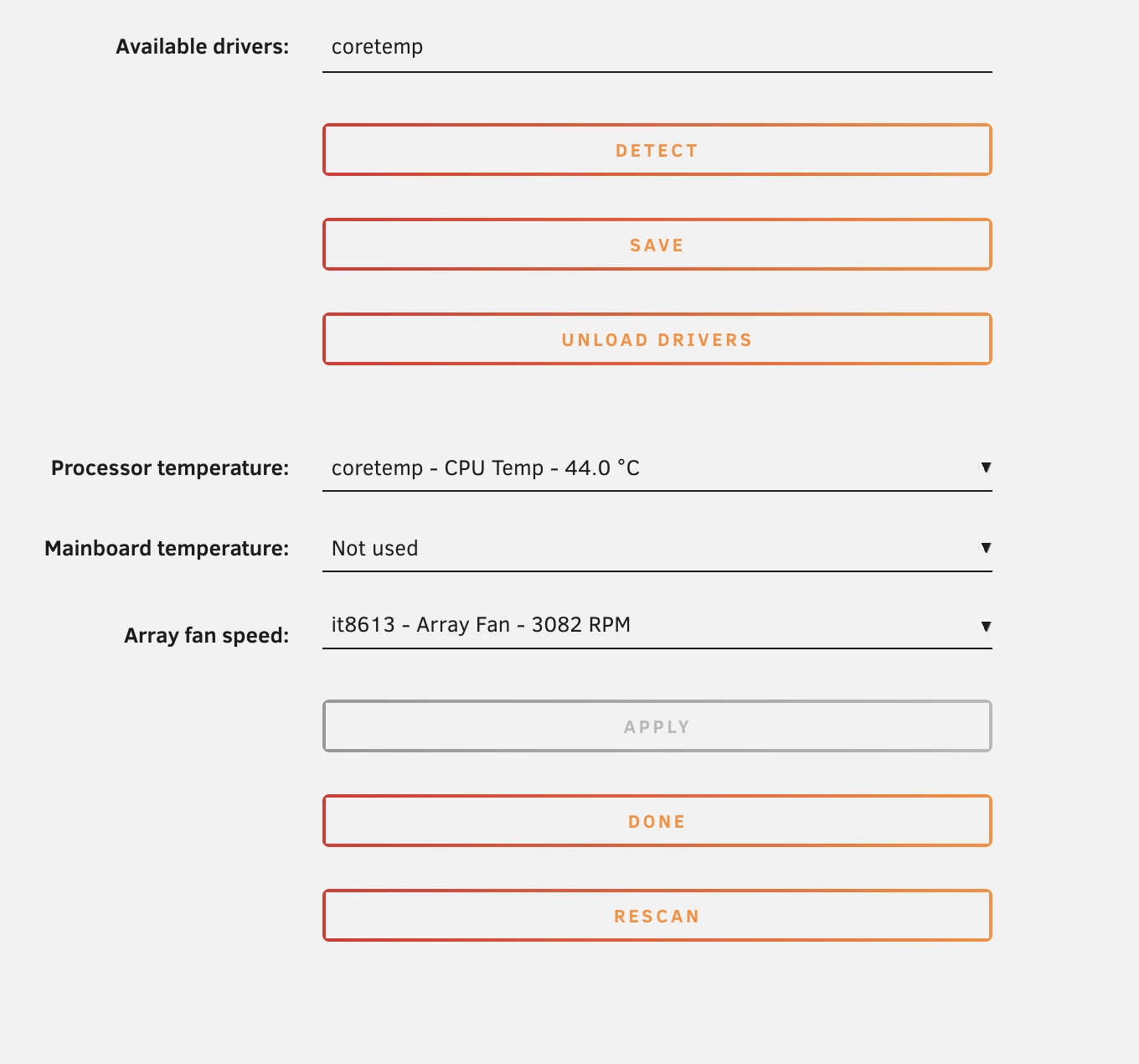

Thank you @trurl - this is what I have in the settings for the fanctrl plugin - can't seem to turn off logs for this: As for syslog server, already activated with copy being saved on the cache drive. As for memtest, I have not run one yet as the NAS is quite new (got it one month ago). I would run the memtest if I had access to the server just now, sadly, I am away traveling working remotely for the next couple of months. Do you suspect it is a RAM issue?
