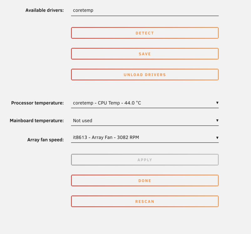

Turn off logging for this plugin:

Thank you @trurl - this is what I have in the settings for the fanctrl plugin - can't seem to turn off logs for this:
