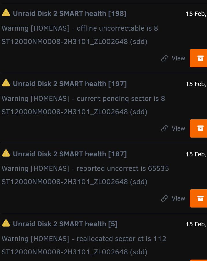

  5. Hmm extended test ended out of no where, now I can't start any smart test. Log just says "Read SMART Log Directory failed: scsi error aborted command" Also got the following warnings since boot up. Reallocated is now at 216 I'm guessing disc dead, check warranty?

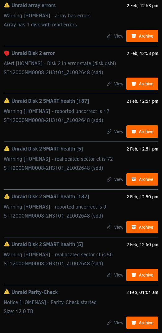

  7. When I click Start short SMART test is stops instantly. This is what is shown under SMART Selftest history and SMART error log. === START OF READ SMART DATA SECTION === Read SMART Log Directory failed: scsi error aborted command Read SMART Error Log failed: scsi error aborted commandHere's the downloaded smart report. I'm unsure how to check connections as you suggested? ST12000NM0008-2H3101_20260210-1354.txt
