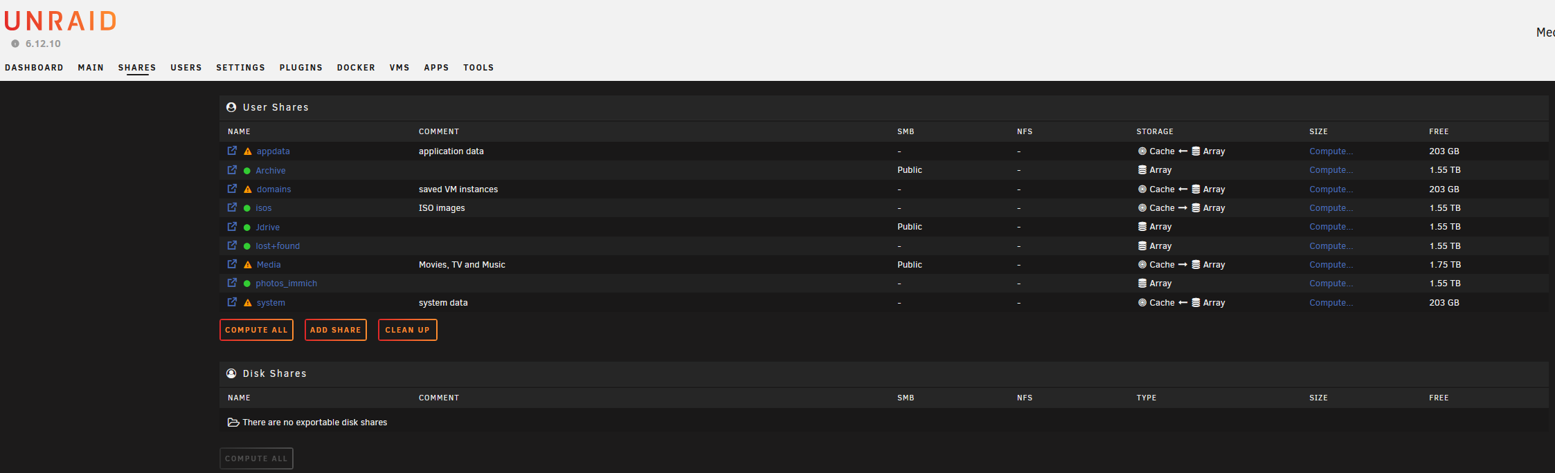

  1. When open those shares - I dont see any data. I suppose all I can do is start sorting though the lost and found and put them in the right places. Any advice? Also while Im here. Are the appdata, domains,system and Media supposed to be "unprotected"? I have only 1 cache drive, so Ive read thats the reason. Just confirming. I think I'll move Media to Array but not 100% sure if that means it will be slower to access via Plex.

  6. I see some data but not sure if its everything. Was hoping reactivating the shares would allow me to find the data in their original locations
  7. I found via MC the old config files for the shares - not sure if this helps. I suspect all my data is in the lost+found file. Not sure where to enter that command. Im quite new to this (followed tutorials for setup but that was step by step).
  8. Hi there, first time having an issue after 2 years. One of my Hard Drives died but I had a parity drive. Installed the new one, plus an additional one. Parity began and completed. Things seemed to be working correctly. Immich started having issues and then my Shares disappeared. I ran xfs repair and it enabled the array to work again but only a few shares returned but I cannot see data within them. Still says theres data within it though. Just cant view it. Not sure what the next steps could be. beastserver-diagnostics-20260225-2130.zip
