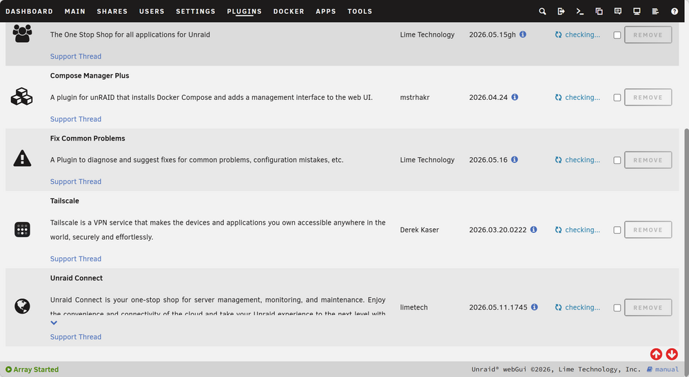

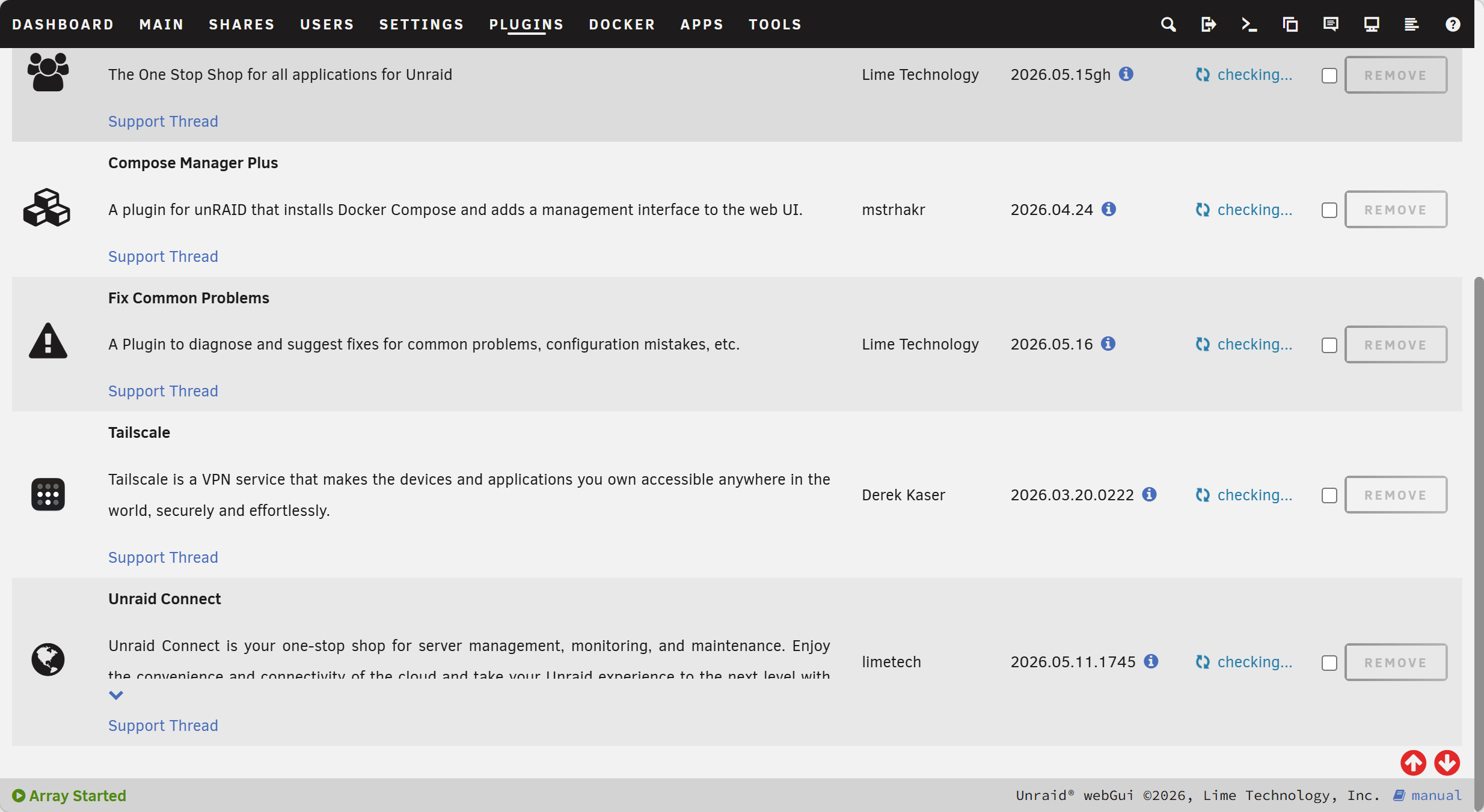

  6. Hey, thank you for your reply, but I have installed these applications.
  7. Hi Guys, I want to enable the remote access of my server according to https://connect.myunraid.net/help . But I cannot find the Unraid Connect icon after installing the Connect app, as shown in the figure of the guidelines. The uBlock is disabled. The capture of the guidelines: The capture of my server:
