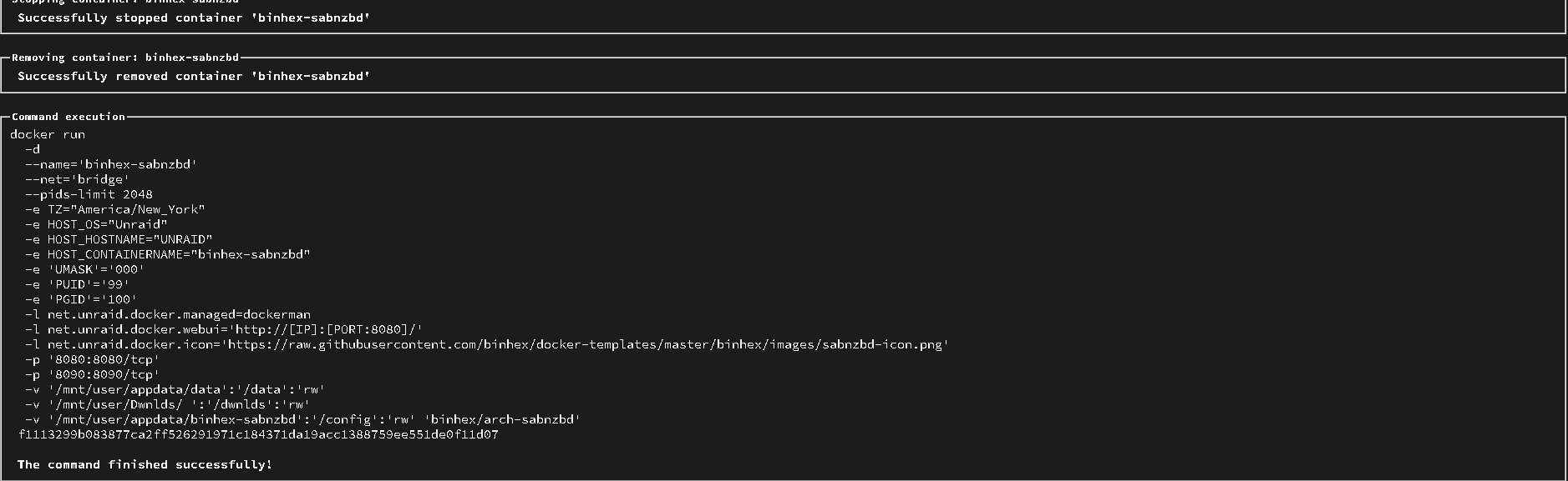

where at in sab would i change the container path to "downloads" instead of dwnlds

i would need some help properly mapping the paths out then. i had help from a friend setting this up so i dont entirely remember how todo these things on my own.
stuck on downloaded waiting to import
so from what im understanding here is that my container paths obivously need to match for sab and sonarr and radarr to make sure theyre going into the proper locations to be grabbed for viewing.

yes when reinstalling it went back to its normal state before i made any changes to it . also displaying this issue as well which im guessing is because things arent being pointed in the proper direction./path- stuck on downloaded waiting to import
i changed the port number on both sonarr and radarr in order to get the docker run page to show up. afterwards i reinstalled then changed the ports back to their origional status. - stuck on downloaded waiting to import
