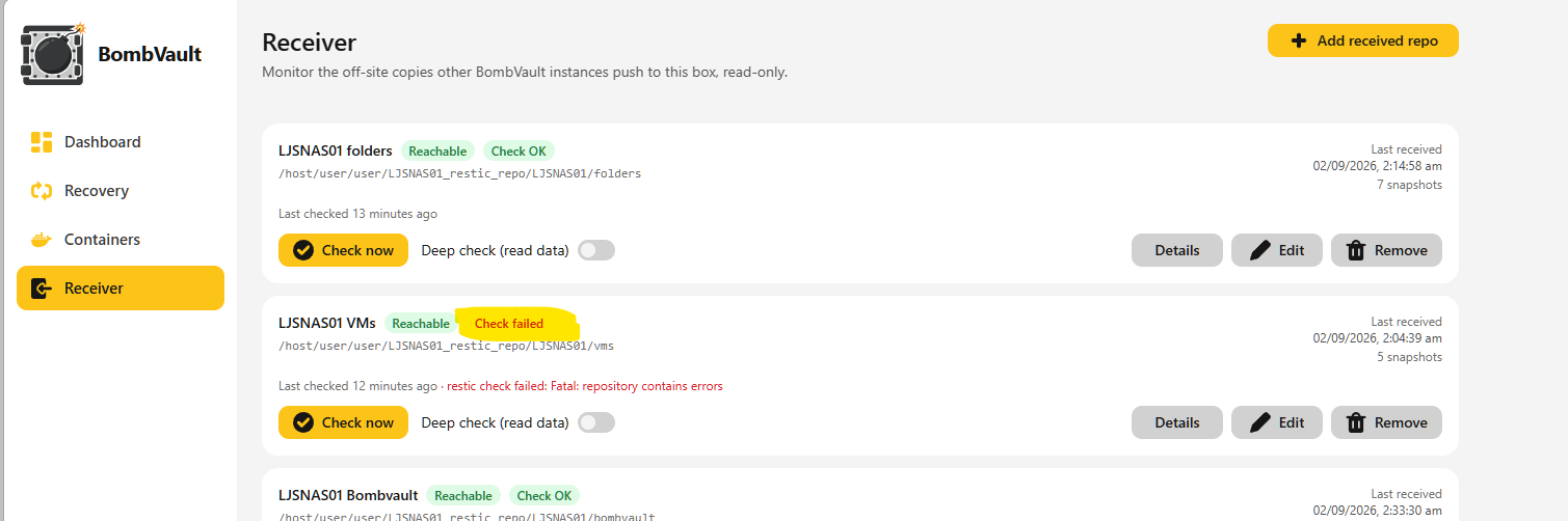

Thankyou for the comprehensive reply, with the new release and this help I've got a few steps further forward but have now hit this on the remote end: I then connected to the bombvault container on the remote end and tried to use the restic cli there to check and repair, but I don't have the password. Bombvault says that the restic password is derived from the bombvault key.. but doesnt say how. Can I translate it? (I'm fairly sure the password restic is asking for is separate from the restic-server password thats used for connections over the network, but i have tried that too.) EDIT- somewhat obviously the password is in my recovery kit!

I'm trying to set up an offsite and have two issues. On the remote end I'm trying to monitor the destination but i get an error message trying to save the settings - "could not open the received repository: wrong APP_KEY, or the location is not a BombVault[path] repository" Secondly, I'd also like to set up the remote restic to be immutable, but the test always fails. Despite the fact that the remote restic reports in its logs that it is- Data directory: /data Authentication enabled Loaded htpasswd file /data/.htpasswd Append only mode enabled Private repositories disabled Group accessible repos disabled start server on [::]:8000 Broadly the docco is too light - it really needs more examples so I don't have to spend so much time reading between the lines and guessing at settings until things work. I couldn't get the scripted deployment of a restic docker functional, and it couldn't be edited in the docker UI, so I used one from CA instead. As I suggested in a feature request on github, I think the immutable offsite should be baked into the product, not instructions for a docker you can't manage in the Unraid UI. All the components needed are there inside bombvault. I'd also find it more logical if the flow of the app was more like other backup products where there are sources, jobs and repositories, but hey- I can manage with that.
