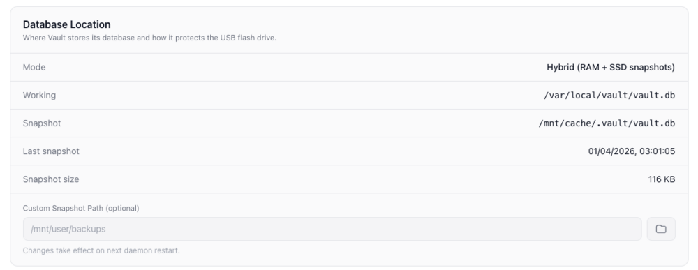

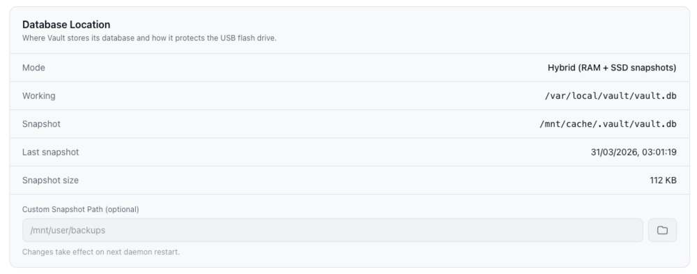

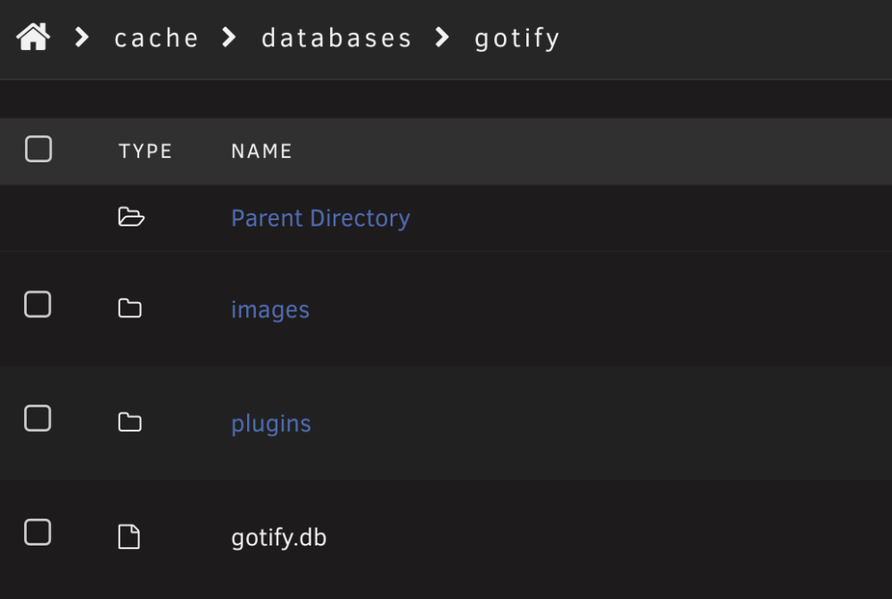

You change the custom snapshot path location to location of your choice.
Vault runs in memory by default to not put strain on the usb and keeps backup copy of database on cache or another location so in the event of power failure or reboot it restores from snapshot location automatically.

How do you change the database location?
I have a mirrored SSD cache pool that isn't being detected.
Uploading Attachment...
I have the same question. I don't use a cache pool because I have a zpool of all nvme drives.

I could probably word this better, but to change database location, under Database Location, change the snapshot path to the new location if you dont use cache pool. Vault DB will save a snapshot in new location.

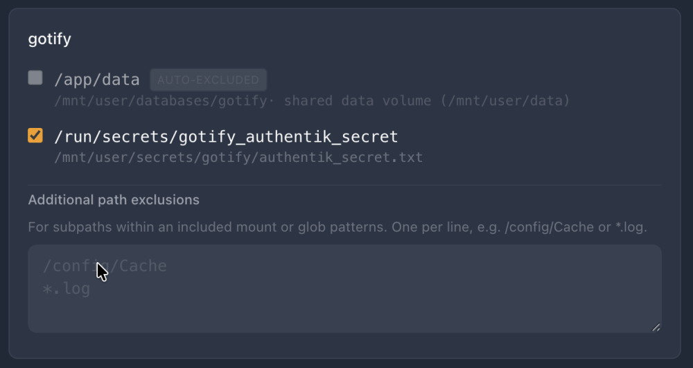

How to exclude container mapped folders other than /mnt/user/appdata/* ?
I have Alist with mounted folder with photo albums and I want exclude that from container backup.
EDIT: and add ignore "/var/run/docker.sock" mount (portainer/traefik) (end with error)
thank you.

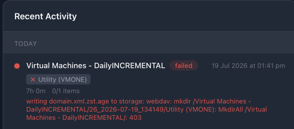

When setting up a backup job for VM's the incremental option is not working correctly. It still creates a full image on subsequent backups.
