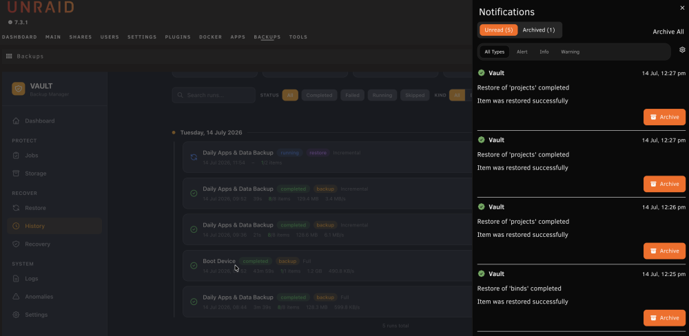

On 7/11/2026 at 1:12 PM, PanicMechanic007 said:
What’s the errors? Please share
Apologies for the delay in my response.
I cannot reproduce the error at this point, but it was caused by the incorrect reinstatement of the vault.db file. Since the update that introduced the "Recover Vault" wizard, this all worked perfectly. Thank you for making it so clear and easy going forward.
I must flag another couple potential bugs I've found while restoring a few folders:
  1. Vault is triggering multiple "restore complete" notifications for the same folder, some of which the restoration job is actually completed. I can provide diagnostics in private if necessary. Attaching a screenshot here.

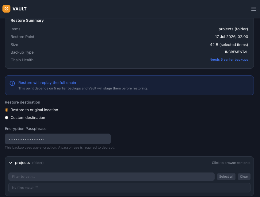

  1. Some (not all) of my restoration points are not allowing me to browse and restore specific files.
