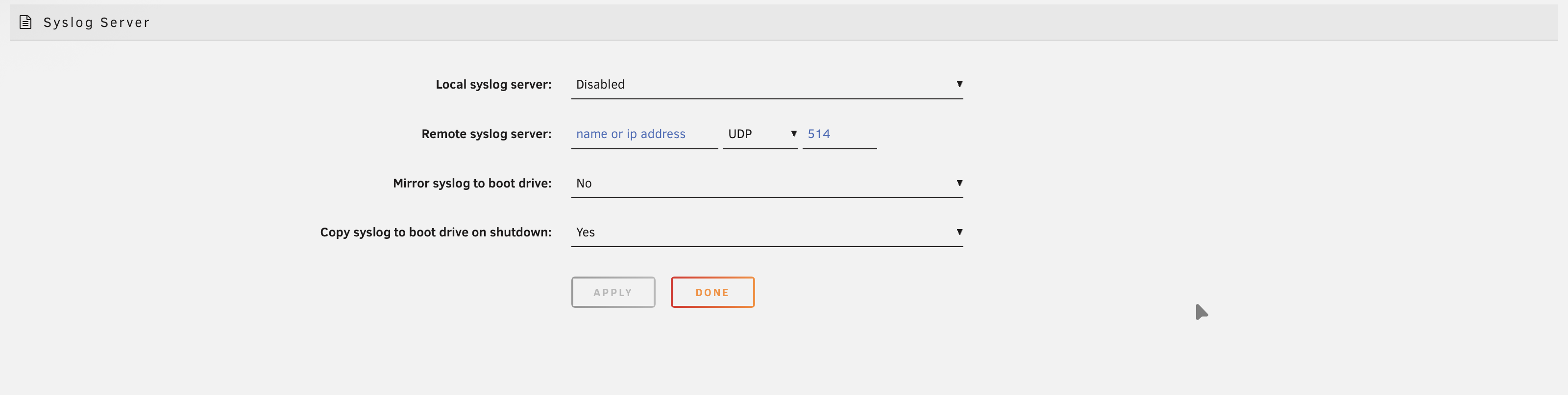

  12. Thank you! I have followed the instructions and set it up, after the Parity Check is done I’ll reboot the system and check if the log server works. Thank you :)
  13. Thank you for pointing that out, In fact the server wasn’t running at all: Screenshot is attached, If you could provide me with the settings that works best It would be greatly appreciated!

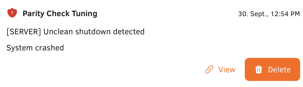

  14. Hello everyone, For quite some time I have encountered random shutdowns, unclean Shutdowns and crashes. Although I never put 1 and 1 together, in the early hours this morning it happened again and I do not have a solution to it or a cause for why it is happening. Attached is the text I was posting in a different thread but after feedback a new thread seemed to be the way to go. Diagnostics are attached. This morning I was wondering why my Server wasn’t showing up within my finder on mac, since is happens from time to time that finder throws it out, I wasn’t really concerned with it - After 3 Failed reconnects I was and If it wasn’t for them, after Plex hasn‘t shown any Libraries after starting it - I was. Quick trip to the GUI and I knew what happened: System Crashed, out of the Blue at roughly 12pm last night, right around midnight. I don’t know what happened or why it happened in the first place. I’ve attached the diagnostics but I’d really appreciate any tips or solutions to or for fixing it. Sick of these unclean Shutdowns for months now Cheers and Thanks in Advance Alex server-diagnostics-20260930-1345.zip
