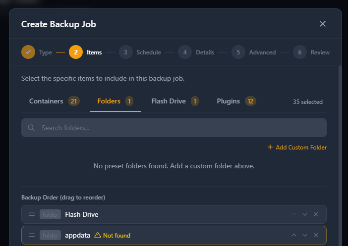

Since updating to Unraid 7.3, Volt Backup no longer seems able to back up folders correctly.
For example, the Unraid USB boot device is still detected properly and can be backed up without any issue. However, when I try to add my AppData folder, Volt Backup reports that the path does not exist.
The folder is still present and fully accessible directly from Unraid, so the path itself is valid.
Before upgrading to Unraid 7.3, everything was working correctly, including AppData backups.
At the moment, this is problematic because I mainly want to back up my AppData along with the rest of my system.
Could this be related to a change introduced in Unraid 7.3?
Maybe Volt Backup needs an update to support the new version?
Has anyone else experienced this issue?
Thanks!

On 5/15/2026 at 7:24 PM, iDrink said:
Thanks!
I'll look into it

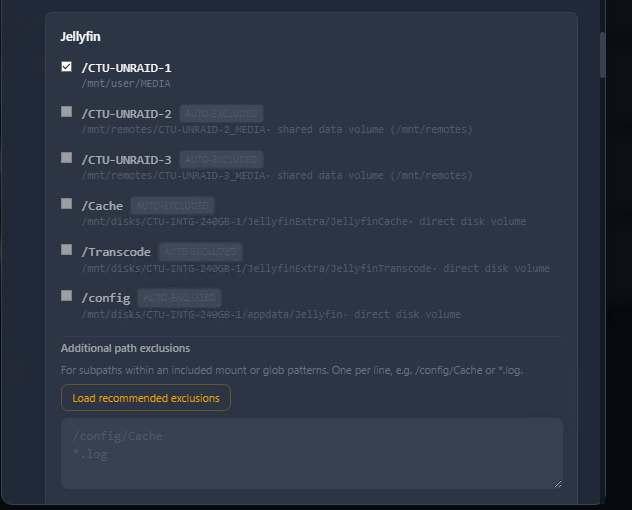

1 Small Question/Issue, it seems some of my Containers, the Tickbox to "Exclude?" is greyed out and shows as Auto Exclude, so this may be just me being stupid, is this a "put a Tick in the Box" if you want to backup that Path/Data or is this a "Tick the box" to Exclude the Data/Path from the Backup?
Also as above, some boxes cant be modified?
Image is 1 Example (bunch of others are similar).
I wish to keep "Config" but exclude "UNR1, UNR2, UNR3" as an example/
again, thanks for the Super awesome work! ;D
12 hours ago, Stan464 said:
Hey PanicMechanic! )
Just seen you have added the Easy Tickboxes which is fantastic, thanks!
Great question - and you're not being stupid at all, the wording is a bit ambiguous!
The tickbox means "back this up", not "exclude this". So:
- Ticked = that path/data is included in the backup
- Unticked = that path is left out
- Greyed-out + "Auto-excluded" = Vault skips it automatically (media shares, remote shares, etc.) because those are usually huge shared data you don't want in an appdata backup, so I lock them off.
For your example - to keep Config and drop UNR1/2/3 - UNR2 and UNR3 are already auto-excluded (they're /mnt/remotes shares), and you'd just untick UNR1.
One thing I've spotted from your screenshot: your Jellyfin /config lives on an Unassigned Devices disk (/mnt/disks/...). Vault is currently auto-excluding the whole /mnt/disks/ family as "direct disk", which is wrong - appdata on an Unassigned Devices SSD should absolutely be backable. That's a bug on my side, not you. I'll get it fixed so that box is tickable.
In the meantime, you can still protect that config by adding /mnt/disks/CTU-INTG-240GB-1/appdata/Jellyfin as a Folder backup - that path isn't auto-restricted, so it'll back up fine.

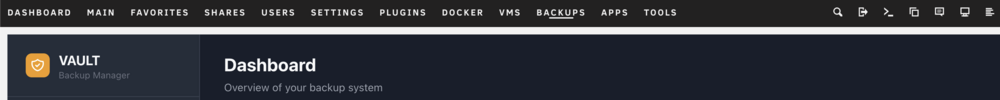

I created an addon plugin that shows a Backups button in the top bar for fast access.
Edited by Bradley Hayes
ADD IMAGE

Using this now as we speak! very handy, thanks!

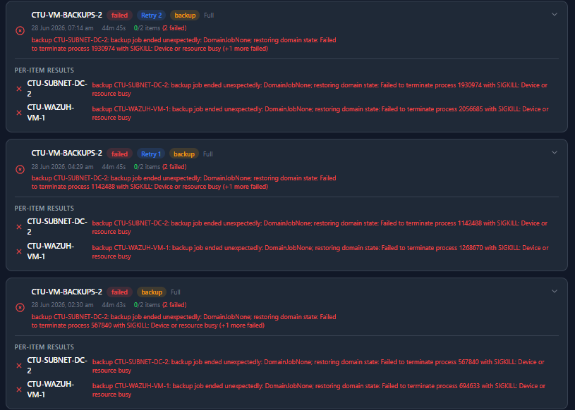

Hey PanicMechanic! hope you are well. See updates along the way are nailing the issues / adding improvements.
Small Q. seems no matter what I try here, Cold, Live, etc seems the VM Backups are failing with the same error very time.
Any clues to why?
Any clues to why?
Hello @Stan464
Are these Windows or Linux VM's?,
how many disks attached to the vms?,
How many Nics?,
Are they big or small vms?
Are the disks raw or qcow format?
Do you have the VM Guest agent running on them?
Edited by PanicMechanic007
12 hours ago, PanicMechanic007 said:
Hello @Stan464
Are these Windows or Linux VM's? = 1 is Windows and the other is Centos.
how many disks attached to the vms?, = 1 Per VM (it was originally 2 vDisks on the Windows VM but removed it for testing)
How many Nics?, = 1 per VM. (Bridged)
Are they big or small vms? = Small to Medium (Both roughly 60GB per VM)
Are the disks raw or qcow format? Raw Disks = Windows VM is Qcow2 and the Centos VM is Raw.
Do you have the VM Guest agent running on them? It is running on Both, yes! )
Have attached a somewhat long ass text file but its a full breakdown of the 2 VM's! again, awesome work on this tool and I appreciate the assist! <3
vm_backup_info.txt
On 6/29/2026 at 8:57 PM, Stan464 said:
@Stan464 Should be fixed now in latest version. I have tested on 2 vms and working fine. Just make sure you convert raw disks to qcow2 format.
