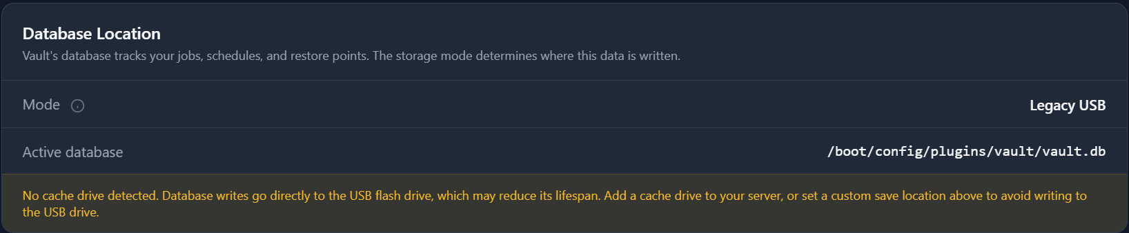

  2. Hi... I just updated to the newest version of vault and it looks like im unable to change the database location off of my flash drive.... It is also unable to recognize my cache pool
  3. Sorry, just saw above... Looks like im good to go

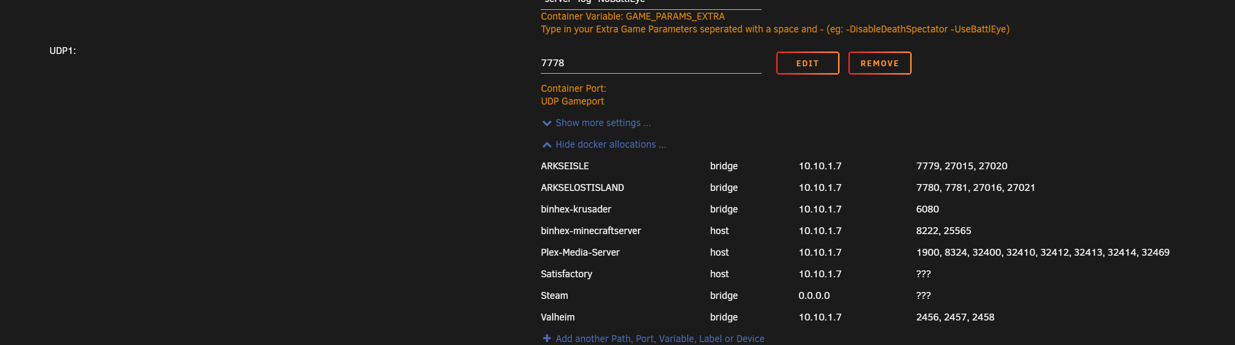

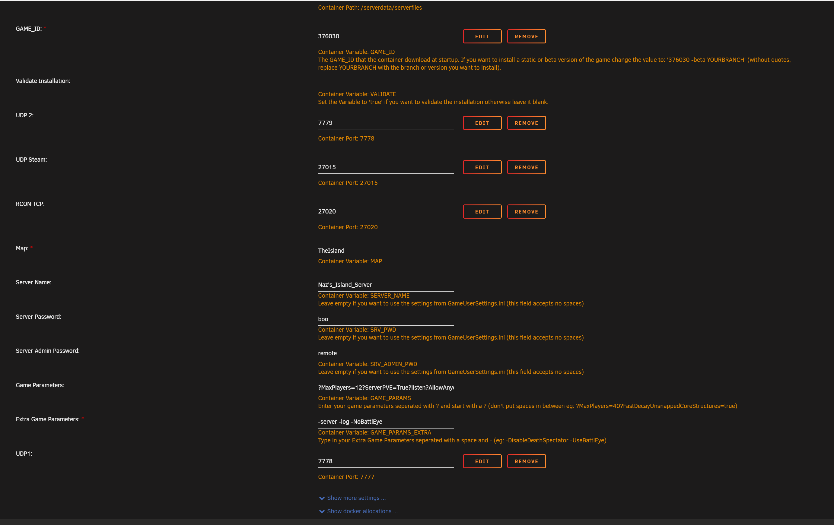

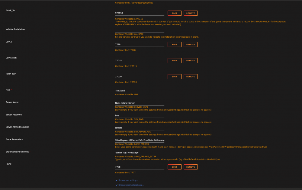

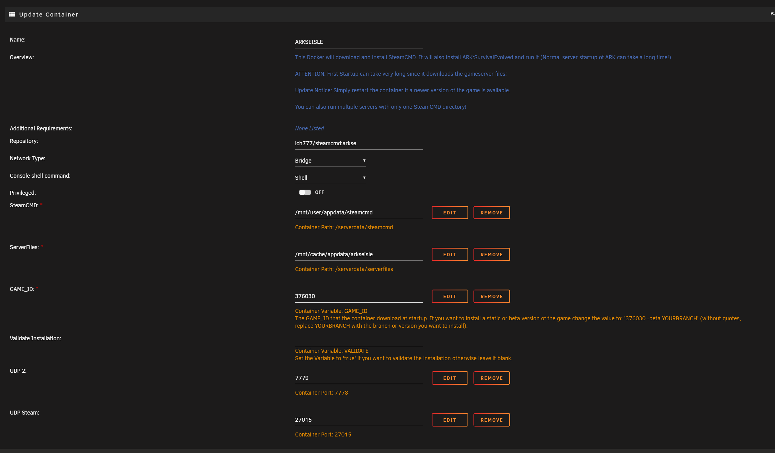

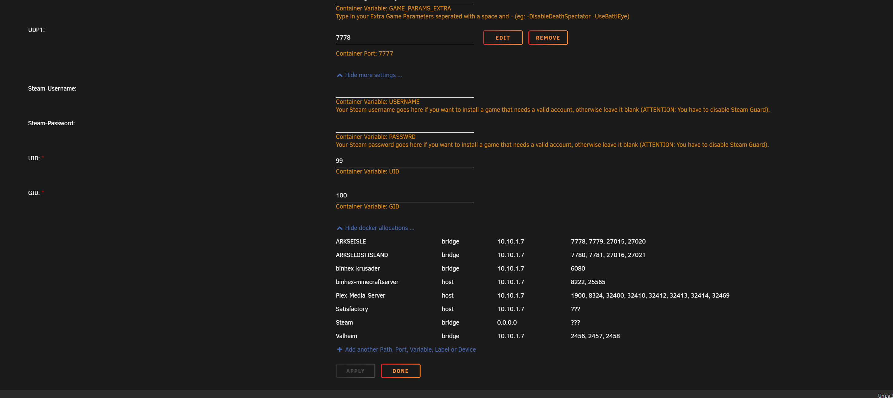

  7. The reason im changing the ark ports is because I heard that Satisfactory will only accept 7777 as their first port. Not sure how true this is but anyway, If i can get the ark stuff figured out then i can add more ark servers. I basically need ArkIsland to have a port of 7778, 7779 I need the next ark (ARKLOSTISLE) to use: 7780, 7781
  8. Ok. By adding new ports and changing the container ports to what i wanted that seem to work for one of my ark servers
  9. I got it looking better i think
  10. I did just find a typo in the query port under game parameters
  11. I did port forward the port range in my router
  12. Its not recognizing the 7778 port for ARKSEISLE
  13. Nazrai started following ich777

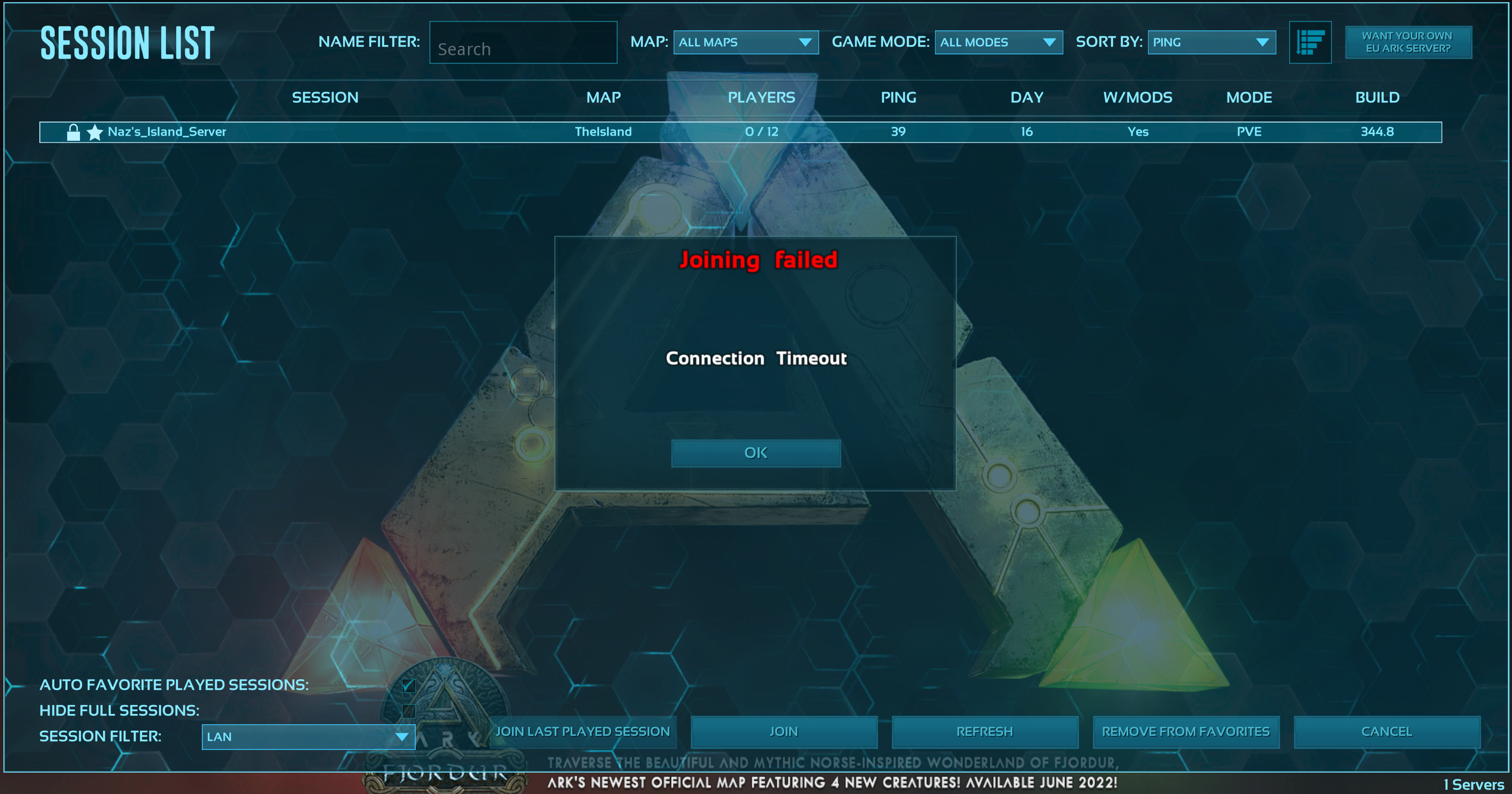

  14. Hey Ich!! Another question. I needed to change my port in Ark so it doesnt conflict with satisfactory but now It is showing with the incorrect name in the server list and wont let me connect. I have a feeling that I'm using the wrong parameters for th edefault port.....Could you help me out? What info do you need?
  15. I believe maybe my satisfactory game uses that port.
