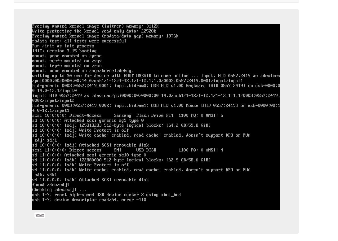

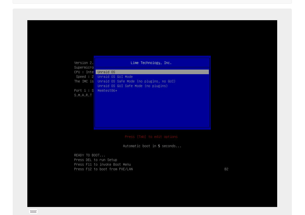

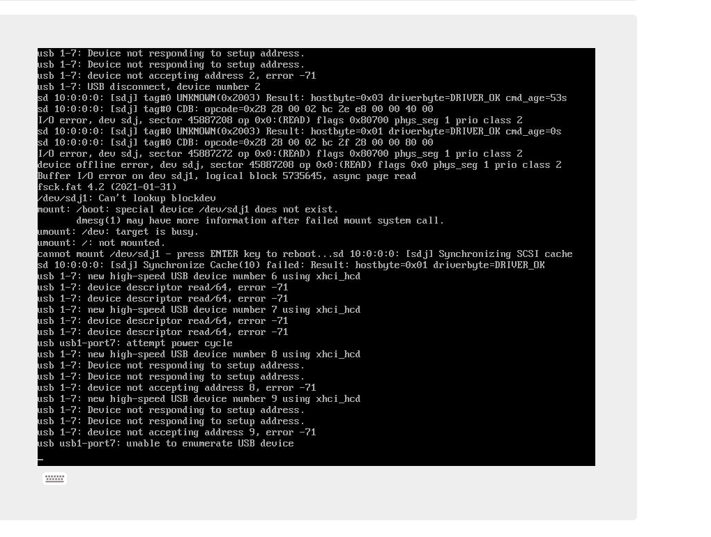

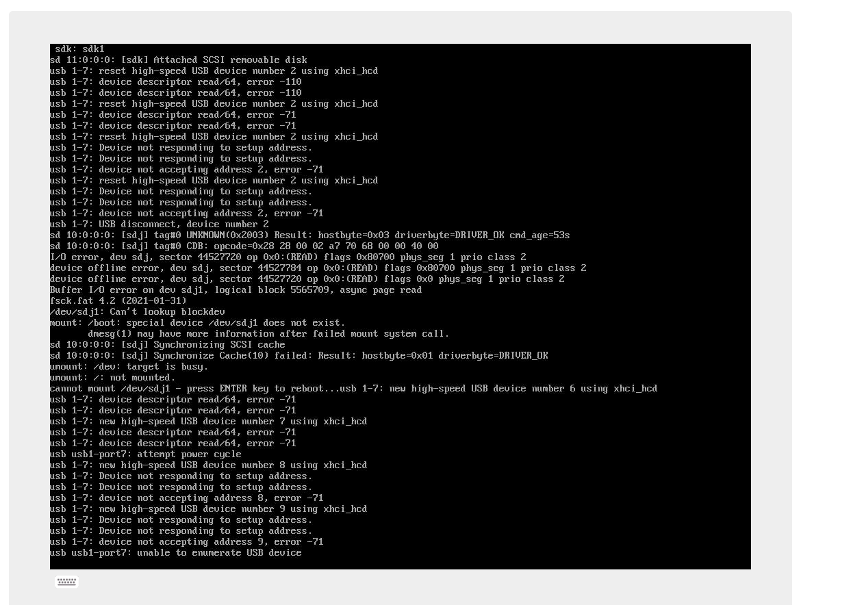

  1. In the last couple reboots I did i have not able to boot back up, it fails see picture (boot2.png, boot4.png). It passes the unraid blue screen (boot1.png) but it fails to mount /boot ?!, Even if i reboot again still stay at screen (boot3.png) The fix was to unplug the usb drive and plug in back in and it booted normally, but right now it doesn't boot , it shows the same errors. I tried on current server to boot and reboot other usb drive with unraid and it boots fine. I tried to put the problem usb drive it in other server and it boot fine. I plug in the problem usb drive in my computer and it shows fine all the files and no errors detected. Is the usb drive failing ? Should i replace it ? Please let me know what diagnostics i can provide.

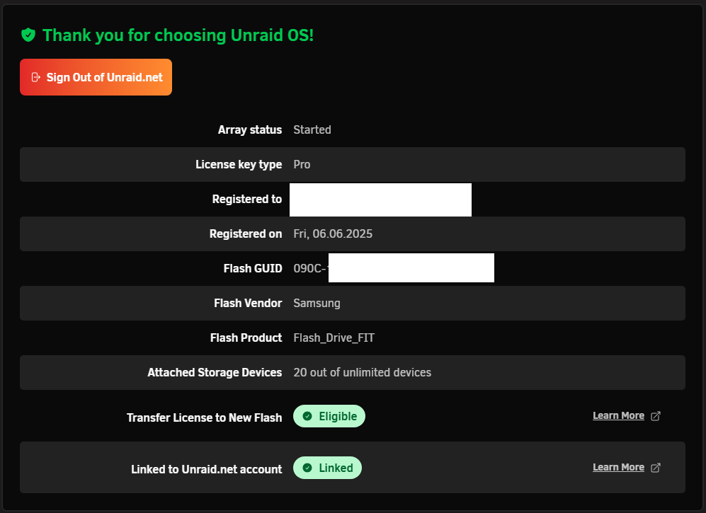

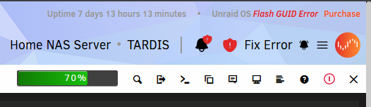

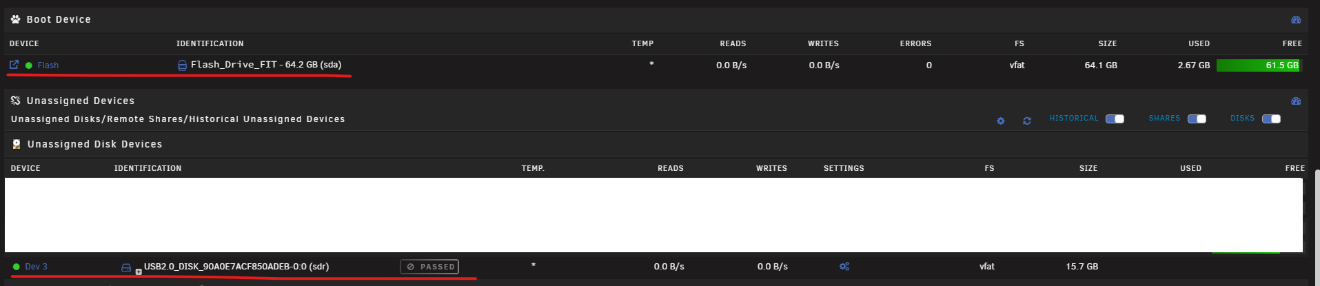

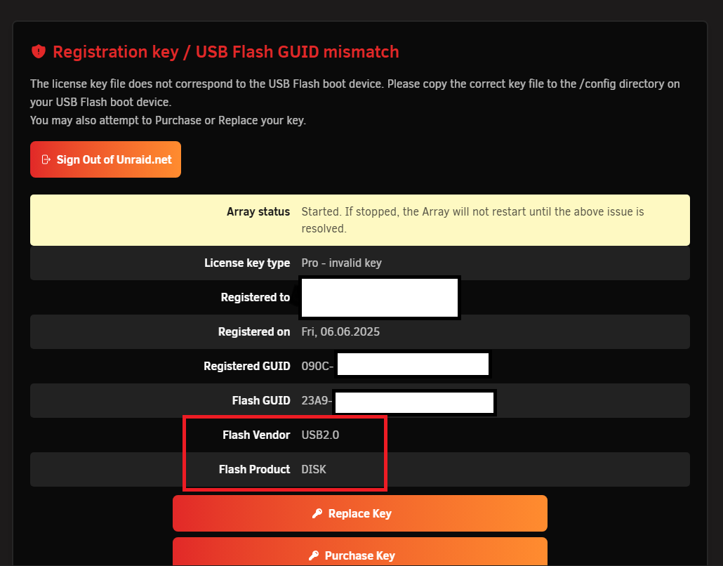

  4. I wanted to setup a second unraid instance into a virtual machine on my unraid server. I plugged the usb drive and left it planning to setup later remotely. After some hours i logged into the server and i was greeted by this message: I'm still on unraid 7.1.1 and avoided upgrading due the docker network and other issues that where on next versions Here when i have both plugged in It seems is taking the wrong usb (the usb 2.0 is the new one inserted) and the correct one is the Samsung Fit I just plugged in no reboot, no stopping / starting the array. tardis-diagnostics-20251008-0917.zip
