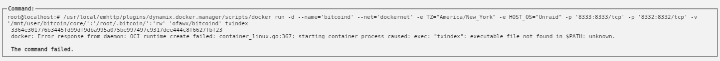

  2. The bitcoind container fails to start with the default settings in the template. Something to do with the txindex parameter. Attempting to starting the container throws this error in the Unraid GUI. The container will start if "-txindex" is removed from the Post Arguments in the template.
