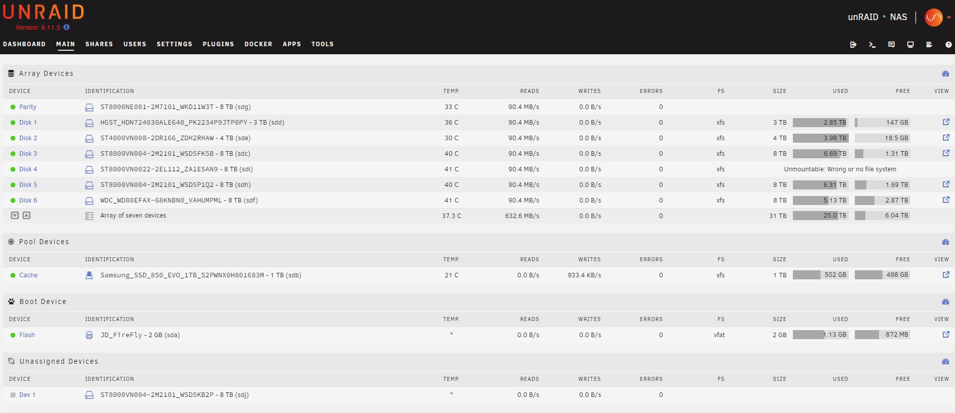

  3. I am having some trouble with my array... I have a few older 8TB drives... It looks like one has failed, however when I change it over to another disk the interface wont let me choose the spare drive!? I can reboot, and the drive is then able to be selected... Parity attempts to rebuild, but the GUI says 'Unmountable: Wrong or no file system' Any ideas what I might be doing wrong? Thanks in advance
