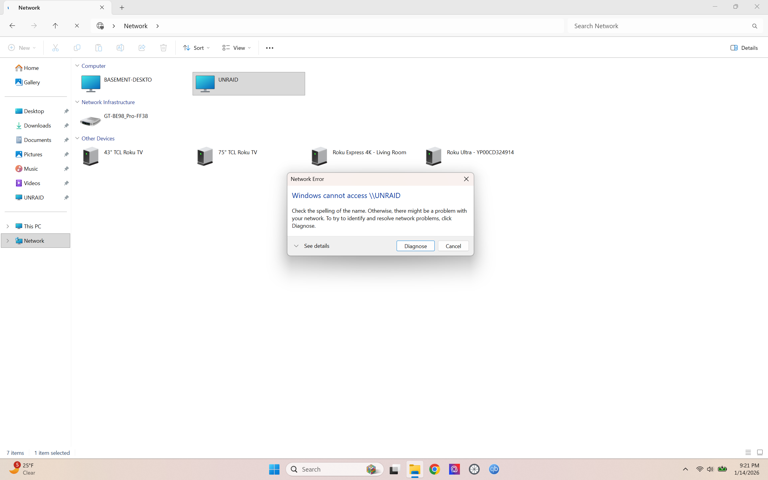

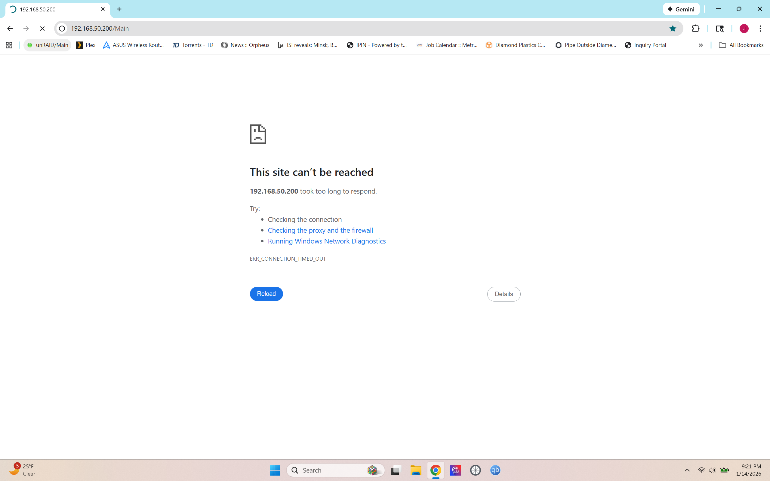

I figured it out, Thank you for the help. Discovered this evening while looking over my router that it for some reason changed the IP address of the unraid server. Didn't even think to look at that because it's been setup to the same IP and binded to the MAC address for 6 years now. Anyways, Changed the IP address and now everything is working correctly.

My server does not have a graphics card. I did do a reboot by holding the power button down a few days ago, Didn't realize you could do a quick push. Anyways, It rebooted and did the parity check, Still don't have access as seen in the photos.

Been a week or so since I have logged into Unraid from my Window UI. I can no longer access the UI or the unraid share in my network folder as seen in the attached. I have not changed anything, I know the server is still working because Plex is still letting me watch my content on my TV's. Anyone have a suggestion on what is going on here?

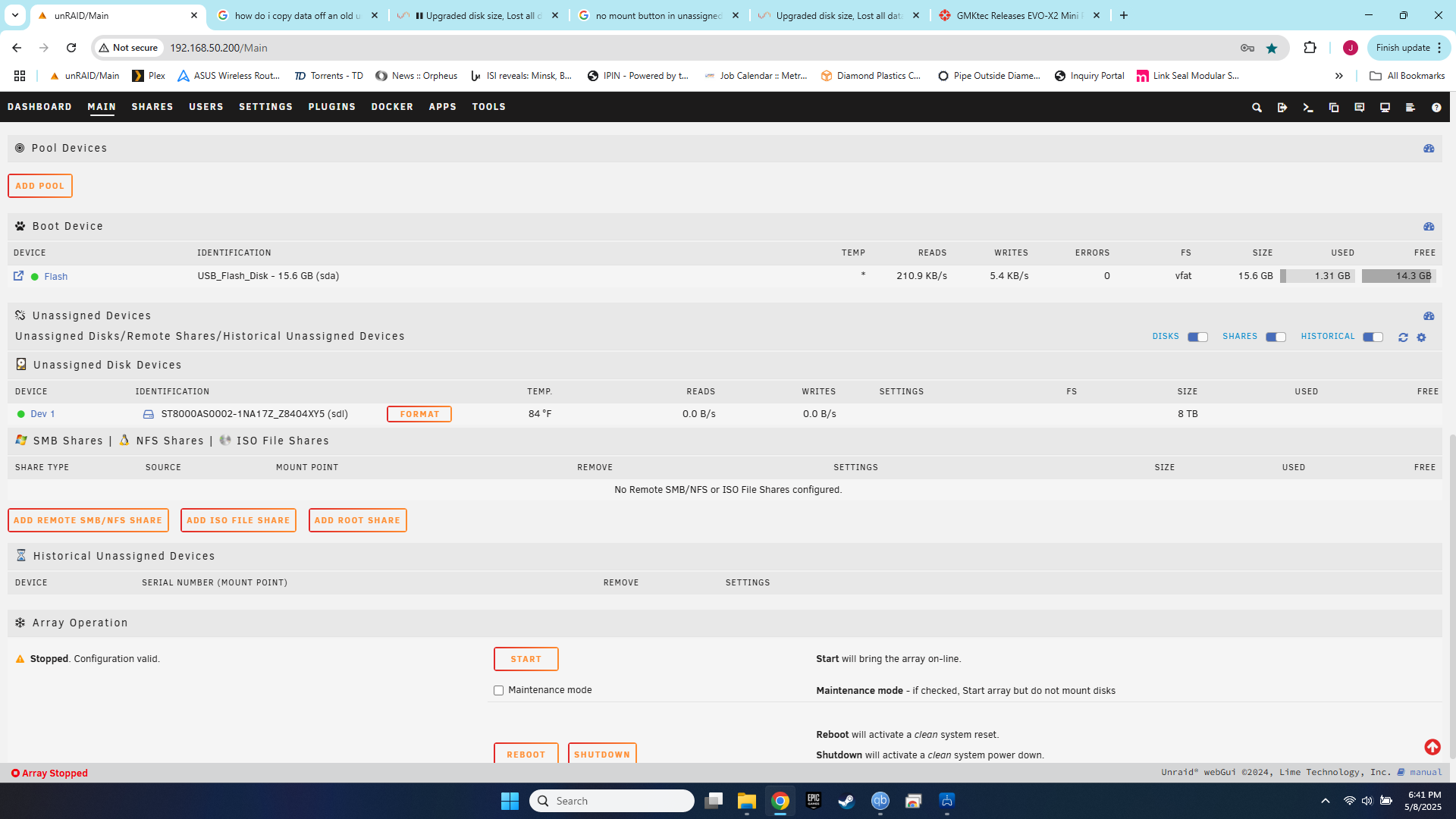

Sweet! That worked, Mount button showed up and I'm moving over my files to the new disk 1. Thank you sir, You are awesome!!!!!

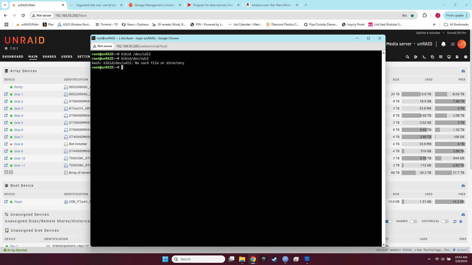

It is the original removed disk, Only one I have. Here is the output: root@unRAID:~# sfdisk /dev/sdl The backup GPT table is not on the end of the device. This problem will be corrected by write. Welcome to sfdisk (util-linux 2.40.2). Changes will remain in memory only, until you decide to write them. Be careful before using the write command. Checking that no-one is using this disk right now ... OK Disk /dev/sdl: 7.28 TiB, 8001563222016 bytes, 15628053168 sectors Disk model: ST8000AS0002-1NA Units: sectors of 1 * 512 = 512 bytes Sector size (logical/physical): 512 bytes / 4096 bytes I/O size (minimum/optimal): 4096 bytes / 4096 bytes Disklabel type: gpt Disk identifier: 827D75C3-80C0-4EF1-A643-7E359FA9EA49 Old situation: Type 'help' to get more information. >>> 64 Created a new GPT disklabel (GUID: 11318B0B-FEF3-4AB5-8524-8DE26601AEA3). Sector 64 already used. Failed to add #1 partition: Numerical result out of range /dev/sdl1: ^C root@unRAID:~# I used Diskinternals Linux Reader for Windows when I hooked the drive up via USB to my computer earlier this week. All the files showed up on there. However, That program is only meant to see the drive/data and nothing more. Not sure if there is some way to get Windows to read the drive so I can copy and move the data over to a Windows PC. Tried doing some research on google but some of the stuff doesn't make sense to me.

Here is what it says: root@unRAID:~# fdisk -l /dev/sdl The backup GPT table is not on the end of the device. Disk /dev/sdl: 7.28 TiB, 8001563222016 bytes, 15628053168 sectors Disk model: ST8000AS0002-1NA Units: sectors of 1 * 512 = 512 bytes Sector size (logical/physical): 512 bytes / 4096 bytes I/O size (minimum/optimal): 4096 bytes / 4096 bytes Disklabel type: gpt Disk identifier: 827D75C3-80C0-4EF1-A643-7E359FA9EA49

When I did it the the space and hit enter, All it did was give me a new unraid prompt. I thought the space maybe was not needed so tried it that way as well. It is.

I'm not sure what I'm supposed to do here. Is this something that gets ran in the command prompt?

It was, It was my main disk that held my dockers and app data folder. Everythng worked fine, When I installed the new drive and re-started the system for the disk rebuild on the new disk is when everything went screwy. I did read about hooking up a hard disk to Windows via USB and using a reiserfs reader. The data and everything I'm looking for is on the drive when looking at it on Windows. I just have no idea how to get it off the drive. I've tried rebooting the server, re-installed the UD app, etc. I still only get this. unraid-diagnostics-20250508-2020.zip

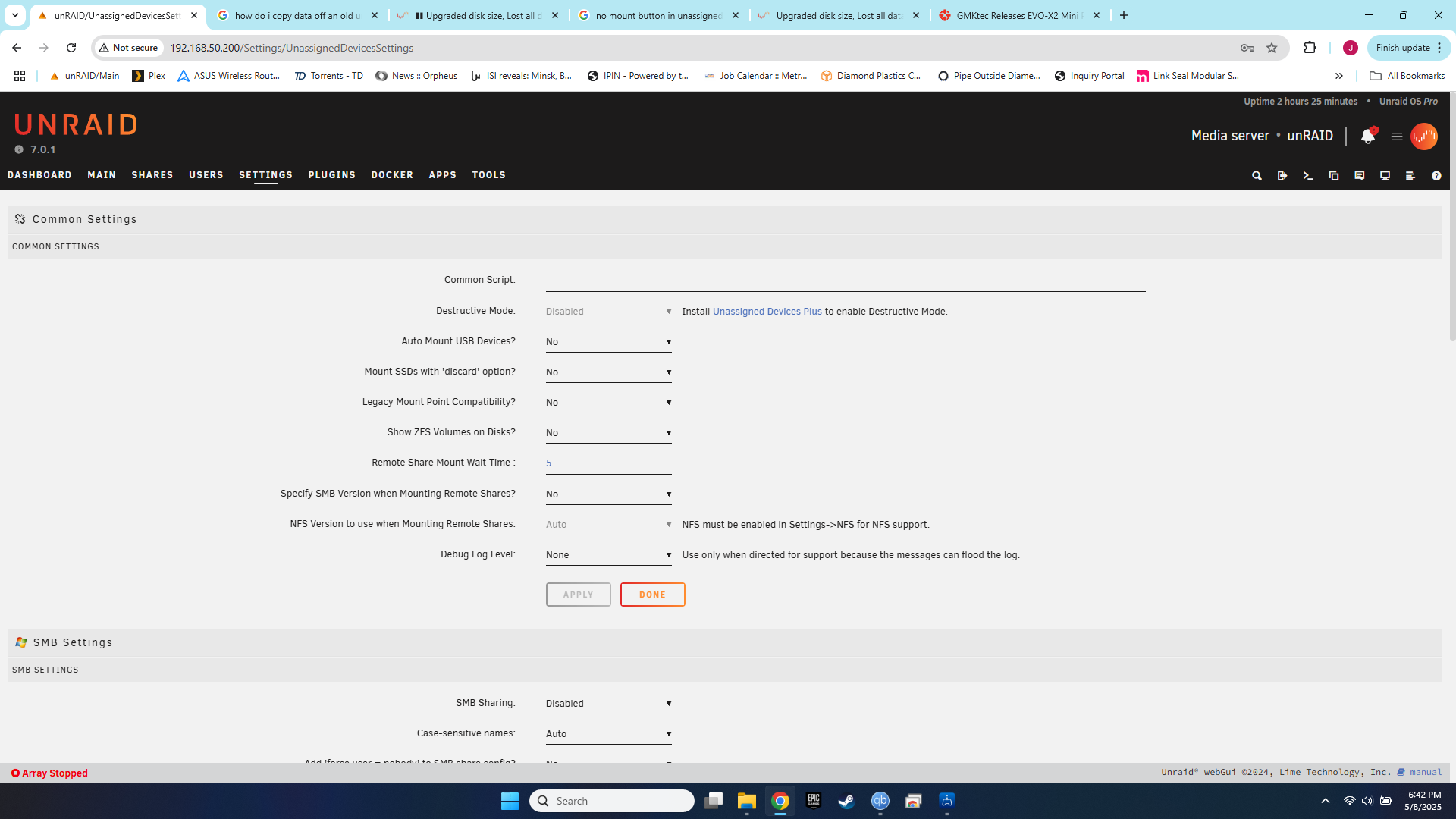

So got everything setup/changed over copied etc. with the drives on the server. Now I'm left with drive 1 that was removed and replaced that the rebuild deleted all my data because of the file system. As I said before the original disk 1 is intact. I installed unassinged devices plugin, The drive shows up but I can't figure out how to mount it. There is not button and looking online it says something about mounting the unassigned disk in settings, I don't see anything in the unassinged disk settings to mount this drive to transfer over the old data. Can you help with that or should I post in another forum?- Upgraded disk size, Lost all data after disk rebuild
