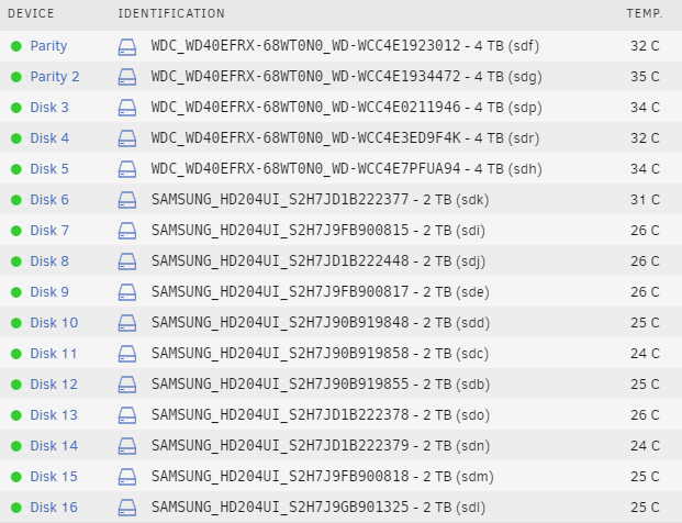

  5. I have a Fractal Design Define 7 XL with 16 drives (including 2 parity) and 3 cache SSDs. Temps in the mid 30's typically for the drives at the top (heat rises!) - I'm in Australia and the ambient is usually quite high. The following screenshot was taken around 1% into a parity check and it's around 24C inside my office. I'm running a pretty low powered machine - AMD Ryzen 3 3200G with onboard graphics (no discrete GPU). I have three 14cm fans mounted at the front of the case and a 12cm fan mounted at the rear. My goal for the build was to minimise noise - this machine sits in my office next to my desk, so I didn't want something that would add to the noise already in the room. I'm very happy with the build. I also have an old Antec 1200 case running a 20 drive array in 4 rows of 5-in-3 hot swap drive bays - cooled only by the 92mm fans mounted on the back of each drive bay and the 120mm on the top. Unsurpsingly, given how densly the drives are packed in - the drive temperatures on this machine are much higher than then Define 7 XL (frequently reaching 46-47C under load). If this older server starts to have hardware issues - I think I'll rebuild it in another Define 7 XL. It will be annoying having to drop down from 20 drives to 16, and it's a lot more work swapping drives in the Define 7 XL than it is with the hot swap drive bays - but the improved cooling, and more importantly, quietness of the Define 7 XL is going to improve things overall I feel.
