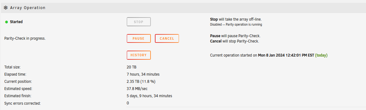

  3. I upgraded to Unraid 7 from 6.(something, I always install the offered updates). Then ran parity check to prepare to replace one of the drives with a new one. The new drive was mounted as unassigned device. Usually parity checks never report errors. This time it found 5 errors. After a day when it reached about 70% the time left shown switched from a few hours to 60 days, the speed was very slow and the amount of reads for the disks were displayed as 4 digits and 3 dots. I was able to hover over the read amounts and saw them change to full numbers in the display. I have never before seen this weird behavior. I tried to stop the parity check, but no response. After a while I got scared for my disks and shut down the server. When I rebooted I tried another parity check. It found the 5 errors and made it all the way through. I started another parity check to make sure those 5 errors were really gone. That check found errors again, and then just froze. I was not able to stop it, restart the server, nothing. I pressed the off button once to get a controlled shut down, but nothing happened. I had to hold the off button to shut the poor machine off. I unplugged my unassigned new disk to make sure it wasn't causing the weird behavior. When the server restarted, the parity check started as well, but I was able to stop it. I waited a while, and then started parity check again. It again found some errors, even though it should have fixed those in the prior check. This was very weird, and I thought maybe there is something on my old hardware (motherboard from 2012) which does not work with Unraid 7. Rolled back OS to 6.something (the rollback process chose the version), and started the parity check again. It found 2 errors which it corrected. To make sure the parity is really clean now I started another parity check in non-corrective mode. Server log says it installed the plugins etc at reboot, and had error messages complaining about running a too low OS 6 version, and about not running OS version 7, then the clock became unsynchronized, and the system rebooted itself. It auto-started the parity check again, but with correction switched on. After seeing all this stuff in the syslog I gave up, took one last diagnostics, and shut the system down. Those last diagnostics are attached. If needed I can upload more diagnostics: I took several during those failed parity tests Hardware: ASUS P8Z68 with Intel i7 processor 6 port ASM166 SATA controller Drives: Parity: 2 Seagate Exos 20TB 7 Data disks: 2 Seagate Barracuda Pro 8TB 2 Seagate Exos 8TB 1 WD Black 8TB 1 Seagate Ironwolf 10TB Thank you for reading this. Any suggestions on how to proceed are greatly appreciated muellkippe-diagnostics-20250227-1516.zip

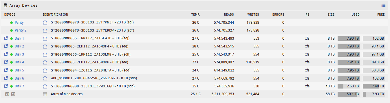

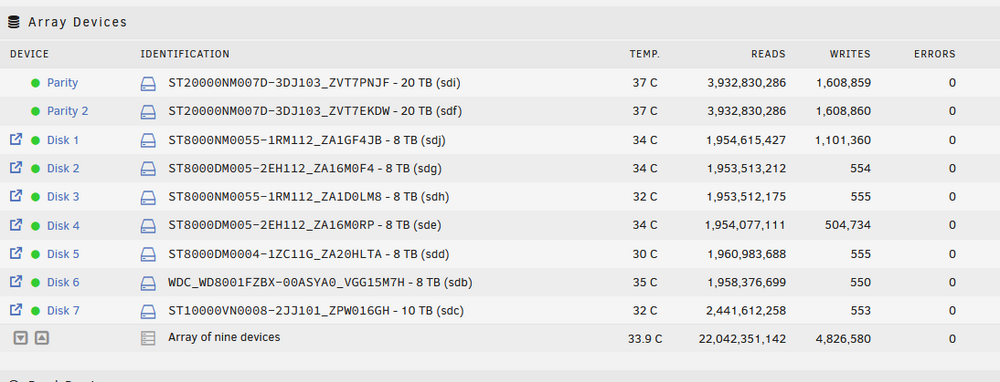

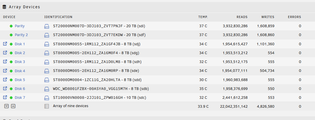

  4. Here is the promised update during higher ambient temperature: Hard drive temps during Parity Check today after 1 day and 5 hours of checking. .Ambient temp in room where server is located: 77 Fahrenheit / 25 Celsius. The ambient temperature in my place won't get higher than today's 77F before air conditioning kicks in. The highest hard drive temp is just 12C over ambient for a hard drive that has been reading/writing parity for over a day.

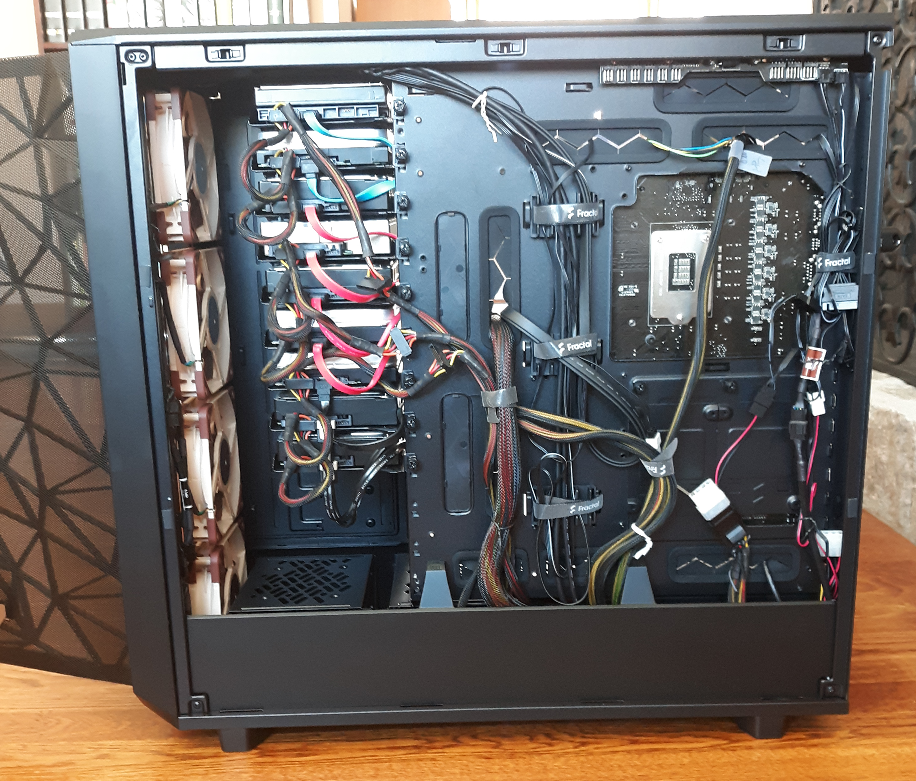

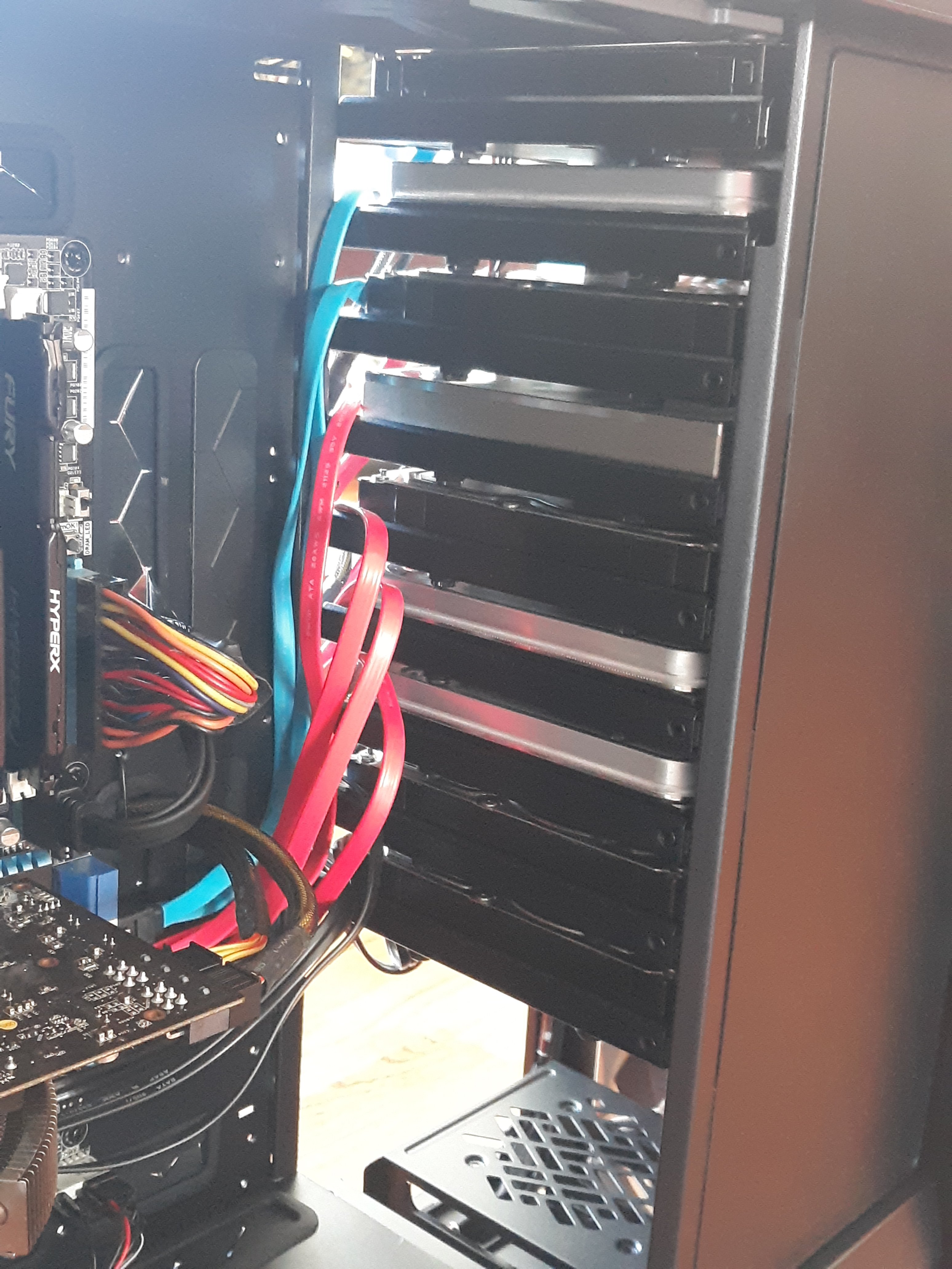

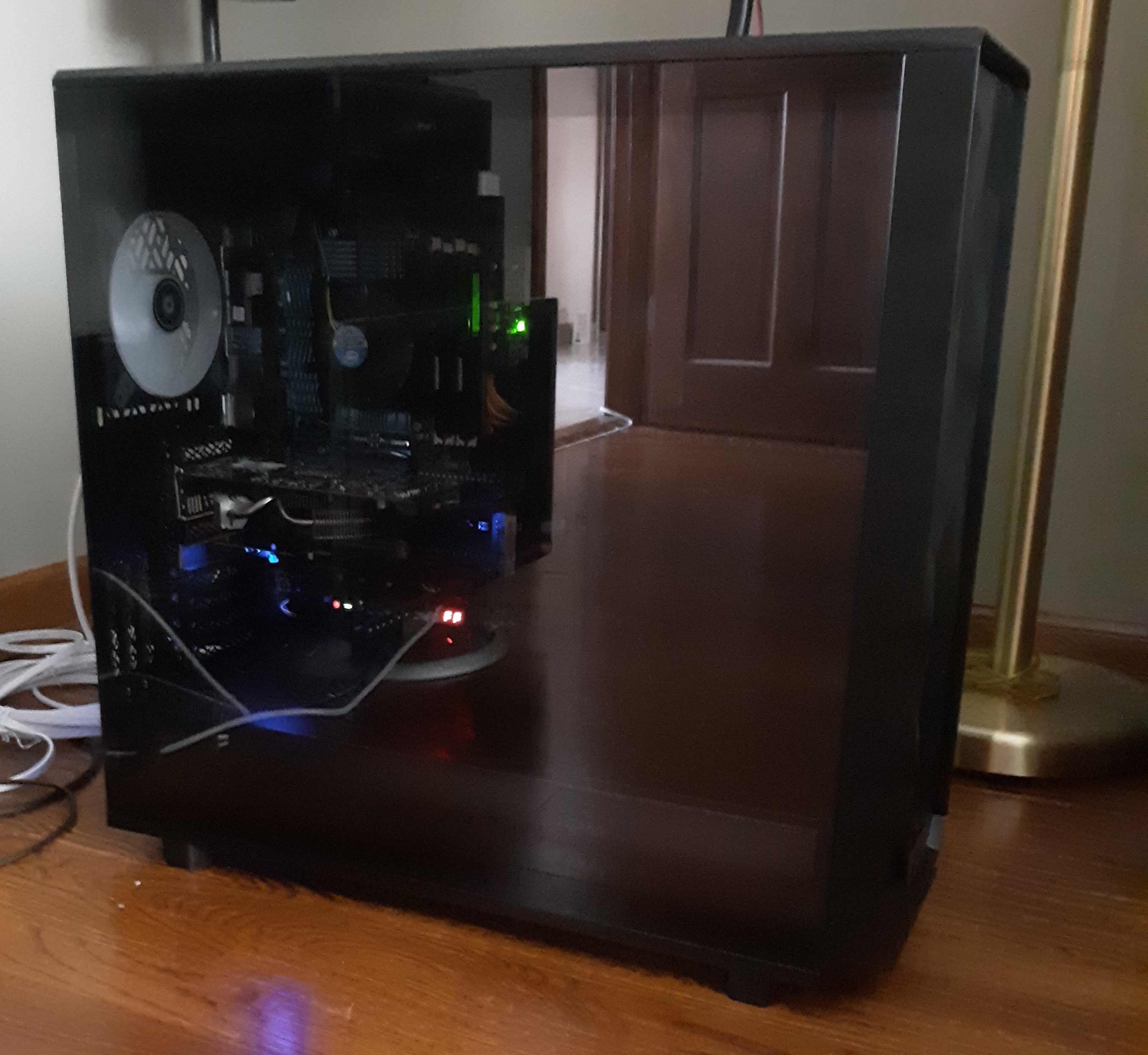

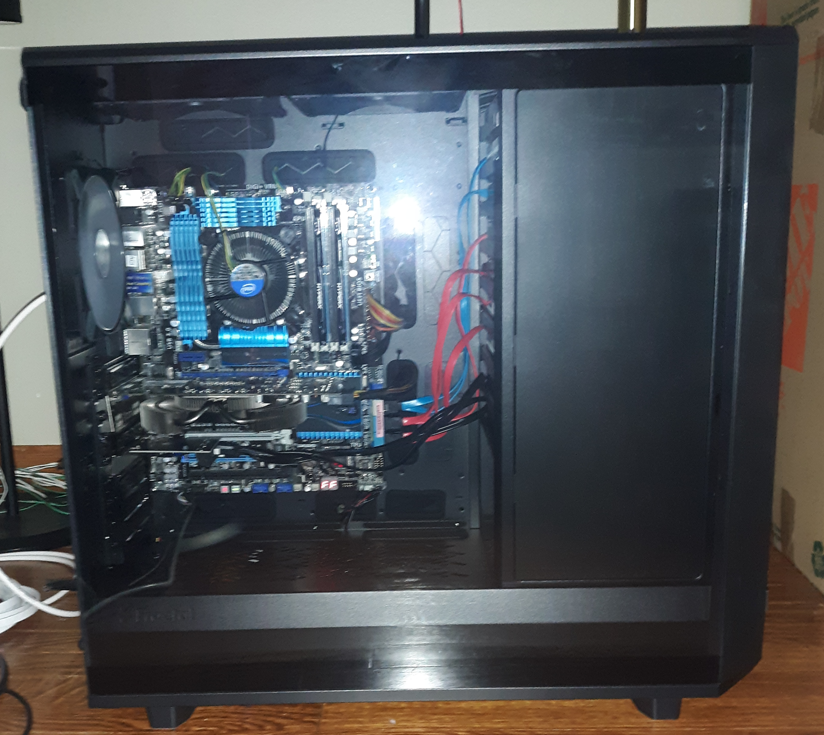

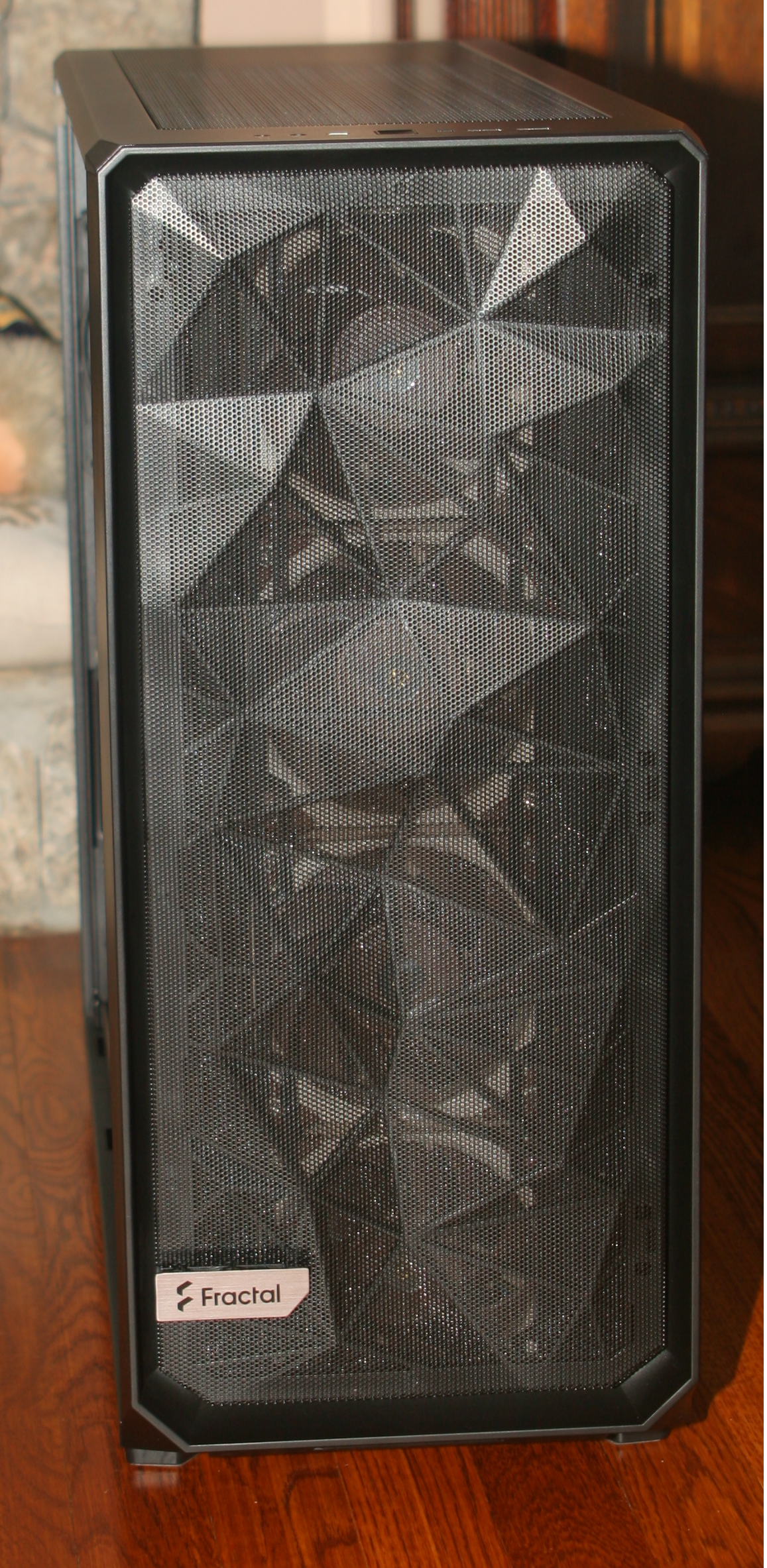

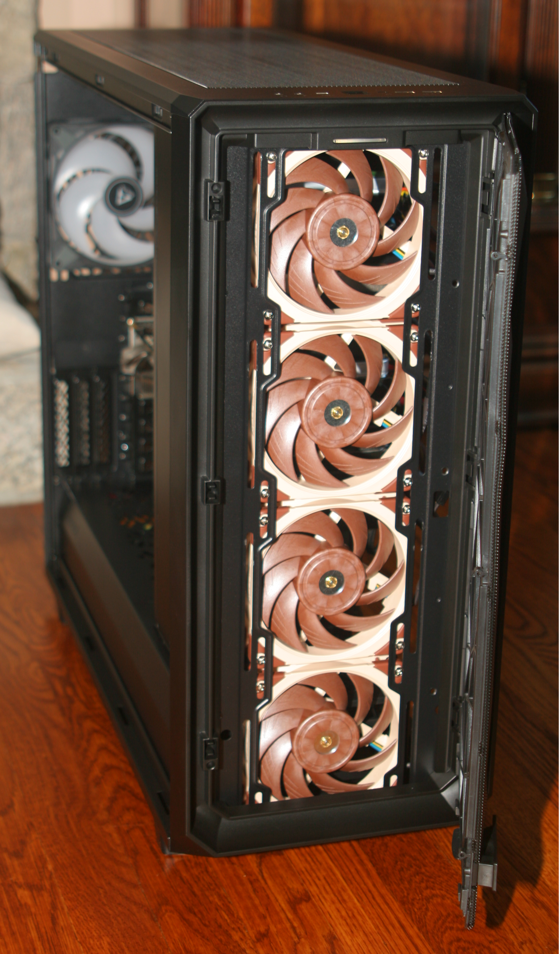

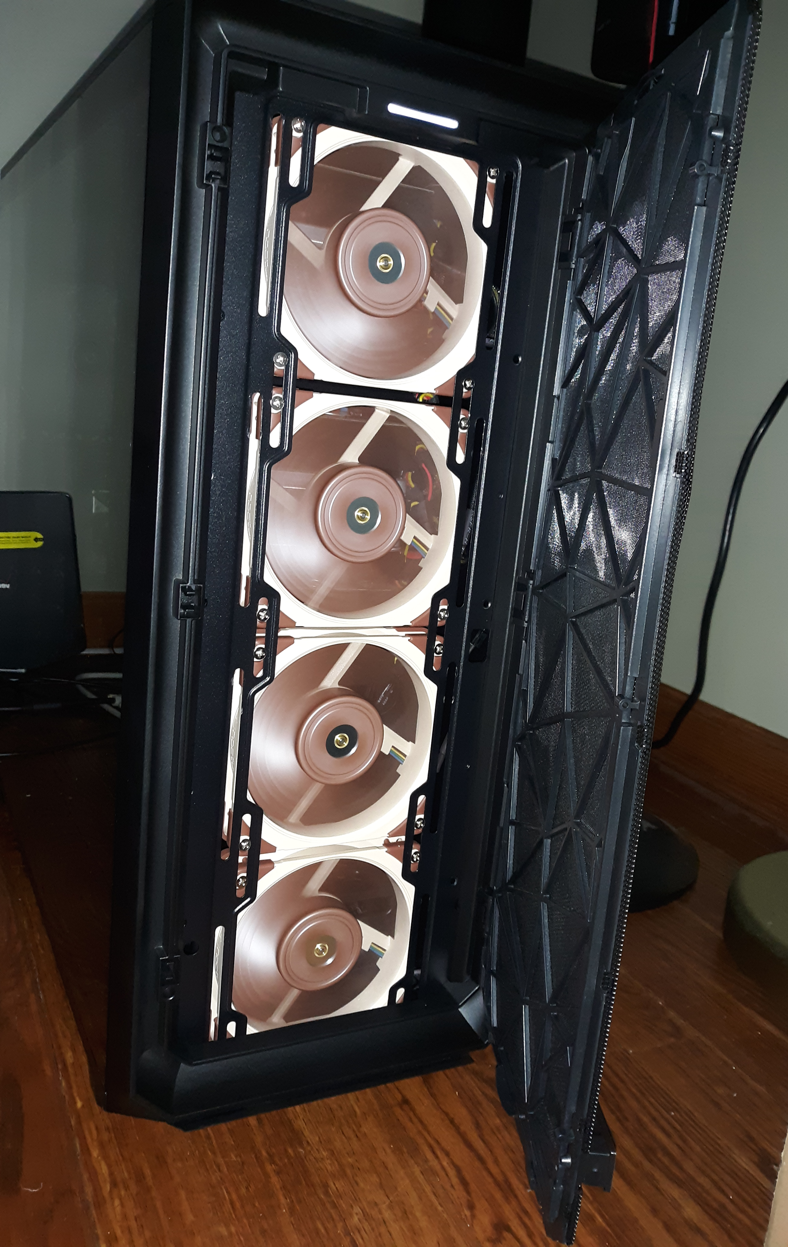

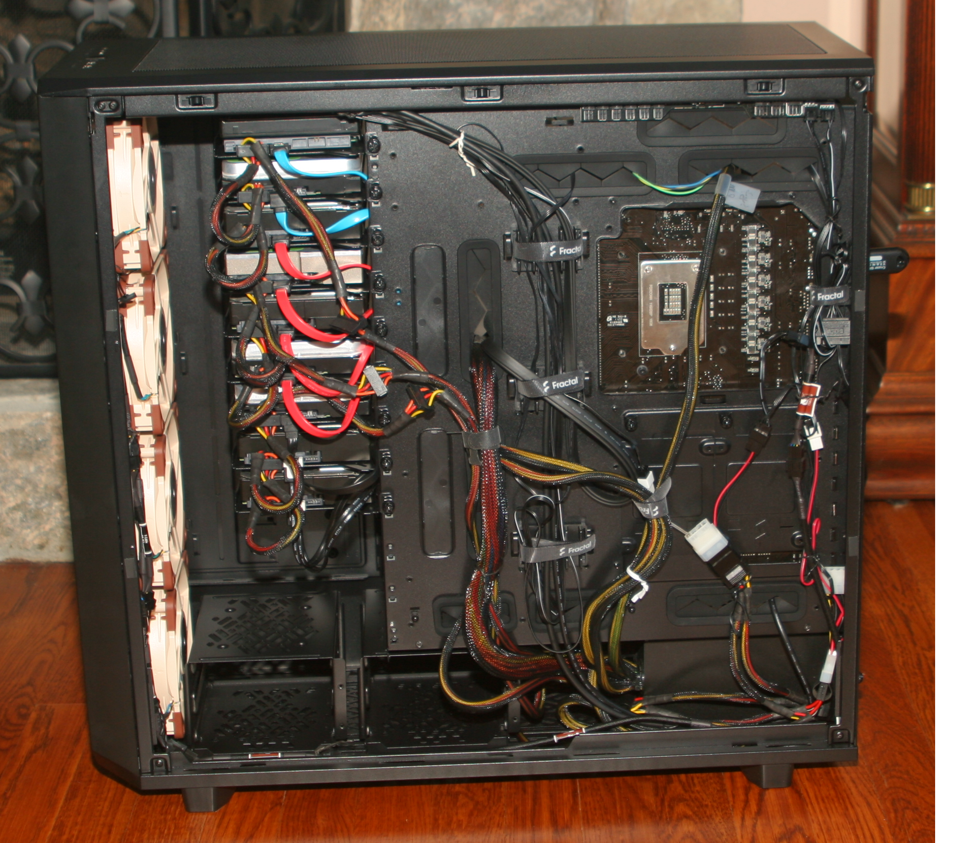

  5. I bought a Fractal Meshify 2 XL, transferred my existing hardware into it, and added 2 new parity drives. The build was straight forward, case is very easy to work with. I put the case fans it came with on the top, added 4 120mm Noctua NF-A12x25 PWM fans in the front, and an existing 140mm Arctic fan in the back. The front fans are configured for intake, the back fan and the top fans are configured for exhaust. The hard drives are all mounted from the top with no space in between, directly behind the front fans. The case has dust filters on the top, the front, and the bottom for easy dust maintenance. Cable management is easy: cables can all be routed behind the motherboard, with cable straps provided, and a panel to hide the biggest mess at the bottom. The bottom area has 2 hard drive cages in case you run out of space to mount the hard drives top to bottom. I have now 9 drives in there and there is still room for 3 more before before starting to use the hard drive cages. Now in winter with around 62F ambient temperature in the room the server is in the Noctua fans I put in the front are running on their low-noise-adapter (voltage throttler) at 1700 RPM, and the server runs quietly. Based on how the temps are in the summer, I most likely will need to run the fans at their full 2000 RPM speed since ambient temps here get to around 79 F. I am running parity check since 7.5h, and the temps are staying within 20s C. This case is well built, and offers room for 16 hard drives on the front: 12 mounted from top to bottom right behind the front fans, plus 4 in the hard drive cages on the bottom. If you need to you can probably squeeze more room for hard drives out of the case. Youtube has videos where folks do that. I found I can easily check the 7 segment bios error display through the case's glass door just by peeking into the room the server is in. You see exactly the stages the server goes through when booting without having to open the case. That has helped with troubleshooting. The glass door also gives the server a neat put-together look. Here are some pics of the server, plus the temps 7.5h into the Parity check. Thank you everybody who has posted insights and pics. Your work is much appreciated! I'll post update in summer when the ambient temperature is higher.

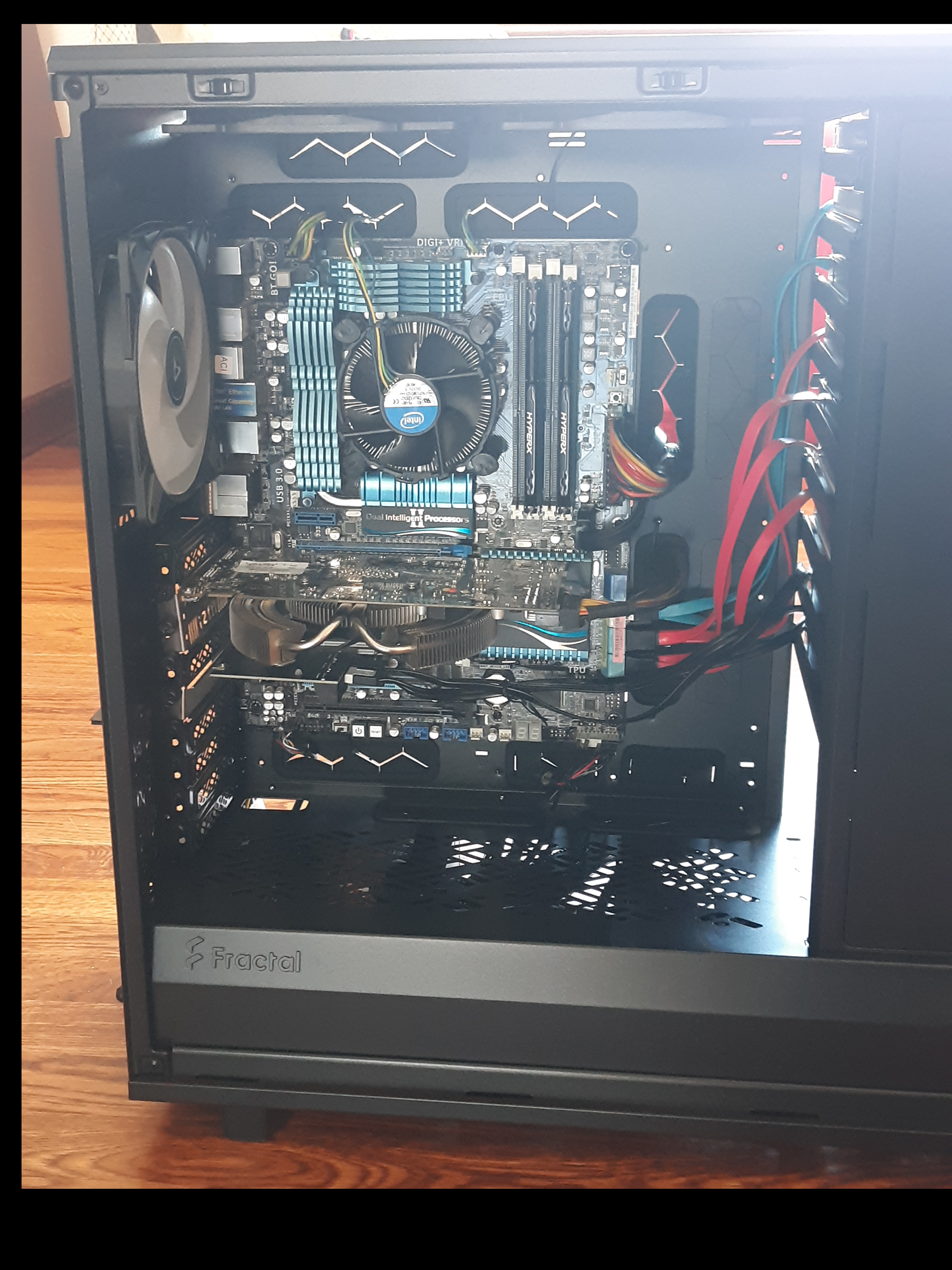

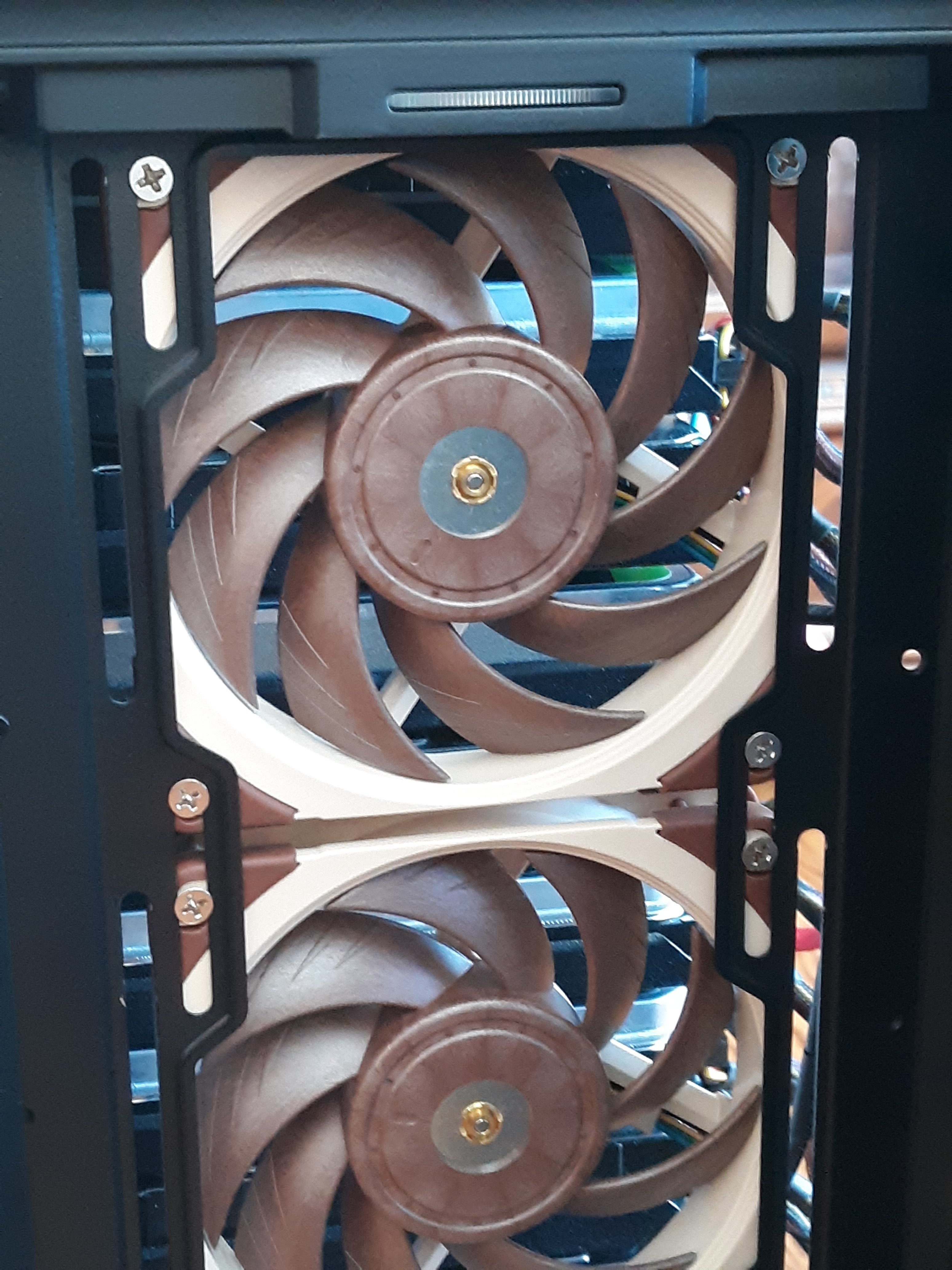

  7. Thank you so much Geck0 for responding, and for your pictures! I am sorry for not responding earlier. Somehow "life got in the way" and I just logged in again. My apologies. I see temps in the 40s and 50C for your disks. The pics look like the disks sit next to a radiator whose fans are probably set to take air out. The warm air from the case gets blown over the disks to then be sucked out by the fans across the radiator. That could make the disks hotter than in a configuration where the disks sit right next to intake fans. Does anybody reading this have a Fractal Meshify 2 config where the drives sit right next to the fans and take in air from outside to blow over the disks to cool them? I would love to hear what temps you are getting. Right now I have something like that in a "rigged" case: temps in high 30s C during parity check in summer with ambient temp around 78F (25.5C).
  8. Thank you so much for responding, MadMatt337 and Geck0! That are great temps, MadMatt337. Exactly what I had hoped for. Great airflow design through your case. And nice cable management. Looks very neat and organized. I plan to use the same air cooler for the CPU. Very valid warning about watercooling, Geck0 even though yours looks amazing and gives great temps. It looks very tempting Thank you both for the pictures! First I will just move the existing build to the new case, see how it works, then after a while get new motherboard / cpu etc. Right now I have 7 drives (10TB Iron Wolf parity, 6 mixed 8TB Seagate/WD data), but that won't be for long once I have a new case. 14 drives will probably be my max. Once I am at that number I'll probably start replacing older drives instead of just adding new ones. Great idea with the 120 mm fans to have one at the bottom to push into the drive cage, Geck0. Definitely will try do that as well. Yes, I'd love to see pics of your build when you put in the hard drives, Geck0. The RGB looks lovely, btw. Great idea for the server. Mine looks just black and bland (Rosewill Thor case). Even my PC case (Coolermaster HAF X) has the RBG of the graphics card and the power supply shining through its window.
