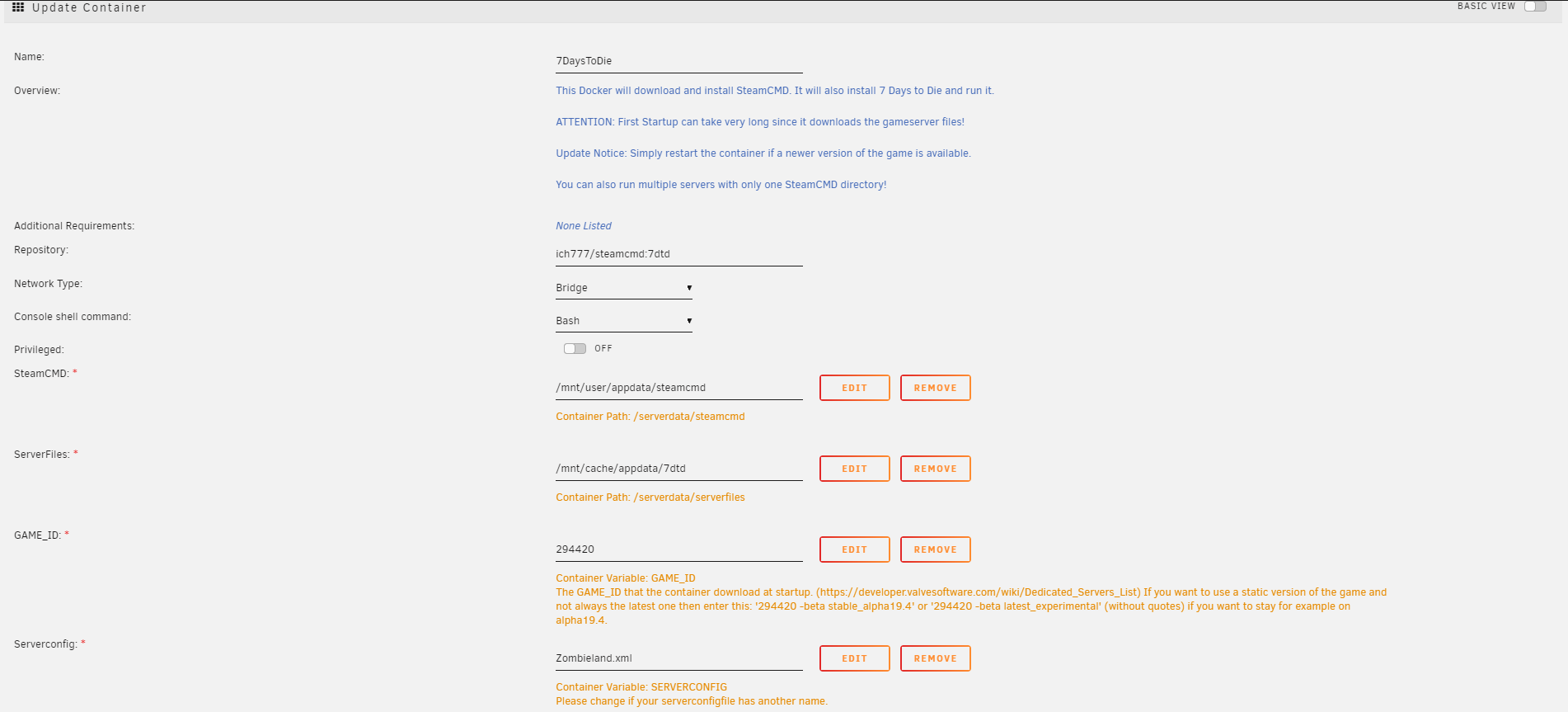

  1. Just wanted to let everyone know I got my 7dtd server up and running. After a lot of troubleshooting I realized that if I changed the container back to the default serverconfig file my server worked. Turns out there was a typo in the new serverconfig file I made under the "GameWorld" value. Can't believe it was something that minor. I am just glad I figured it out. Thanks everyone!

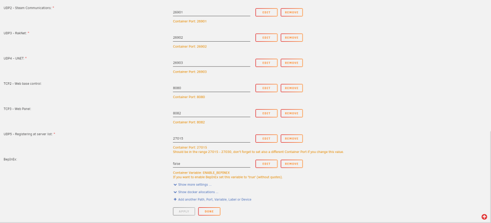

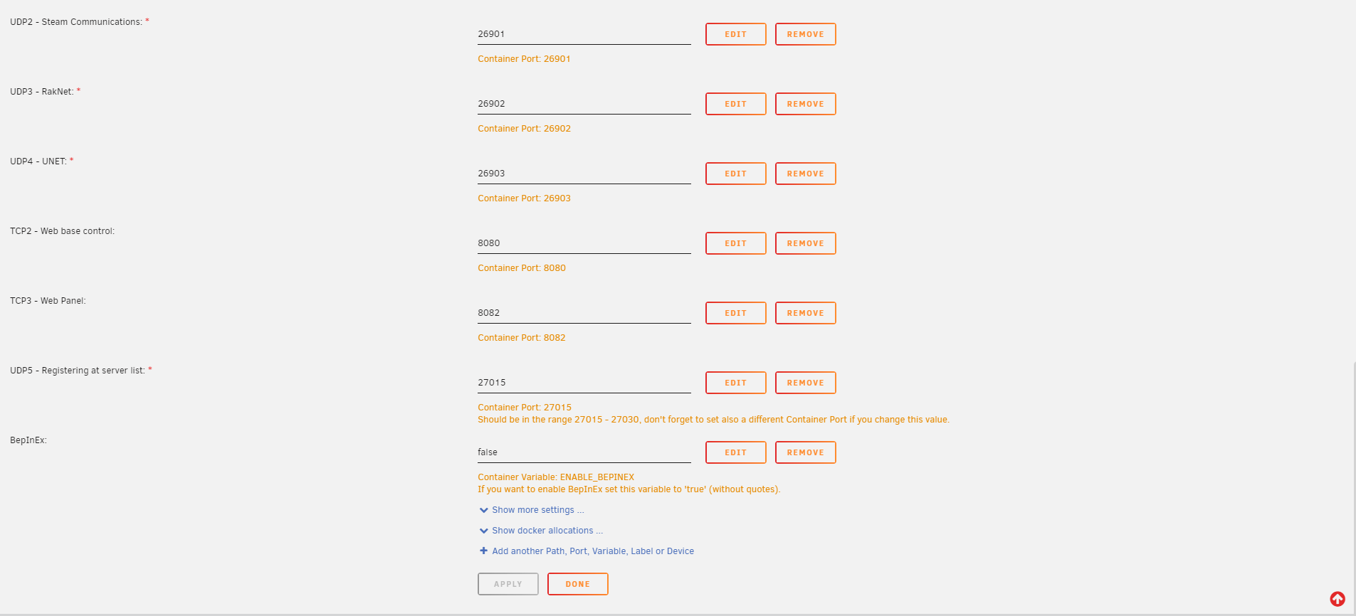

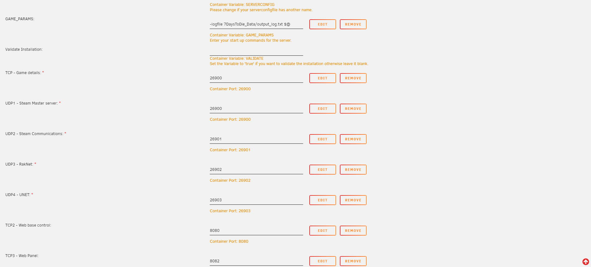

  2. Hey all. I apologize if this is not in the right location, but I am looking for help setting up a 7 Days to Die server on my unraid server. I have done everything I can think of and I am still getting a "Could Not Retrieve Server Information" error. I have set this server up once before and got it to work so I am no stranger to this. It took me a few days last time, but eventually port forwarding the range 26900-26905 fixed the problem. That is not the case this time. I used the guide located here.. I have left most of the container defaults as normal. I did change the serverconfig file to match the name of the one that I made with all the settings I want for my server. Other than that, I made no changes to the container. I also did not change any of the default networking settings within the serverconfig file. If that matters. See the images below. Lastly, I set up port forwarding to my unraid server using the range of 26900 - 26905 and the protocol TCP/UDP. I have also attached my output log as well, which as far as I can tell is showing no errors. This leads me to believe this is a port forwarding issue or some networking issue. I have set up port forwarding before for both my VPN and Plex server that are on my unraid server and those appear to be working well so I am unsure why it wouldn't be working for this. Thank you and hopefully I have provided all the necessary information. If not let me know and I will add what is needed. output_log.txt
