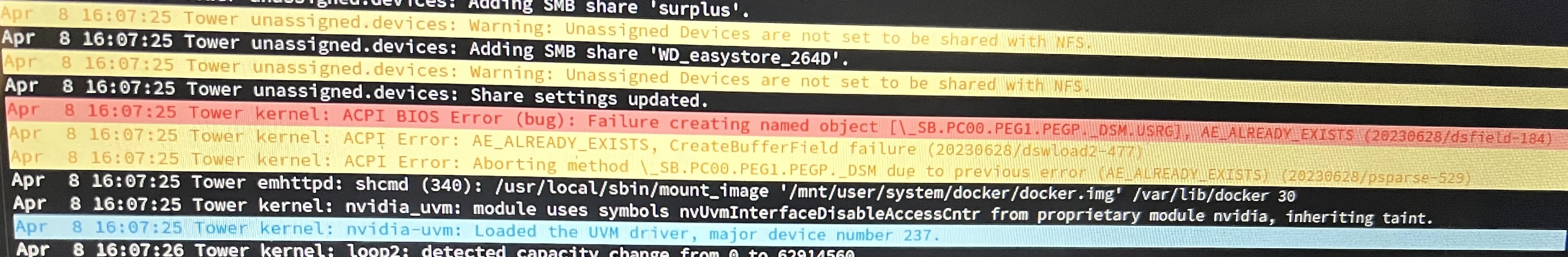

  3. So, I was playing a game on my windows 10 vm and suddenly the entire server crashed. I rebooted, but the game I was playing would constantly crashed once started. I tried opening the Nvidia app to check my driver, but it froze and the server crashed again. Since then, when I boot up the server the cache pool (btrfs) says unmountable. Also the web ui becomes unreachable when the server is running for a while and I get these errors on boot (pic included). Diagnostics are attached. tower-diagnostics-20260511-1610.zip

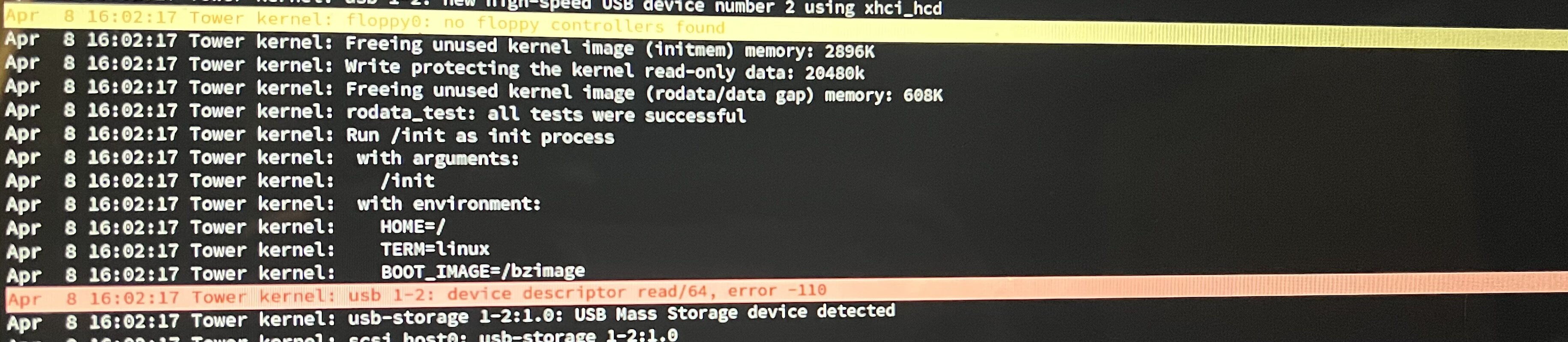

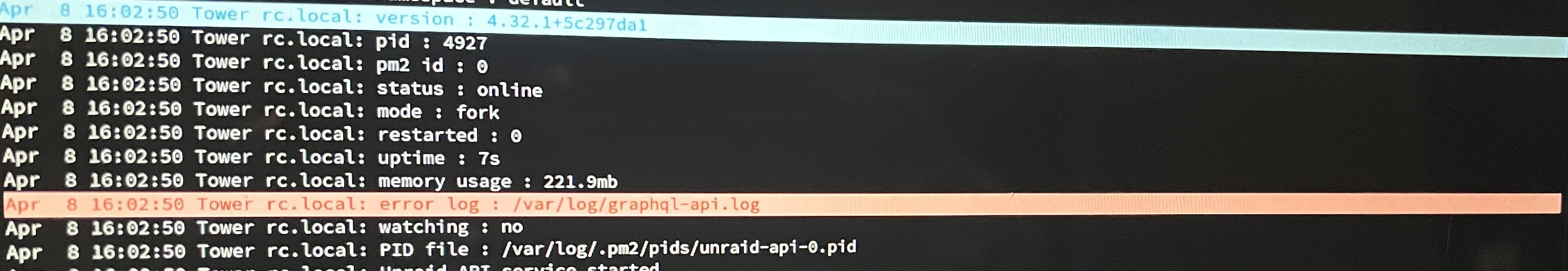

  4. Sorry, didn’t grab the diagnostic initially. I just ran fsck on my usb, inserted it back into my tower, and now it boots. Plex along with everything else seems to be working again, but I still don’t know what happened. I still see some errors in my syslog. I’ve attached it along with diagnostic below tower-syslog-20260408-2137.zip tower-diagnostics-20260408-1610.zip

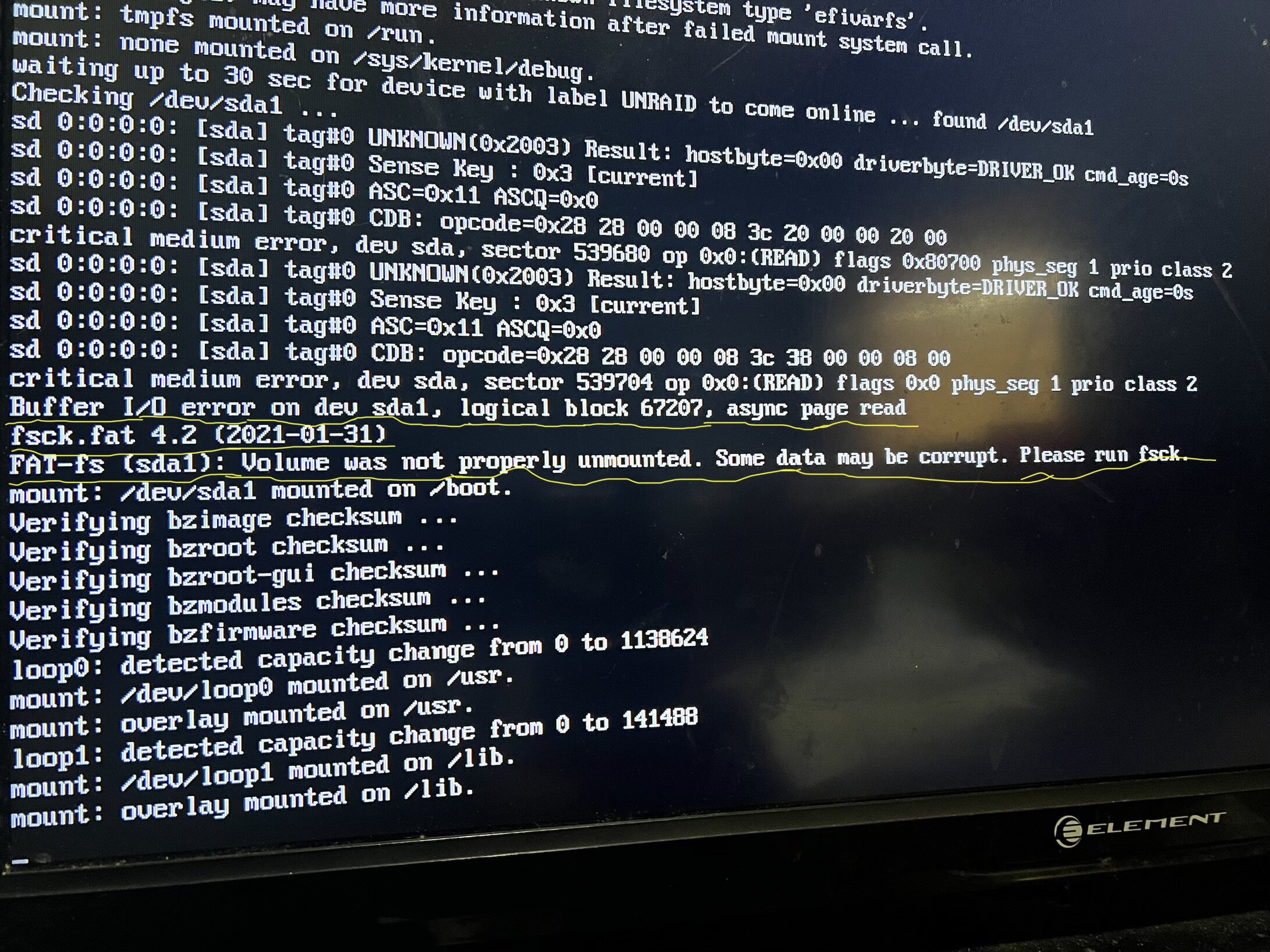

  5. Last night I noticed that my plex docker had stopped, and would give me an error message when I tried to start it back up. All other docker apps were working. I looked at the system log and it said something about nchan not having enough memory. I don’t know what that means so, I grab the diagnostic and tried to reboot the server. Now, the Unraid won’t boot even though it’s the 1st thing set to boot in my bios. I tried booting it directly from the bios, but it acts as if it’s not there. I plugged the usb in my Mac and it mounts plus all the files are there, so I’m stuck on how to resolve this issue. I’m going to do a fsck check, but other than that I’m lost. Please help. tower-syslog-20260408-0352.zip

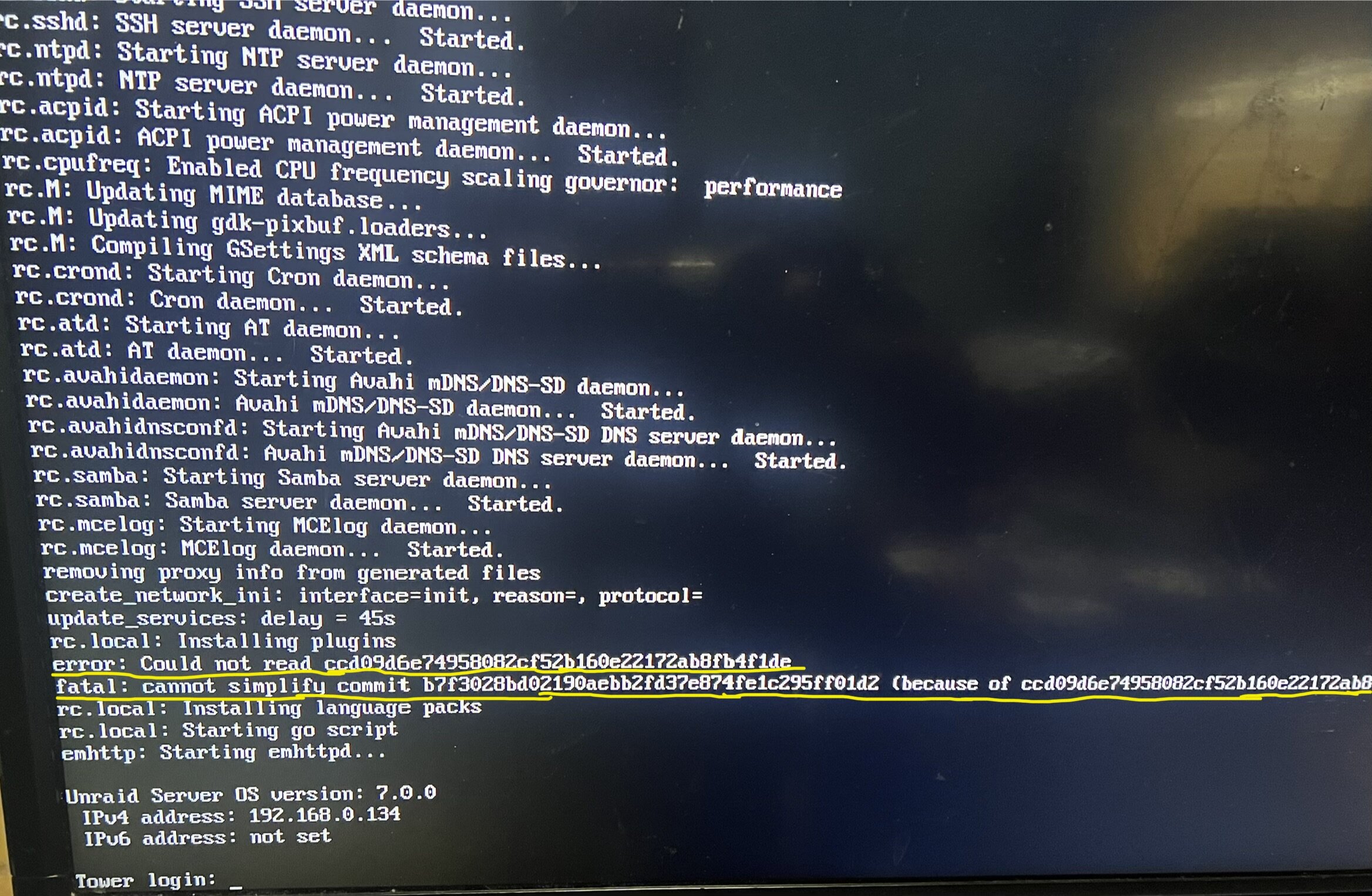

  8. Soooo, I’m still having issues. After getting Unraid to boot I updated my plugins and docker containers while my system did a parity check, which took 2 days. I decided to do some cpu pin isolations to optimize performance. This required me to reboot the system. The tower shutdown, but now I can’t get it back up again. This time the boot seems to complete, but I can’t open the login page on any of my devices. I’m getting the message again that says “volume was not properly unmounted some data may be corrupt.” I’m also getting a new error message (screenshot below) and I have no idea what it means.
  9. All systems go. It was the vfio-pci.cfg file. Deleted it and everything is working fine. Thanks for your help.

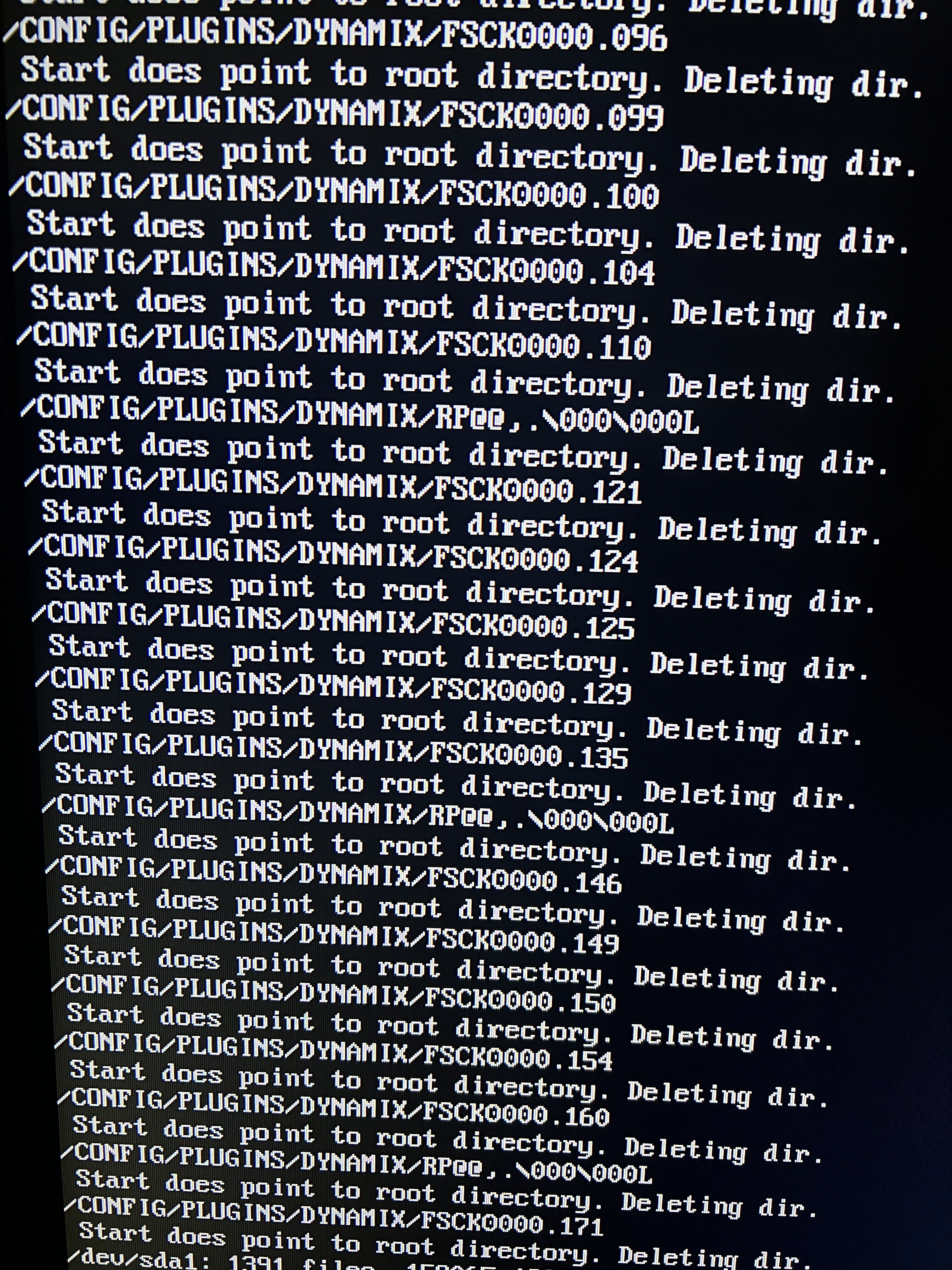

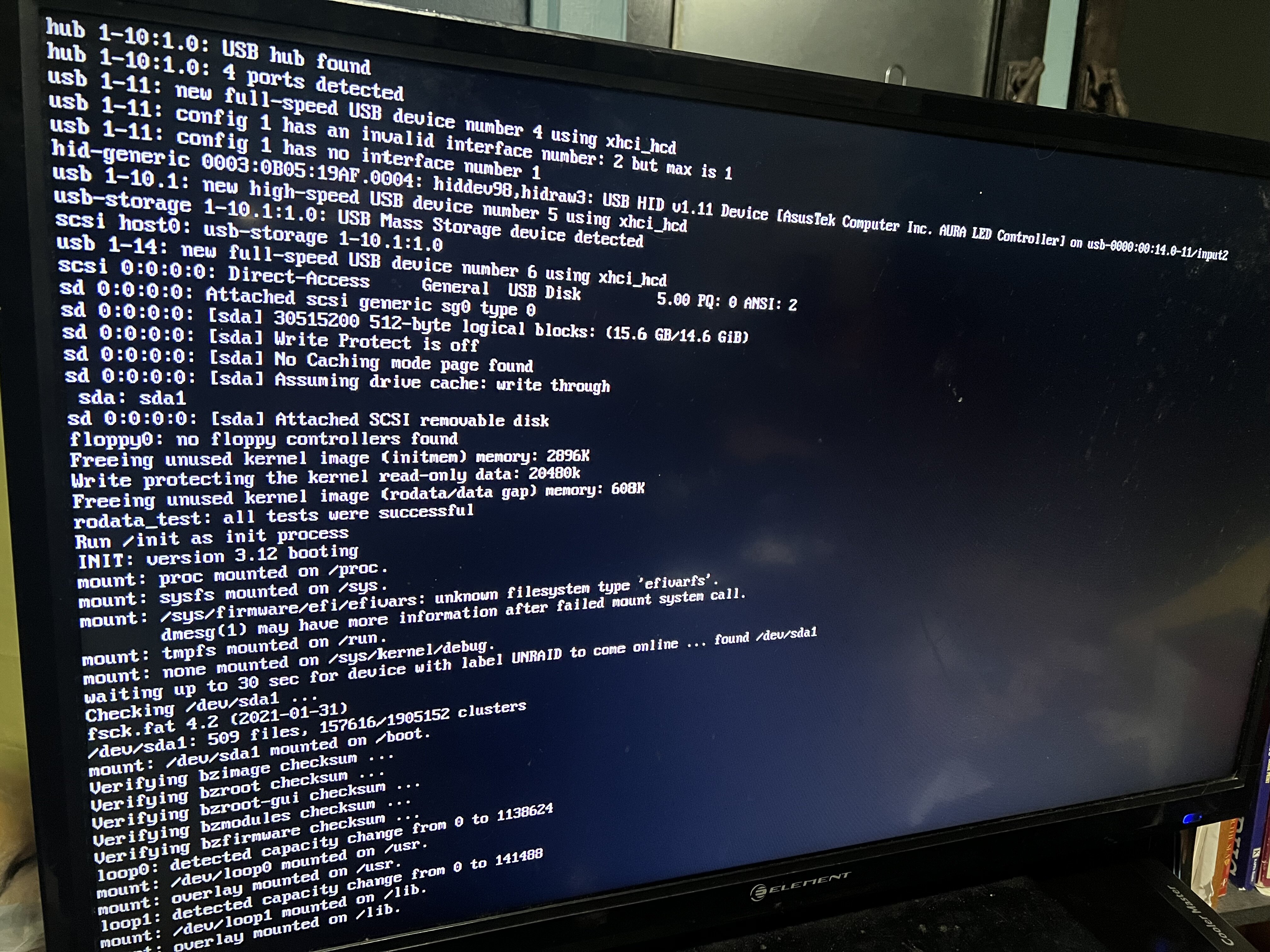

  14. I did the fsck check on my Mac. It reported 4263 files and 1,749,755 clusters. I purchased a new flash drive, installed a fresh Unraid 7.0, and copied my config folder from my last drive. Now it’s not giving me the FATfs error, but it’s still not booting and stopping at the same spot. Also tried booting from a different usb port (2.0). (Pic below)
