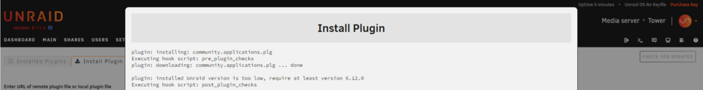

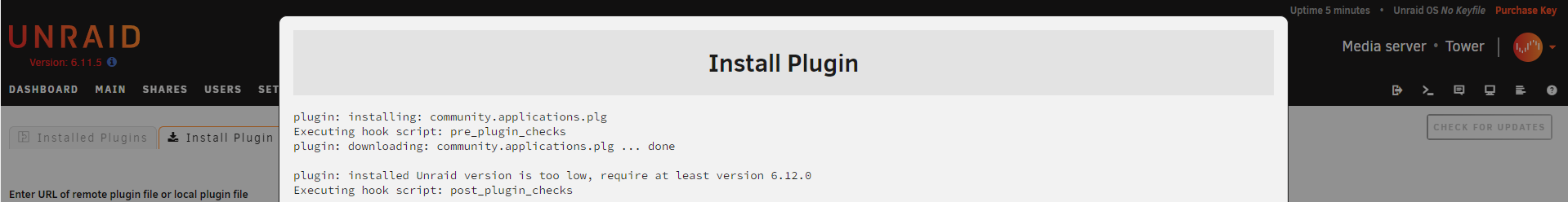

  5. has anyone had it where their plex docker just stopped scanning some libraries? my TV and animie is still scanning /updating but my movies just arent scanning the folders anymore i verified the data is being moved from radarr to the correct location but plex just wont find the data. i also ran the fix common problems thinking it was a permission problem but it didnt find anything. unraid-plex-diagnostics-20250214-0025.zip

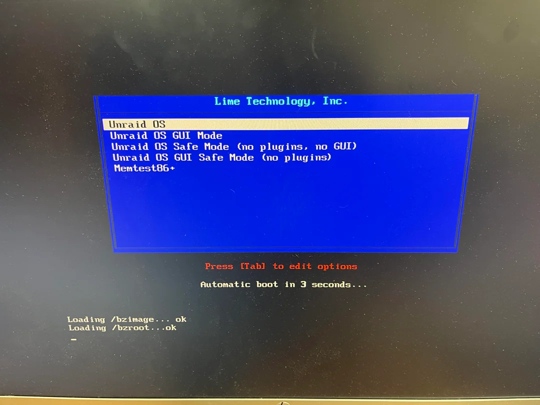

  6. to get server ideally back up and running im trying to run 6.11.5 which is the only copy i could download that booted i cant install CA. any thoughts to why 6.12.10 or 12.9 arent working or any diagnostic i can run to get a better idea or is there another way i can get CA to work so i can rebuild my server? i should mention the times i have tried to get 6.12.x to boot after i get the loading /bzroot ...OK the screen flickers 2x like its trying to load something before rebooting
  7. so i tried a separate flash drive and im experiencing the same issue with fresh copy of unraid on the 12.10 and 12.9. im assuming there was some new features that maybe caused some incompatibility.
  8. im running a Dell precision tower to run my unraid setup. i was running V11 yesterday and ran the update to go to 12.10 now my server just gets to the following screen the flickers and reboots. i have tried creating a fresh copy of usb drive and V12.10 and 12.9 do the same thing. when i installed a fresh copy of 11.5 it boots fine but im unable to access some features like installing the CA addon. id like some help getting my server to 12.10
