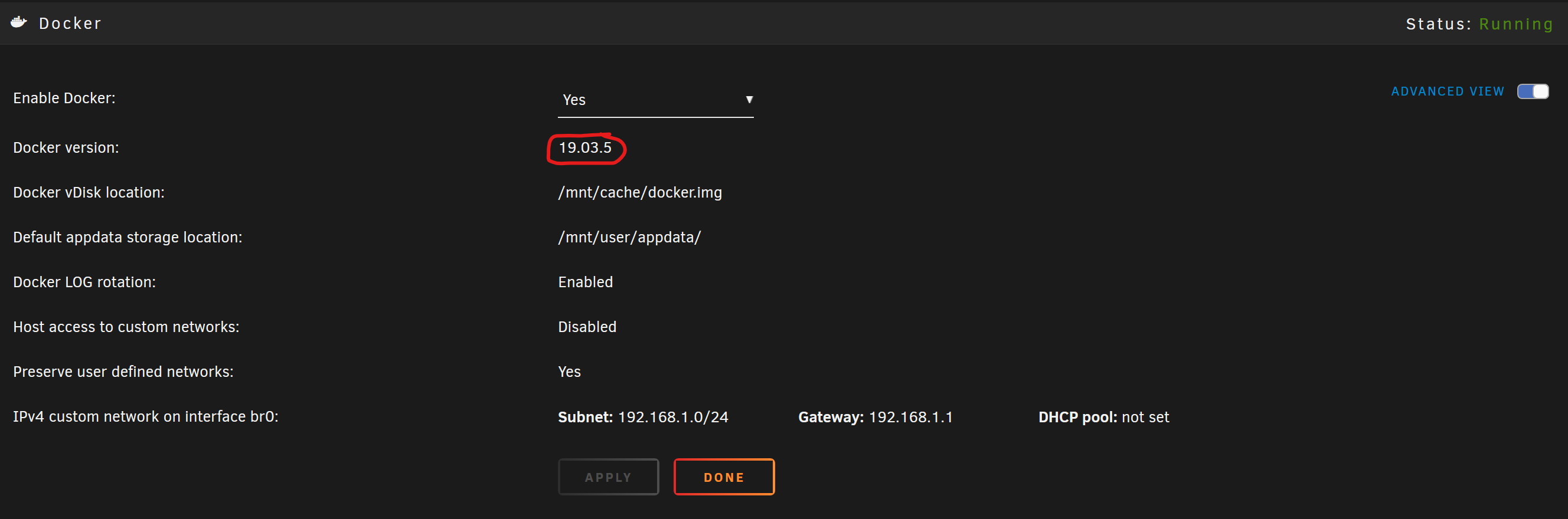

  6. Can you also check your Docker settings? The Docker version changed at 6.8, your screenshots look like you might still be running an older version of Docker, which can be changed in the settings. Under Settings -> Docker it will show you the version you are using, which can only be changed when Docker is disabled.
  7. If you are on 6.8.x the "Extra Parameters" method of Docker networking won't work anymore. You need to create a customer Docker network from the UnRAID command line that is named the same as your VPN container, then remove the extra parameters from your Jackett etc. containers and set the network type to Custom: container:name-of-your-custom-network. Unless you intentionally changed the version of Docker you are using in the Docker settings, the default for UnRAID 8.6.3 should be Docker 19.03.05.

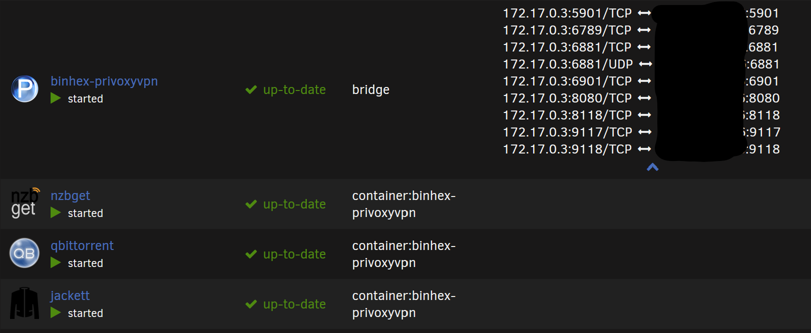

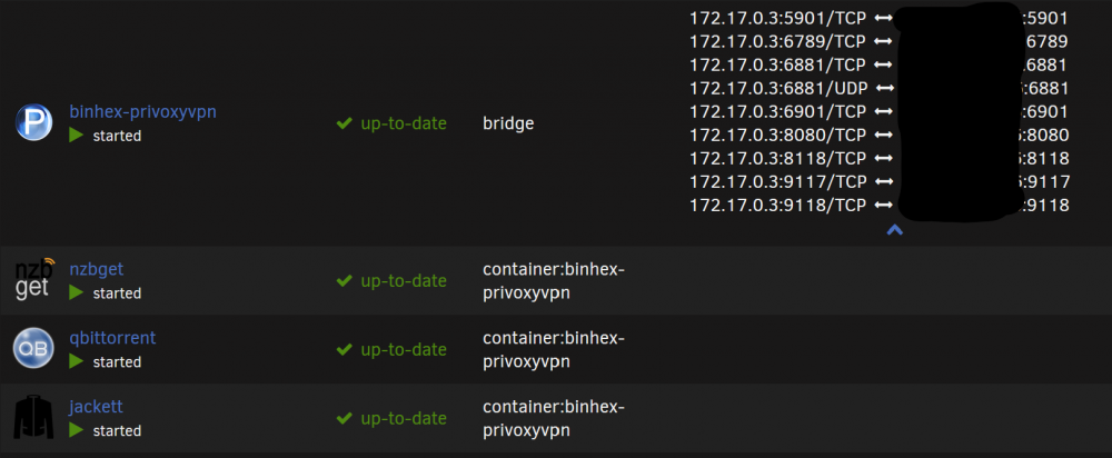

  8. I feel like I ran into this same issue when I first was getting this running, but I can't remember for sure. First note, the "--net=container=vpn" definitely doesn't work on 6.8.3. It does sound like you have the custom network set up properly if you can curl the VPN IP on the console for your client containers, one thing I wanted to make sure was that the VPN container was still set to Bridge for the networking mode, not the custom network you created. Only the "client" containers need to be set to the custom VPN network. On the main Docker tab for UnRAID the client containers should have nothing show up in the Port Mappings column. Here is a screenshot of my setup with the Binhex VPN container and three client containers, yours should look similar if you are set up correctly. Hopefully this helps!
