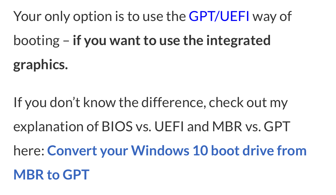

  1. Right, forgot I’d come across that article. So here it shows directions on how to do so via Windows. Is there a way via Unraid or am I better off buying a cheap graphics card? Would that for whatever reason allow me to figure out why my 10tb isn’t working (showing in HBA) or is that a separate issue? Sent from my iPhone using Tapatalk
