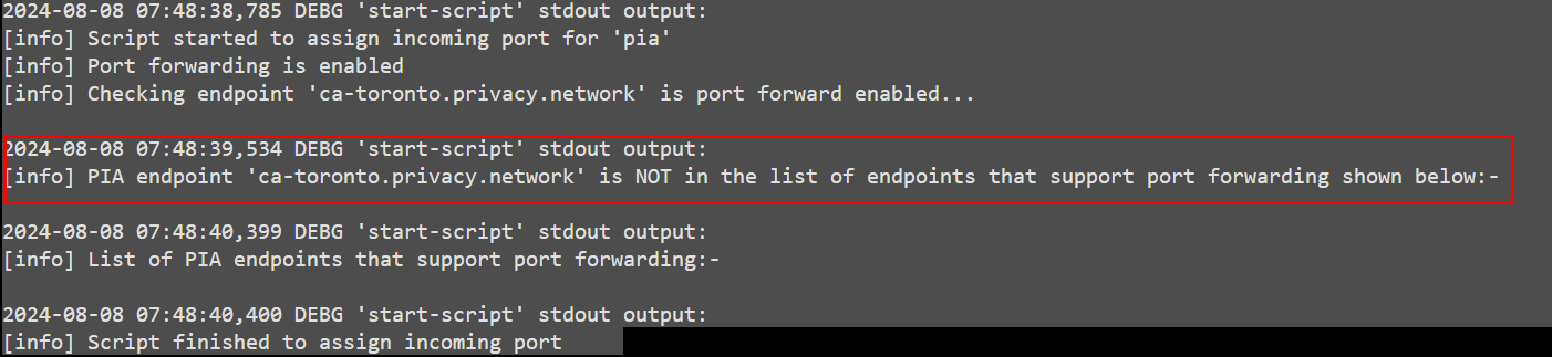

  3. Okay...I have resolved this issue finally. It is always something small. In my ovpn file I have several remote access points that allow port forwarding ****** remote ca-toronto.privacy.network 1198 remote ca-montreal.privacy.network 1198 remote ca-vancouver.privacy.network 1198 remote de-berlin.privacy.network 1198 remote de-frankfurt.privacy.network 1198 remote france.privacy.network 1198 remote czech.privacy.network 1198 remote ro.privacy.network 1198 ************ I did this incase an endpoint goes down that it would go to the next one. I did a double check against PIA servers again for port forward enabled endpoints using this Curl command. curl.exe -s https://serverlist.piaservers.net/vpninfo/servers/v6 | head -n1 | jq -r '.regions | .[] | select(.port_forward) | .name' | sort I checked the results against my ovpn list and it appears that Spain was removed from the port forward enabled endpoints. So the lesson learned here is that if your ovpn file has multiple endpoints and one of those is removed from the list in PIA, it will not connect correctly. Once I removed Spain, it connected just fine.

  6. Bumping this. I still have not resolved this issue and I am not sure what the problem is. Can someone point me in the right direction. Regardless of what PIA endpoint I choose, DelugeVPN says it is not in the list of endpoints that support port forwarding.
  7. Having issues with PIA Port Forwarding OVPN's. They just stopped working in the last few days and I don't know why. I was using CA Toronto. I queried the API to get valid port forward endpoints using the following: $ curl -s https://serverlist.piaservers.net/vpninfo/servers/v6 | head -n1 | jq -r '.regions | .[] | select(.port_forward) | .name' | sort I have tried every other Canada endpoint as well as Netherlands, Berlin and Mexico, but I get this in the log each time. 2024-07-26 08:11:36,228 DEBG 'start-script' stdout output: [info] Script started to assign incoming port for 'pia' [info] Port forwarding is enabled [info] Checking endpoint 'de-berlin.privacy.network' is port forward enabled... 2024-07-26 08:11:37,275 DEBG 'start-script' stdout output: [info] PIA endpoint 'de-berlin.privacy.network' is NOT in the list of endpoints that support port forwarding shown below:- 2024-07-26 08:11:38,324 DEBG 'start-script' stdout output: [info] List of PIA endpoints that support port forwarding:- [info] Script finished to assign incoming port Am I missing something that has changed at PIA? Can someone point me in the right direction?
