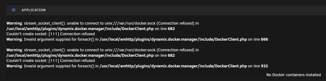

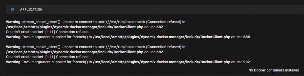

  8. Any sort of tests I can do to see what's wrong?
  9. After restarting I now have the following: Server logs are attached for this instance server-diagnostics-20220614-1401.zip
  10. So this issue has been happening on and off for the past few months. What seems to happen is that all of a sudden my docker containers would just become unresponsive and not work. Stopping or Restarting the containers would show an error message in the UI saying something along the lines of 'Service failed to start' with no other information. Sometimes a reboot of the server would fix this, other times i'd need to disable docker, delete the `docker.img` and reinstall the containers. Today this has happened again and seems to be becoming more frequent, so i'm hoping someone is able to point me in the right direction of what I can do to resolve this. Server diagnostics are attached, currently the `Docker Service failed to start.` at this point i'm probably going to have to delete the docker image and start again. If there is any other information I can provide please let me know. server-diagnostics-20220614-1334.zip
