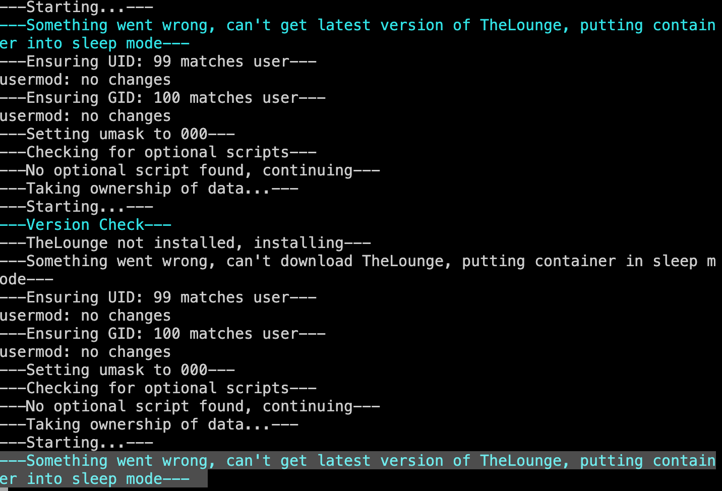

  1. I fixed my issue, in appdata/thelounge there was a 0 byte file that appeared to be the (attempted) download of the latest version of TheLounge. I deleted that and restarted the container, fixed my issue.
  2. I am having an issue for the last few days with TheLounge docker. Its run perfectly for months but recently its not starting up correctly and the log is throwing an error ---Something went wrong, can't get latest version of TheLounge, putting container into sleep mode---
