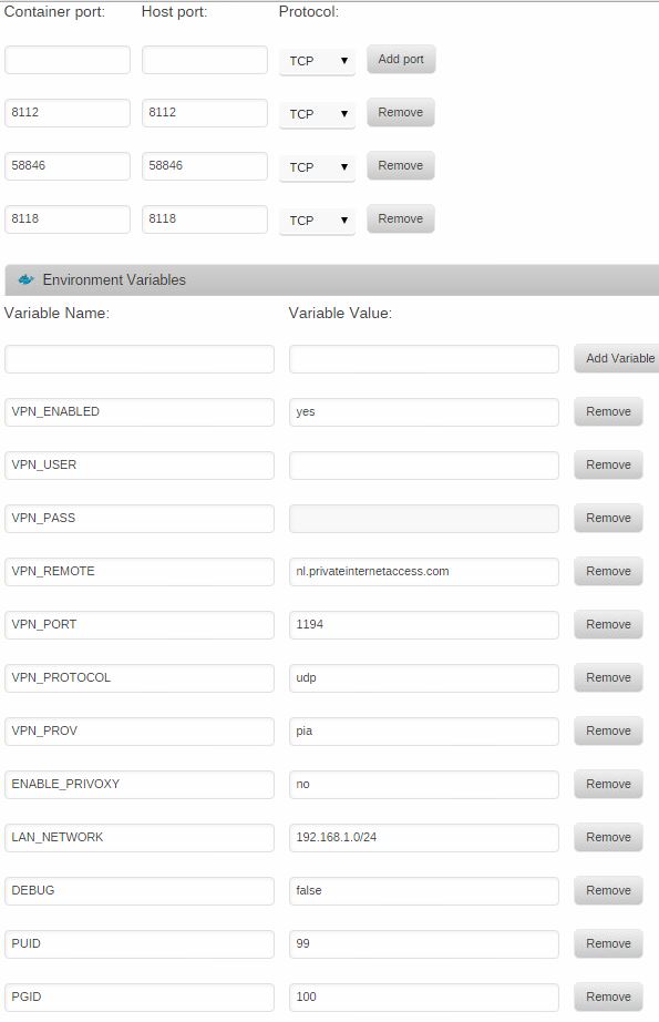

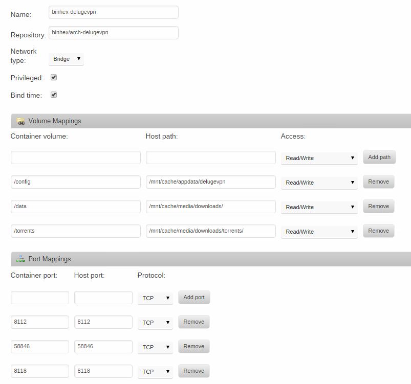

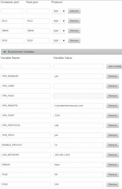

  13. I'm having issues with getting certain files moved and then successfully reseeded. My process goes as follows: -Manually add torrent to DVPN -Download to cache drive -Seed completed file on cache drive for awhile -Stop DVPN, run Mover -Mover moves the whole file to my media share, where I drag and drop it to the appropriate folder -Start DVPN, right click torrent, move, move file to pathed folder on media share "/movedmovies" -Once path updates, on torrent I run Force Recheck -This is no longer working and starts a new download. I have several movies and shows successfully moved and seeding using this method. I've double checked my paths and spellings, reboot server, stopped started DVPN, removed and readded torrent trying to associate it to the file but it keeps holding on to this microscopic download which does no exist anywhere (.02%) Because this process has worked several times before I have no clue where to look for potential issues, please assist. Thanks.
  14. Post your docker mappings. Does the docker have access to /mnt/user/media/downloads? I gather you got the IPT stuff figured out? Actually Jon I believe this is all related. I'm thinking I may have figured it out. I do have a /moved path to user folder. I'm adding my torrents back manually, pausing them, moving storage using "/moved", force rechecking and they're starting to seed. I believe this may be resolved but wow, it took a lot of trial and error. Thanks.

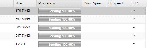

  18. All that makes sense, what doesn't make sense is why I'm not uploading, anything.

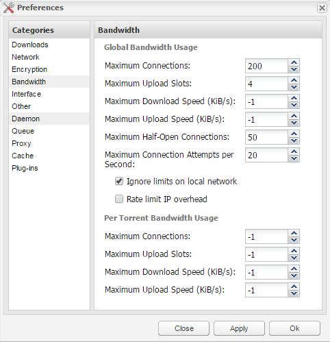

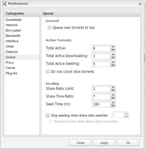

  19. Settings attached. The settings for queue I think are more relevant. Attached.

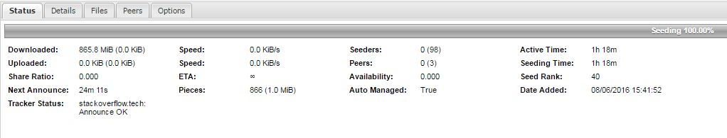

  20. The torrents that you show seeding in deluge, how long have they been that way continuously? The IPT status isn't immediate, sometimes it can take a couple hours or more to update. I'd leave it alone, and check back with the IPT status later. Also, I'd have the torrent from this link https://torguard.net/checkmytorrentipaddress.php in your client, that way you can get an an easy update on what IP you are using. Its been seeding on and off for about 2 days now, intervals of at least 5hrs.. I have that torrent and confirmed I'm tunneled. This is just absolutely bizarre.
  21. Settings attached.

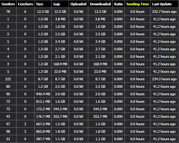

  22. What is your peers status on IPT? Does it show any of the files in your client currently listed either under seeders or leechers status? As long as the file is listed in the seeders section, you are fine, doesn't really matter whether or not someone is actively pulling data from you. Problem is I've never seen an upload or seeder out of 20+ torrents. Here are some screens to show you what I'm talking about. I'm not getting credit for my seeding time which has killed my ratio and thus, cannot download. If I seed for a certain period of time (grabbed or not) I get credit towards my ratio. Even when I'm downloading I'm not seeding from another site. Starting to think I have a router issue but I need more eyes and brains to help me rule out anything obvious.
  23. Attachments of settings (UN/PW removed). Logs will come shortly.
  24. Which VPN provider and endpoint are you using? I'm using CyberGhost - OpenVPN settings (Netherlands) Per their FAQ, allowing P2P and opening ports are 2 different things. The premium service allows P2P, but they don't open ports for you. Since you do not have an open port to allow unsolicited incoming connections, you are not available for uploading to IPT. The only connections your client is making is to download, and if the peer you are downloading from also needs parts that you have, you will upload to them while you have that connection open, but as soon as the torrent client closes that connection you can no longer seed to them. TLDR, get another VPN provider that allows incoming ports. PIA is the easiest to set up, as all the configuration is done for you in the container. Switched to PIA, updated UN/PW, confirmed tunneling, still not seeding... Do I need to do any port forwarding on the router, or settings within PIA website?
  25. Which VPN provider and endpoint are you using? I'm using CyberGhost - OpenVPN settings (Netherlands) Per their FAQ, allowing P2P and opening ports are 2 different things. The premium service allows P2P, but they don't open ports for you. Since you do not have an open port to allow unsolicited incoming connections, you are not available for uploading to IPT. The only connections your client is making is to download, and if the peer you are downloading from also needs parts that you have, you will upload to them while you have that connection open, but as soon as the torrent client closes that connection you can no longer seed to them. TLDR, get another VPN provider that allows incoming ports. PIA is the easiest to set up, as all the configuration is done for you in the container. Thank you for taking the time to provide me this. I have their premium service. If I'm understanding you correctly there is nothing that can be done here to make this work and I should get rid of this VPN?
