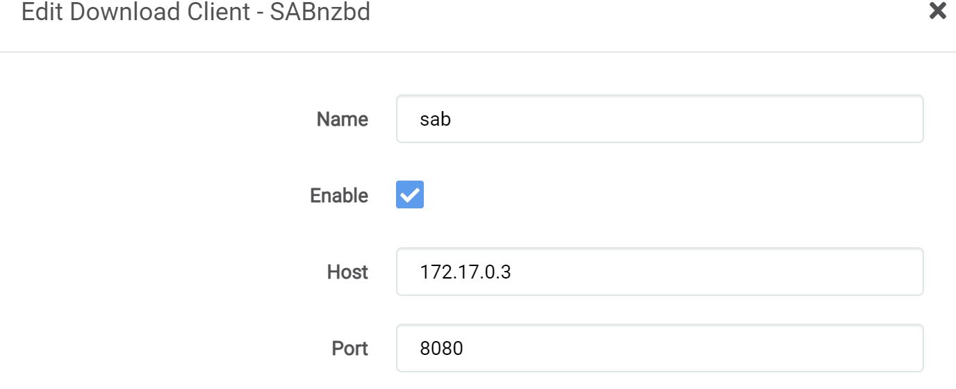

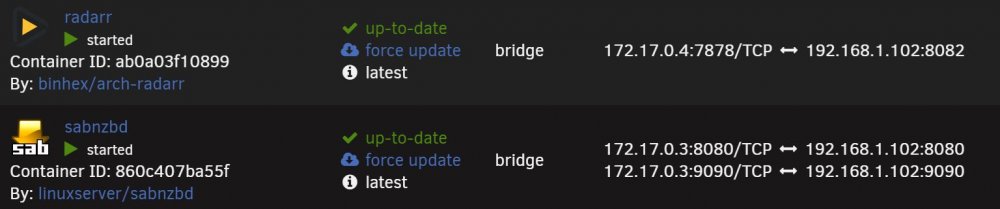

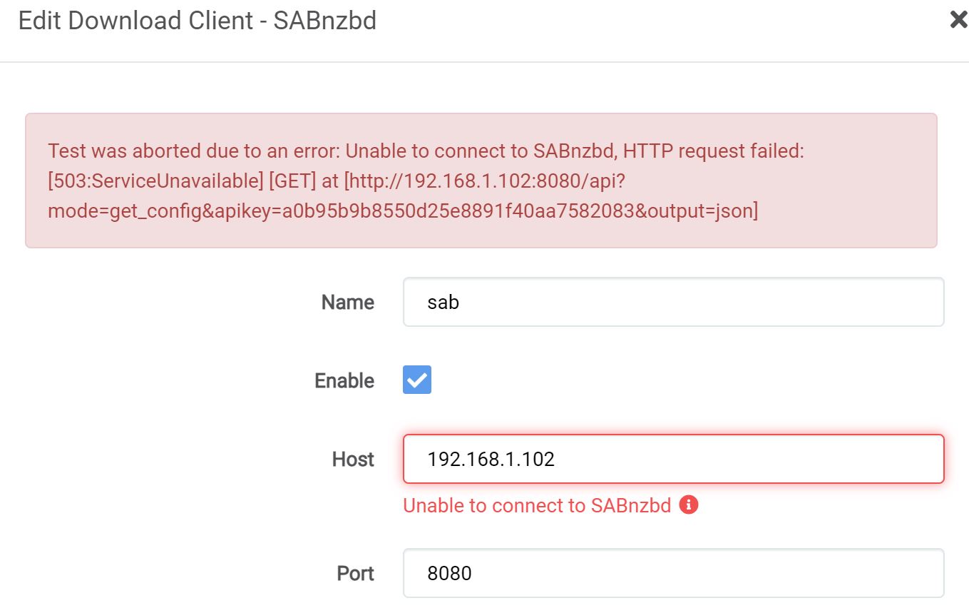

  5. Right. That is how I had it for years, no issue. All of a sudden dockers will not communicate with each other using the Host IP and I fail to understand why. I can and do access these dockers via the host ip and corresponding port from anywhere else, except another docker. This was my previous setup, which no longer works. Now to get them to work I have to use this, which is problematic.
  6. Yes, most of them are using bridge.
  7. Any other advice on this? It is rather frustrating. Using the 172.* subnet works, but the ip's for the dockers on this subnet are not static, so I am constantly having breaks in the communication between dockers and have to go into them and change the ip's around when they end up changing at random.
  8. A few months ago out of the blue my docker containers were unable to communicate between each other using the local subnet I am using (192.168.1.0/24). I can reach them via any other device on the subnet no problem. After a large struggle, I found that they will communicate via the docker subnet? (172.17.0.XXX). This provided an immediate solution but not an answer to what happened as I have had this setup for several years without issue. The issue using the docker subnet (or whatever it is actually referred to) is that the IP changes randomly and then I have to go through a bunch of dockers to reflect these changes. Any ideas to a solution, one way or another?
