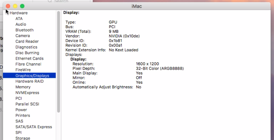

  7. Hey Gridrunner, Thanks for the reply. I solved the issue by upgrading the nVidia driver to the latest available one: https://images.nvidia.com/mac/pkg/378/WebDriver-378.05.05.05f01.pkg So now "almost" everything is working properly. The last issue is the sound. I have tested 3 different ways to have sound which where: - USB SoundCard - Bluetooth headset - Splashtop sound driver All of these solutions suffered from noice crackling/stops for a few milliseconds. I also noticed having the similar issue(less noticeable though) on my Windows Gaming Rig also running on unRaid. I haven't configured anything on unRaid regarding the CPUs with `isolcpus` for example. Should I? Is there any other things that I should be taking care of? Thanks

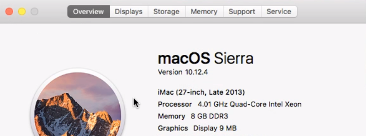

  8. Hey, Thanks for the video, and this new method which is really really faster than the old one. However I got an issue at some point: OSX was running 10x the normal speed. I browsed the thread, and found out the solution was to use older UFI files. I took those from your video from september. It did the trick. However I'm curious to know the reason of this failure for some of us But I got other issues too ... I've been able to boot, and also been able to attach the GPU (a MSI 1070 Gaming X). However the Graphic card is not recognized on OSX, and appears incorrectly. I've attached several pictures and the VM XML + Clover config plist + devices informations are available here https://gist.github.com/arkan/0aabf5243d5fe3af82eaeb6aaf8539cc Anyone has an idea? Thanks
