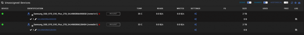

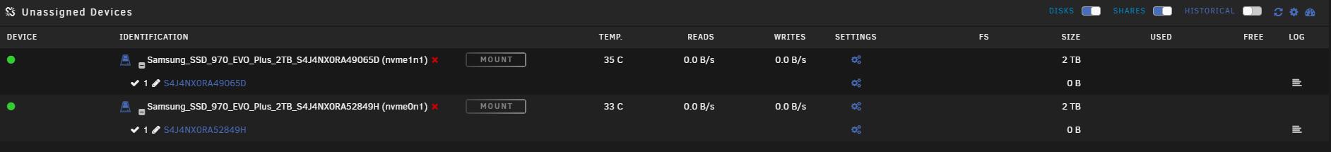

  3. Sorry for that, here is the screenshot you wanted i tried to format them with xfs and btrfs i will use these disks only for my vms.
  4. I have an HP DL380p Gen8 with two Samsung 970 EVO Plus (PCI Adapter) After Fromat, the Mount button is greyed out. idk why. i tried everything.
