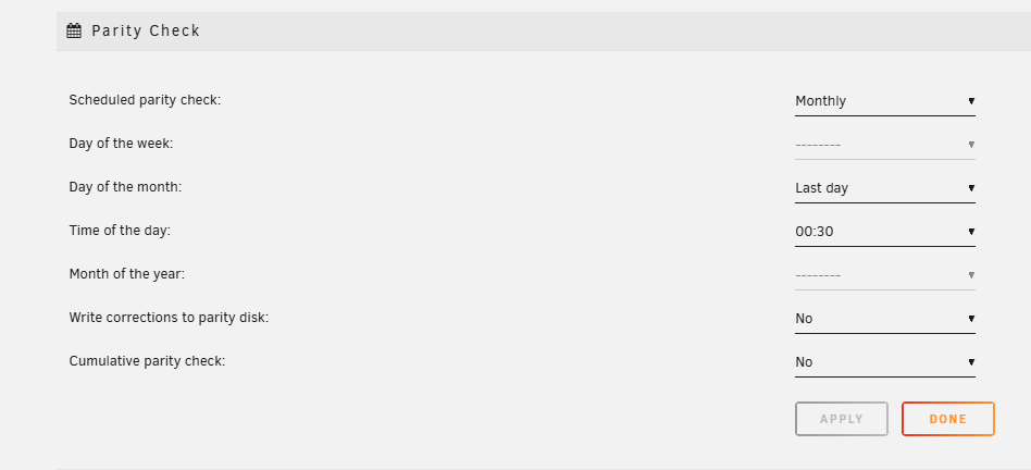

  1. Okay, that explains the parity checks. Thanks for the help. I'll know better where to look next time I have an issue. Now to workout what's causing the unplanned shutdowns that are happening...
  2. Thanks for the reply. Diagnostics attached. Having a quick look at the logs myself, I've realised that the parity check is triggering when it comes out of sleep. I did used to have it set to sleep, but it's currently disabled. So, I've got to work out why it's still sleeping, and why waking up is triggering the parity check. tower-diagnostics-20240820-1140.zip
  3. Recently my Unraid has decided to trigger a parity check every day at 11:03 in the morning. It passes each time. In the scheduler it's configured to run on the last day of each month. Does anyone have any idea why it would be doing this, and how to fix it? Thanks
