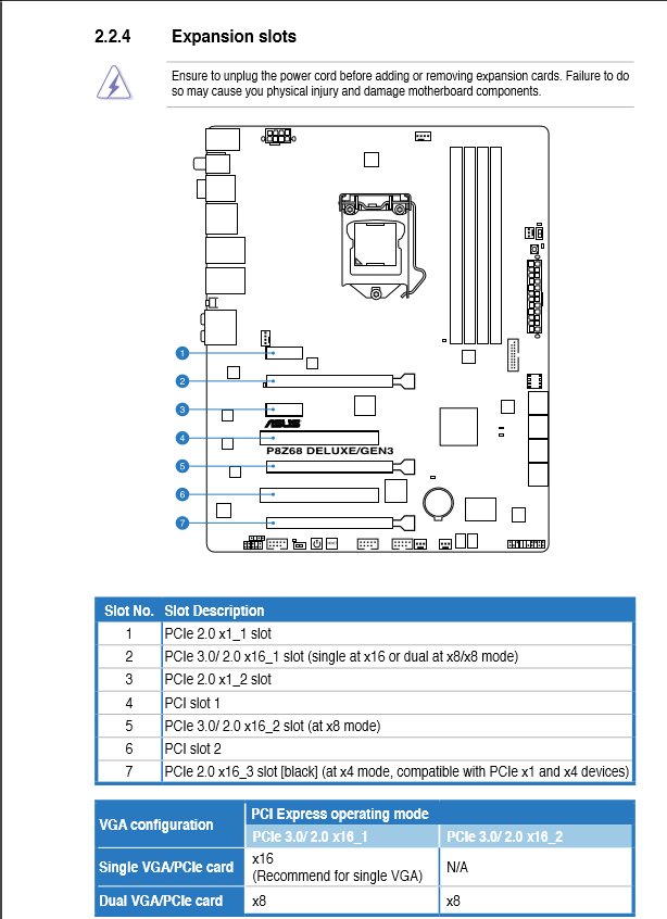

  3. Here is a screenshot of your motherboard layout for the PCI\PCI-E - not that its much help, I just like screenshots

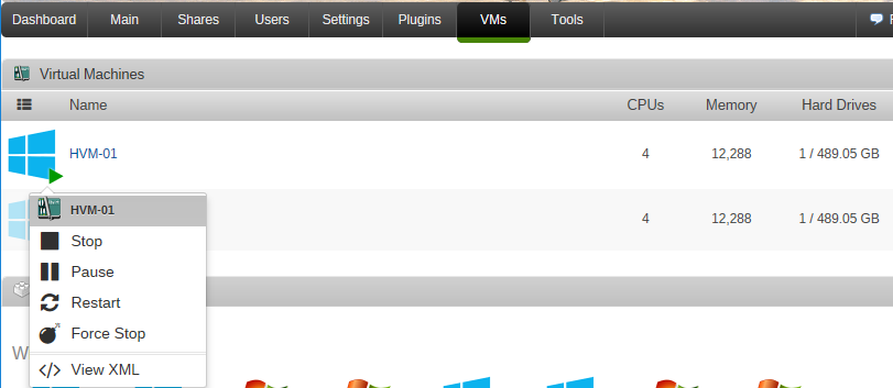

  14. I am having something very similar happening with my PCIe USB card(s) when passing them to my VM(s) and I have a post about it one or two up from yours. I am running Windows 10 and if I reboot the VM, the VM will lock up but not my physical host. My workaround for this is the following until I can figure the problem and may work for you. 1. From the Windows environment, instead of rebooting the normal way try this, open your web browser and navigate to the UNRAID Web management page. 2. Once at the UNRAID web management page navigate to the VMs tab, click the running VM you want to restart, and select restart. Restarting the VM with PCIe USB card pass-through, through the UNRAID web management has been the only way I have gotten the VM to actually reboot and come back online without locking up. Let me know if that helped. Also I did notice that when I shut down the VM through the normal Windows shutdown that the VM will shut down just fine, then I can start the VM back up as another option I use from time to time.
