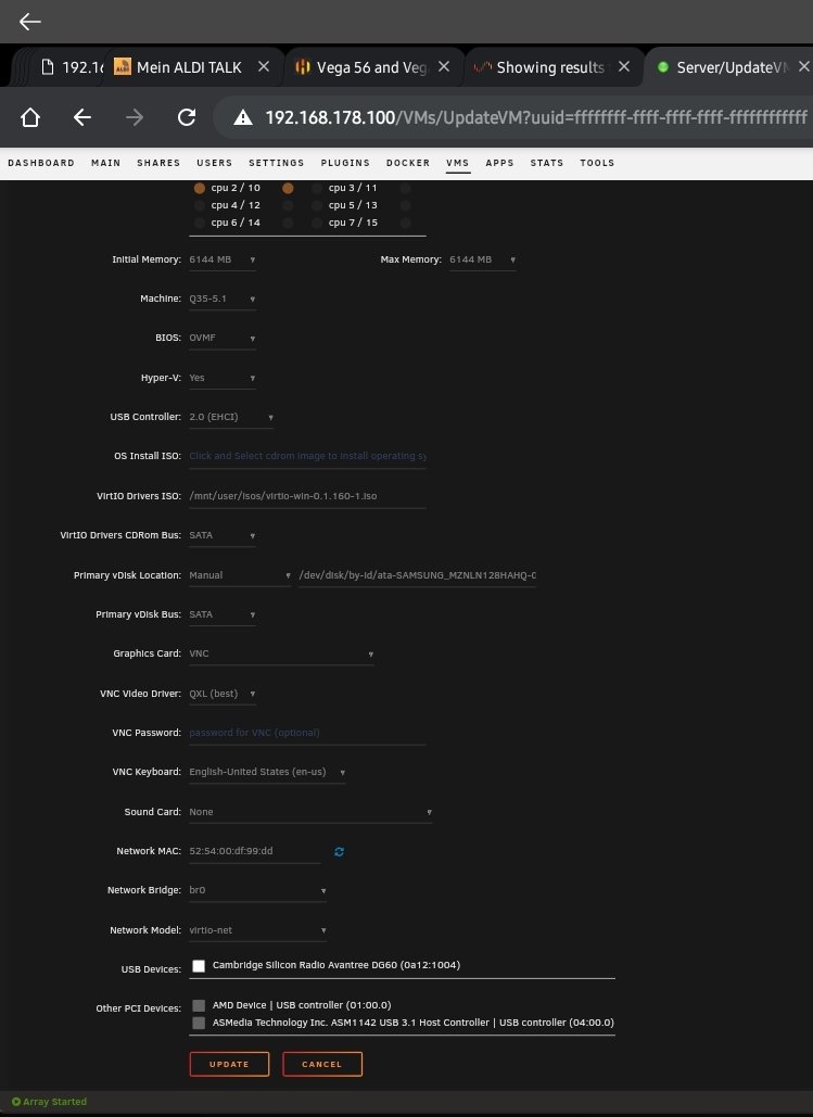

January 17, 20179 yr It's been a good day so here you go This is what my pass-through command looks like /dev/disk/by-id/ata-Crucial_CT525MX300SSD1_163313AAD0A9 Also edit your VM templet and make sure your Primary vDisk bus is set to SATA this will let the Windows install see the physical drive. Screenshot included

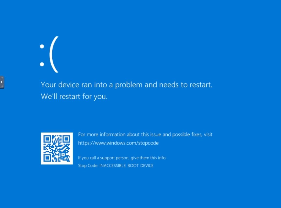

August 18, 20215 yr Hi everyone, Hope you can help me here with this. I can't get my windows 10 install running in a VM again. What do I have: I have a ssd with a Windows 10 install that I use for booting directly into win10. What do I want: I want to use this ssd and win10 to run it as a VM in unraid if I need it. What is my problem: I always run in to this blue screen with inaccessable boot drive. I tryed already all possibilities with the config. Etc. It is always the same. Blue screen or nothing at all. Can you help me here? Maybe I missed something Thx

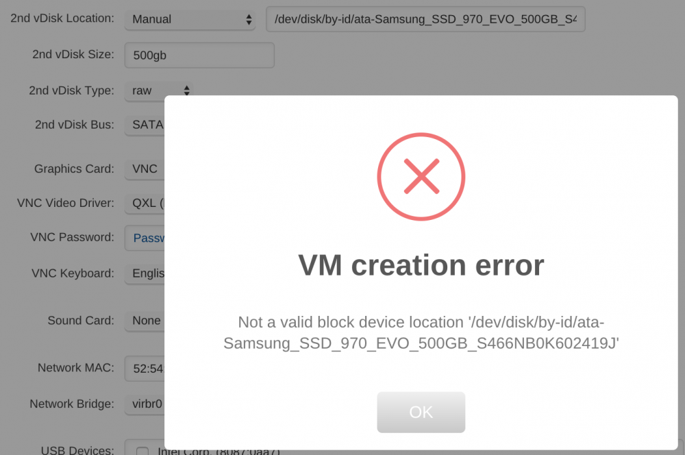

October 21, 20214 yr Having similar problems - that video gives us a general direction but frankly, many things have changed in the UNRAID settings. Even just doing the UUID change gives me a VM creation error. I'm stuck here as well...
