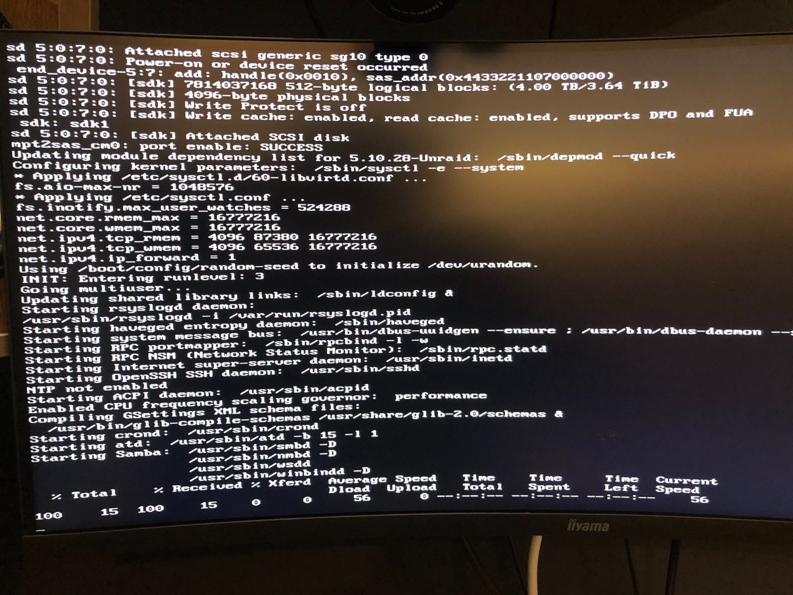

  1. i have exact the same issue, black screen on VM that was running perfectly
  2. it was either Unassigned Devices or Unassigned Devices Plus making issues with booting up, I removed it and installed again - all good now, thanks!
  3. Yes, it did boot without any plugins (I just renamed plugin file extensions to .plg1). I will now enable one by one to see what's the root cause and then change topic name to (Solved)
  4. Hi, Yesterday I tried to install machina box and before that I created a new cache pool from my unassigned nvme. Today when I tried to boot it, it's stuck on this screen. It does work in safe-mode, I removed everything related to VM and also that new cache pool, unfortunately it didn't help. Diagnostics attached. I would really apprieciate help and I am glad to buy a coffee! tower-diagnostics-20211204-1752.zip
