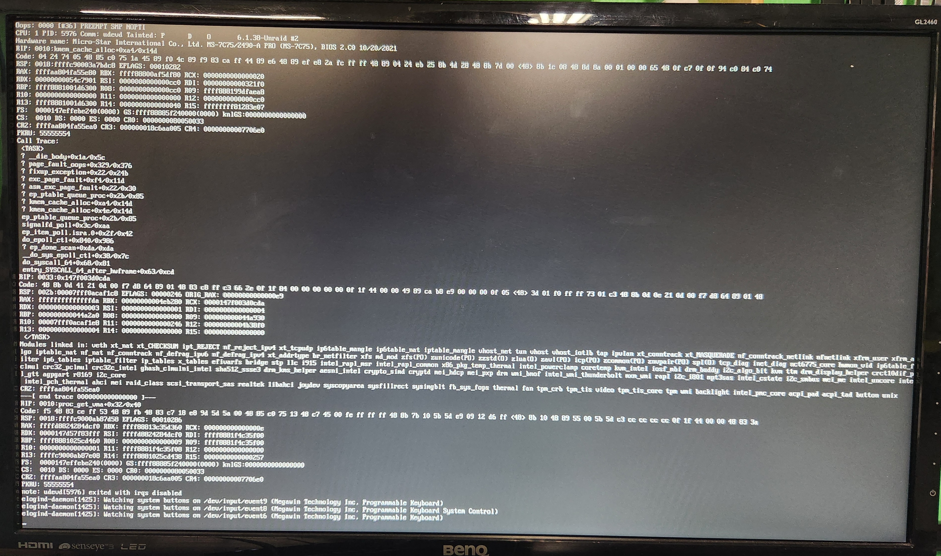

Nope, no ability to SSH. So, I did a bit of searching and saw a random post somewhere on this forum where a person said this error was a generic error (he had basically the same one). He said his problem was a Docker container. So I restarted, quickly went into the docker tab and turned off all dockers and made sure they don't come back up on restart. Then I started them all one by one. Turns out my deluge container was causing the problem somehow. So I deleted it and now I'm all good... no issues all night. Not sure what that was all about.

Well, after a day of rebuilding in maintenance mode, I turned on the array in normal mode, and everything seemed fine, all the drives are reporting correctly, but after a minute or two, it stopped responding. I can't get diagnostics from the Command Line because when I plug in my monitor and keyboard, I see the following error. I haven't shut down in case someone can give me some directions to get the diagnostics from the system. Any help would be appreciated.

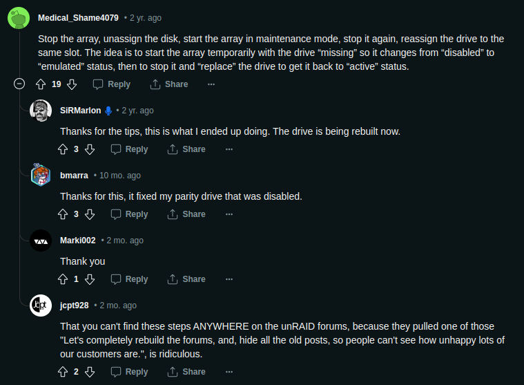

Ok, so for anyone else out there looking for a simple answer to the question... how do I enable (re-enable) disks on my array that I think are fine but now have the Red X on them, here's what I found on Reddit where someone answered someone else's exact same question. Stop the array Unassign the disk Start the array in maintenance mode Now stop the array again Reassign the drive to the same slot Then start the array back up again in maintanence mode and it'll start to rebuild them I'd leave the rebuild to happen in maintenance mode, at least that's what worked for me (see edit note below) Image of the post on Reddit for reference. EDIT: I was having issues with the system freezing up after following the instructions above. I'm not sure what it was exactly, but I decided to start the array in maintenance mode to do the rebuild, and it seems to be working just fine now. So I edited the steps above to include that info.

You know, you could link me. Pointing me to the manual doesn't help very much considering that there's a lot of stuff there, and all i'm looking to do is know how to re-enable a drive. I've searched for that in the manual and I'm not easily able to find it. Now I remember why dislike using forums so much.
