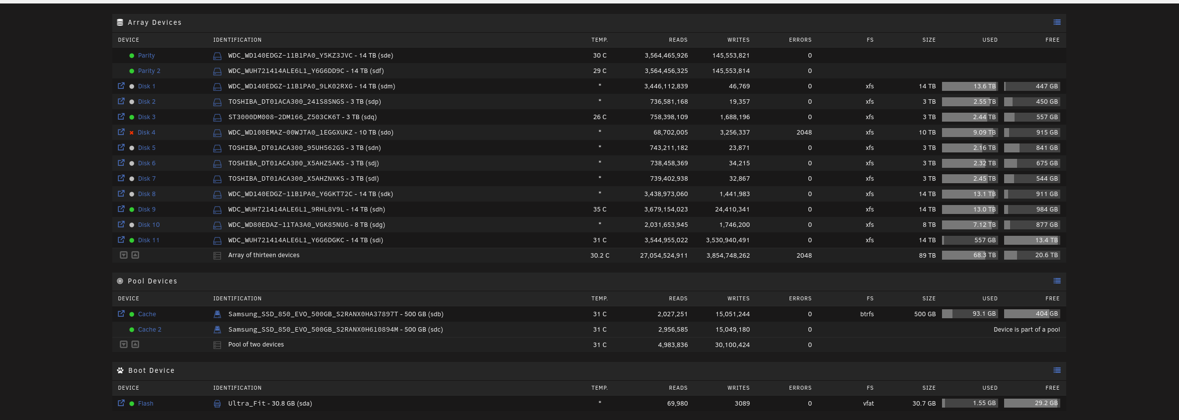

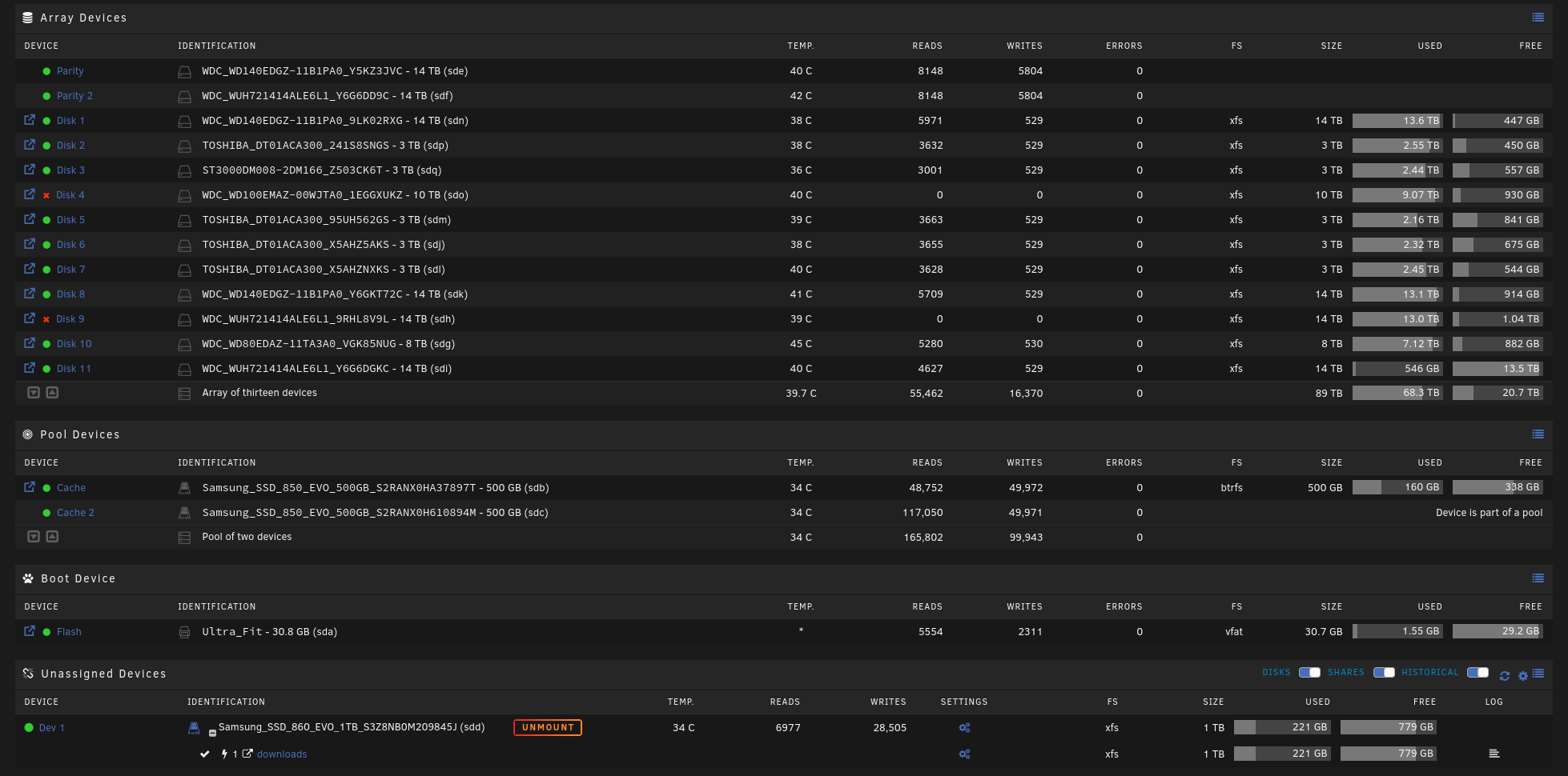

Everything was fantastic till this Tuesday October 3, I had another drive reporting errors so the disks was taken off and data was being emulated. I figured, now I gotta start investigating. But, as life happens, I was a bit too busy. Anyway, I woke this morning and now I have a second drive failing. So, I'm here now, in desperate need of some guidance, because 1 drive failure can be expected, 2 can be a coincidence, 3 though... well that's a pattern, and likely a problem (or at leasts I thinks it is).
I've attached the diagnostics effective this morning while the array was running, and I've attached a screenshot from how it was on Tuesday (10/03/23), and then one from this morning (10/05/23).

Diags are after rebooting, so we can't see what happened, but both disks look healthy, so most likely a power/connection problem, disk9 is showing some ATA issues after this latest reboot, since both disabled disks are on different controllers a power issue would be the first suspect, like a splitter if shared, or the PSU in general.
So, should I get a bigger PSU?
I would start by checking/replacing cables, but if you can try a different PSU it might be worth it, and if it happens again save the diags before rebooting.
