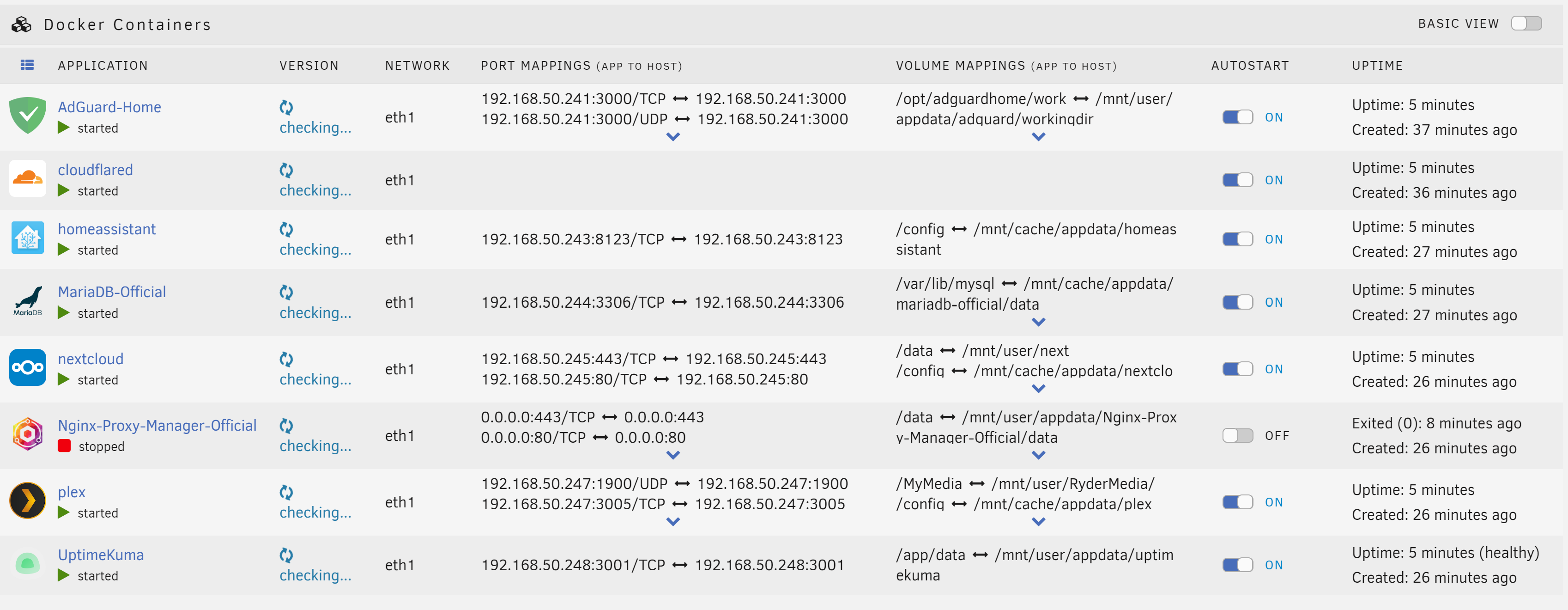

  1. So I did this and it worked for a brief period (several minutes) and then stopped. Same issue. I am now getting a slightly different issue. At first CA was not getting through to the internet. FCP was not giving a failure to access github warning, and unraid connect was not throwing an error. After following This post about manually setting DNS if CA does not load, I was able to get CA working again. However, now docker will not update. All of my apps have "unavailable" listed for the version number and when I click check for updates it shows the blue "checking" symbol for a bit and then just stops. Attached are new logs. Thanks nancenas-diagnostics-20230811-1354.zip

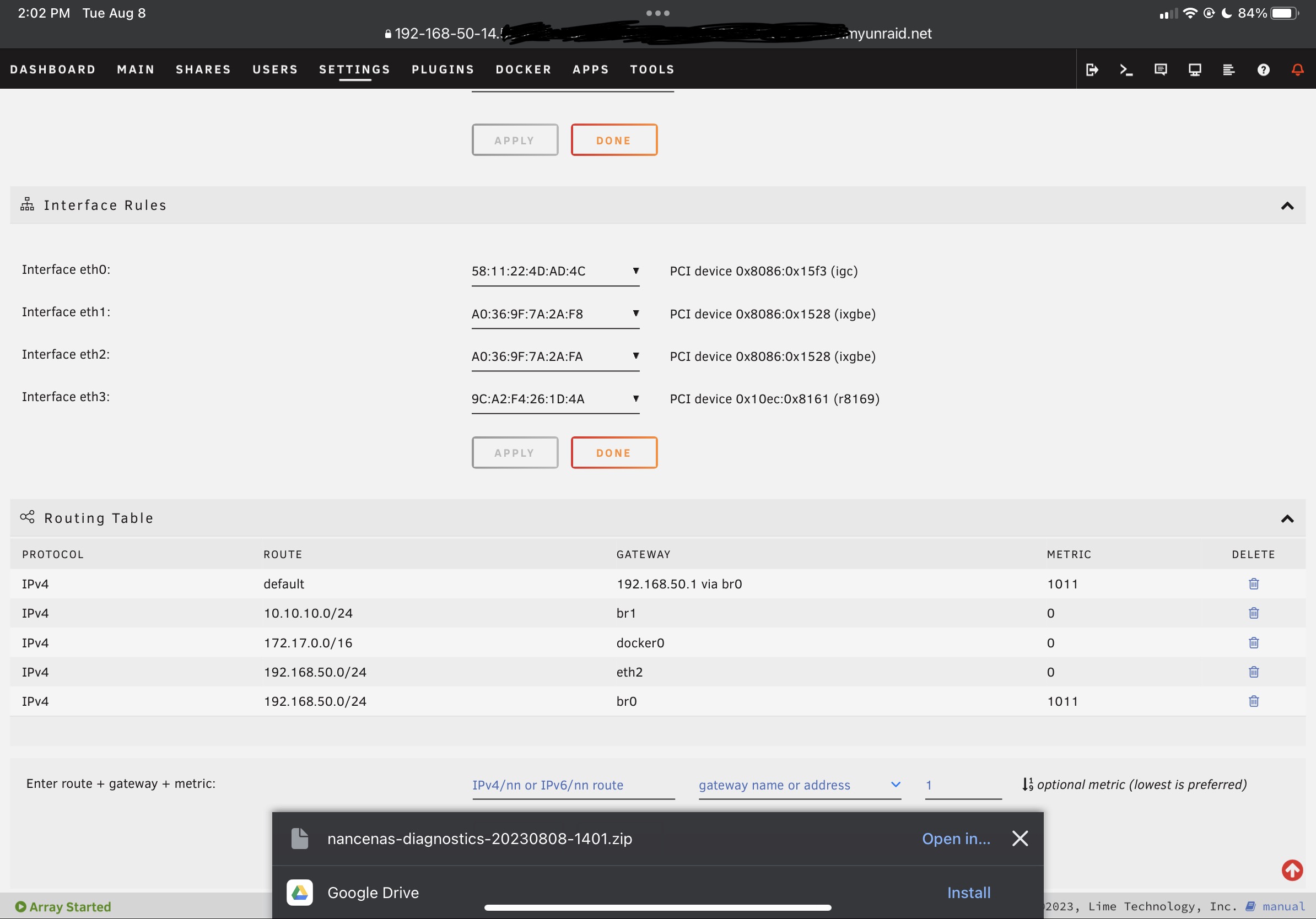

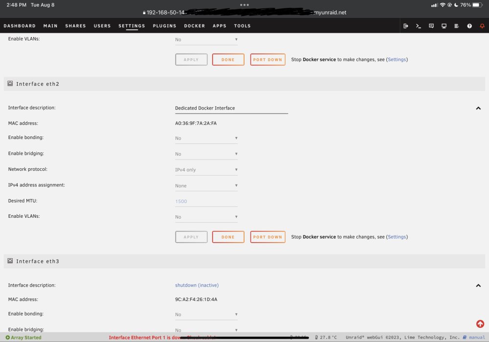

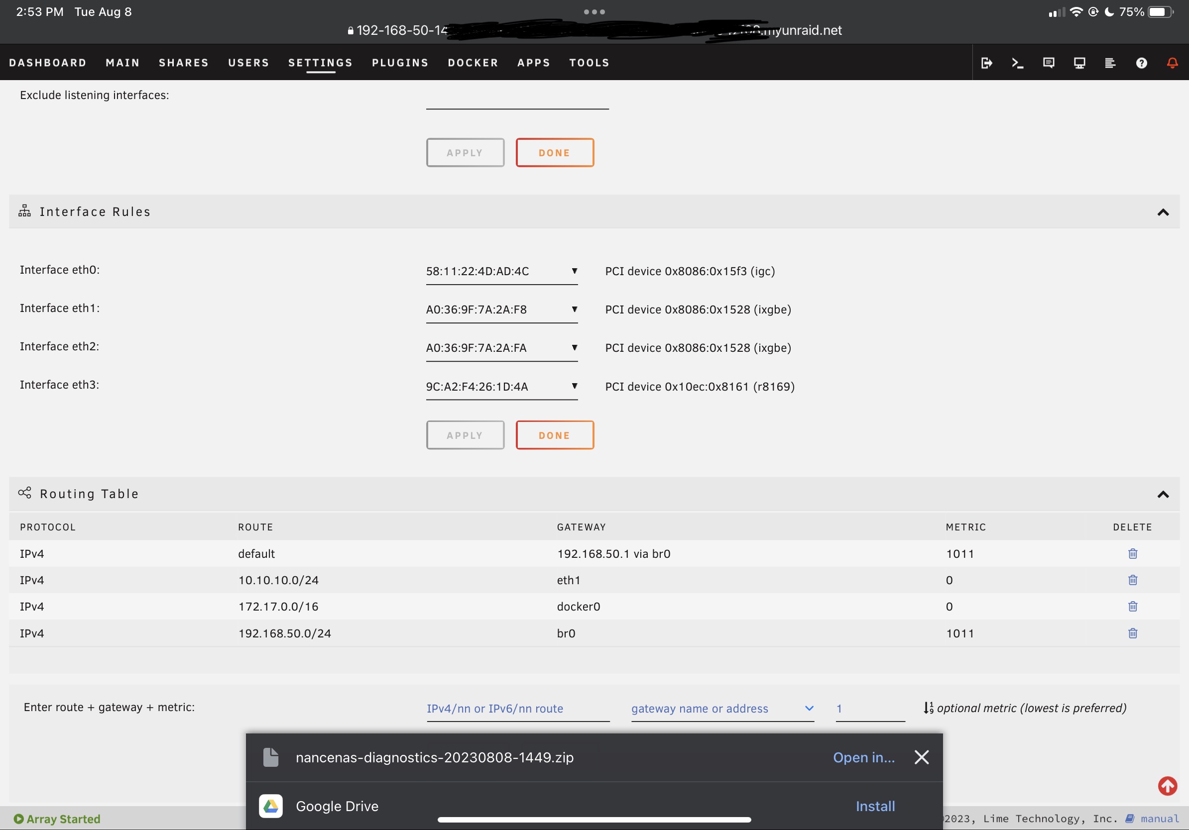

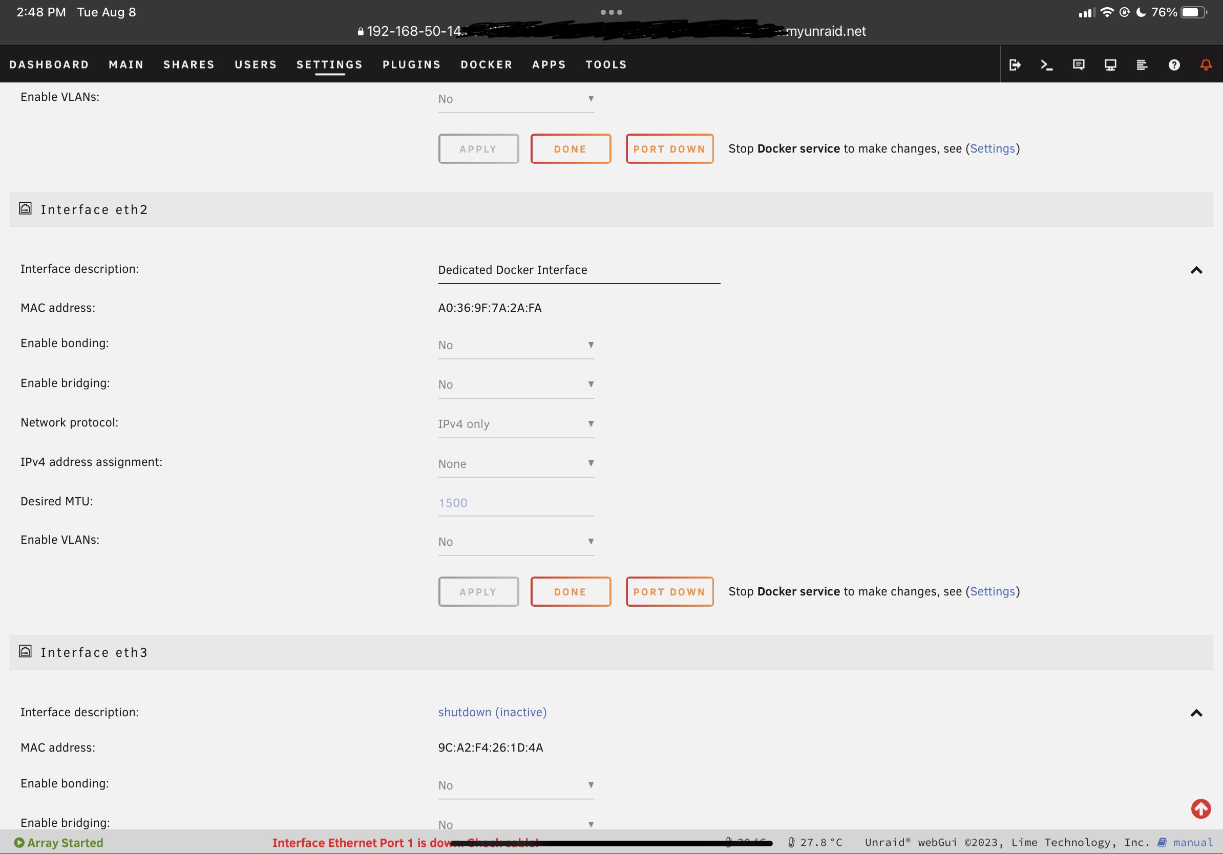

  2. Ok, I set eth1 to no bridging and eth2 back to none for ip assignment. The “two NICs on one network” warning has disappeared, however the system still is not able to access the internet. doing this also removed an entry from the routing table. Attached photos and an updated set of diagnostics nancenas-diagnostics-20230808-1449.zip

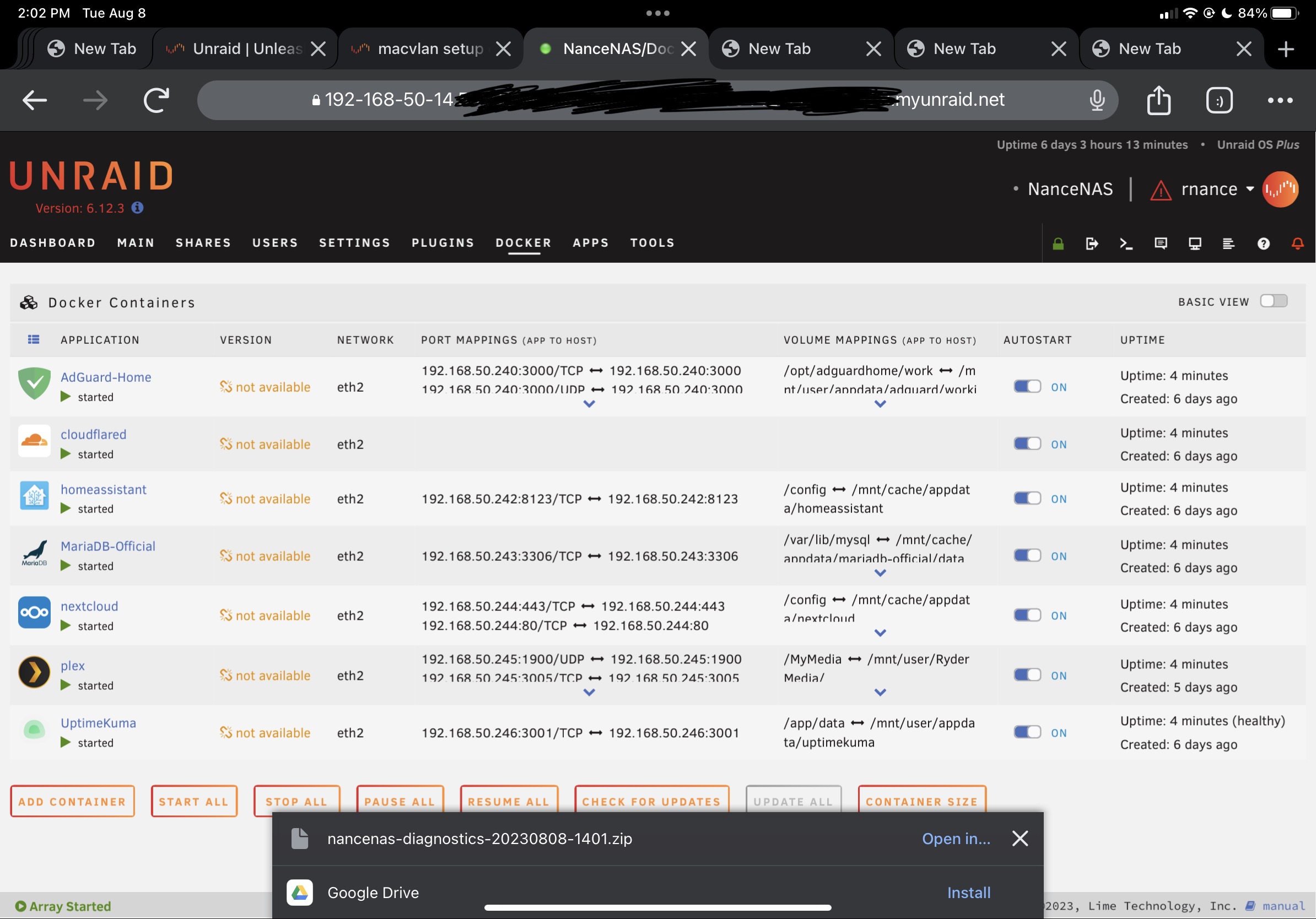

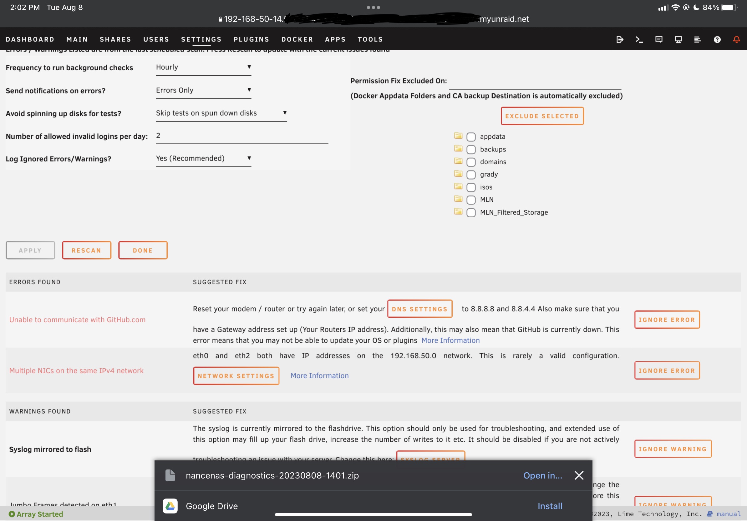

  3. Unfortunately this didn’t work. I’ve included my updated diagnostics. I am now also getting a two NICs on one network warning from FCP. Still getting no internet access to docker containers or to unraid. I’ve also included a photo of the routing table. All of these were automatically configured. Eth2 is the docker configured interface. Br0/eth0 is the onboard nic. Both are connected to my network switch. nancenas-diagnostics-20230808-1401.zip

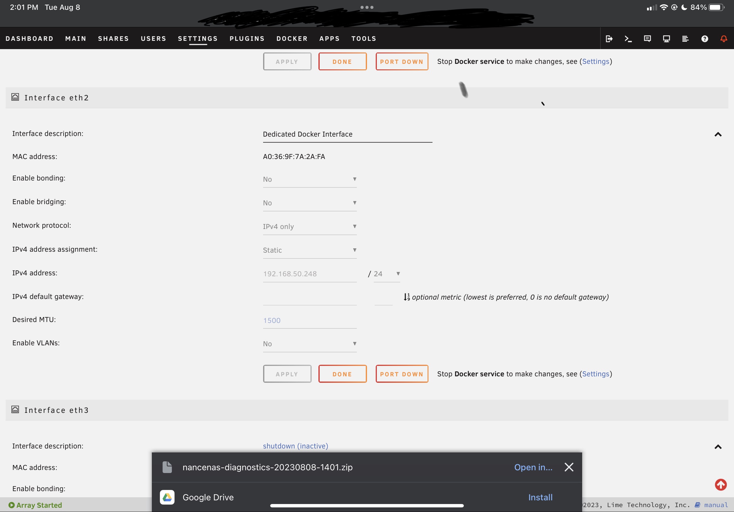

  5. rnance replied to rnance's topic in General Support
