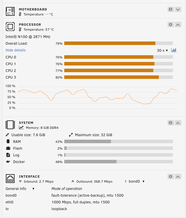

  8. Good evening fellow Unraiders I'm having an issue with my new motherboard witch has an N100 CPU on it. The CPU is being hammerd when deluge is uploading with 400-500 Mbit. Its a single upload, to a single thread. I'm wondering why the CPU-speed of the CPU hasent changed at-all at any given point yet? It's a steady 2871 MHz, regardless if the CPU is stressed or idle? I would think that the CPU wouldent be stressed from a little torrenting? I havent been in the BIOS yet, but I wanted to hear ideas first, since I dont have much knowledge about how to regulate COU settings anyway The BIOS may have an update? ASRock N100DC-ITX American Megatrends International, LLC., Version 1.05 BIOS dated: Thu 30 Mar 2023 12:00:00 AM PDT
