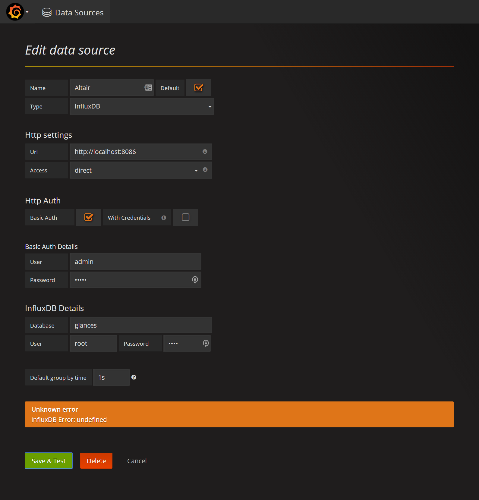

  7. Okay, I tried to set everything up, but I am complete newbie to UnRaid and dockers (and linux). All I want for now is for Grafana to somehow get the current (and past) data from Glances and display it. I installed grafana, influxdb and glances. Grafana I running and I imported the json from https://github.com/nicolargo/glances/blob/master/conf/glances-grafana.json. I also managed to activate the InfluxDB admin web interface and created multiple DBs. The next step was installing Glances and running it with --export-influxdb . Since then, Glances is somehow failing to start. See log: I then tried to at least include the DB from InfluxDB in Grafana which is giving me an error I don't quite understand or with what I have no idea what to do now. (See attached .png) I would apprechiate any help
