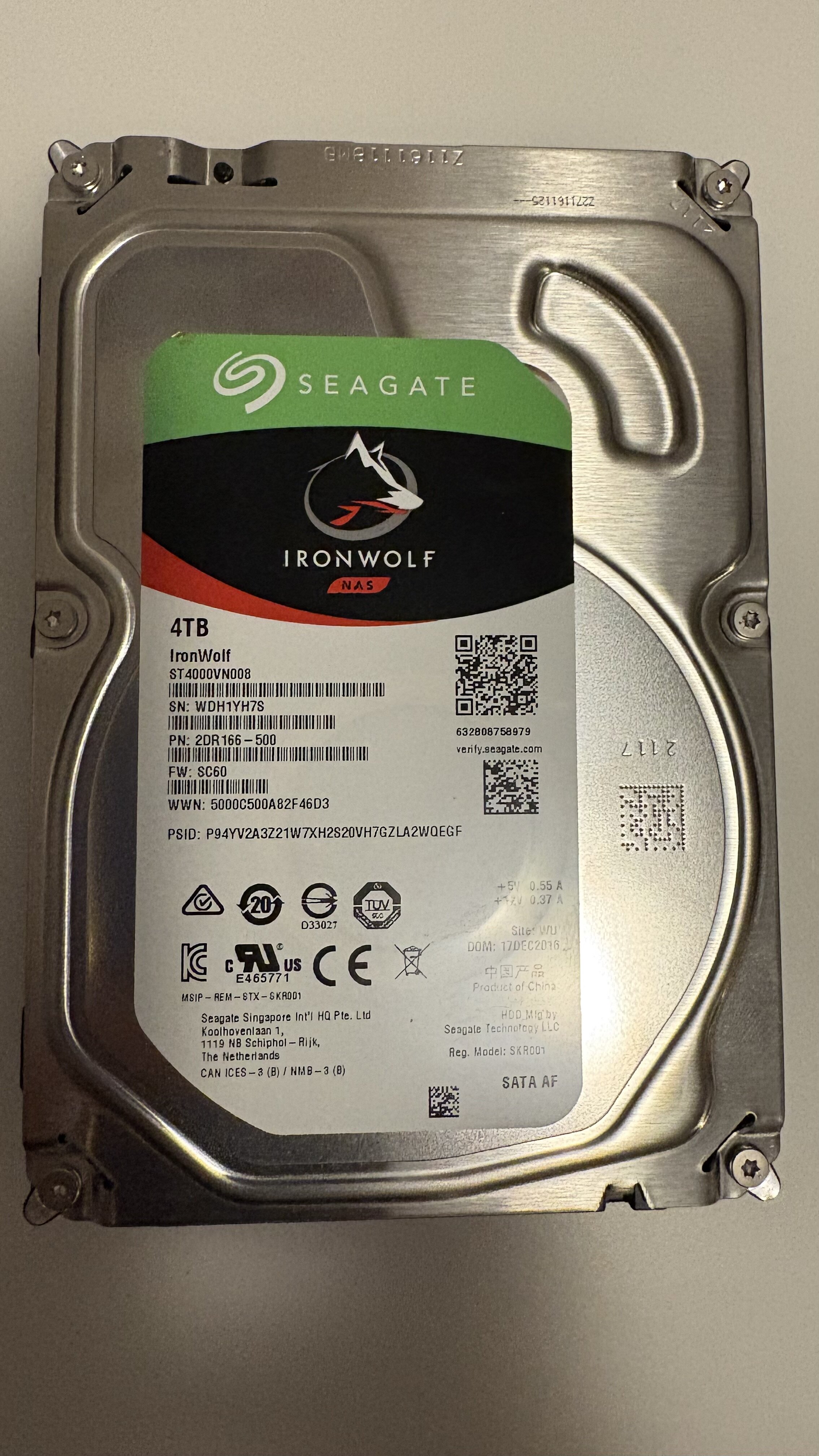

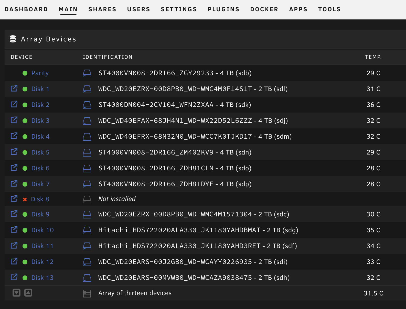

  6. i´m totalt lost and can't seem to solve this problem. It's related to this thread. I decided to buy a new motherboard,CPU,RAM. MSI PRO H610M-E DDR4 Intel Core i3-12100 Crucial RAM CT2K16G4DFRA32A 32GB I configured BIOS as instruction for Unraid. Started Unraid and disk 8 is not detected. Stoped the Array but there are no disk to assign. The disk is present and I tried changed to new one but same behaviour. Unraid doesn't recognise that there is a disk thats not assigned. Doesn't show up as unassigned either. Need help t20-diagnostics-20250504-1540.zip

  8. There is something wrong with my SAS Controller card. When I put in an old sata controller card for just that disk it worked. So i will buy a other sas card.
  9. So strange it's just that disk. I have tried with 3 different disk now. I will try with other card and just for that disk and see what happens

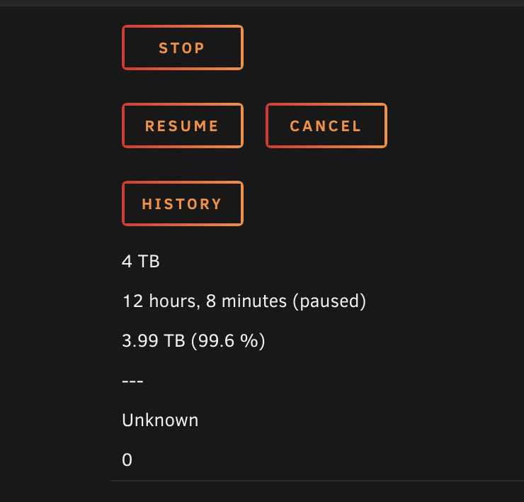

  10. NOOOOO it stopped at 99.6% Please someone that can decipher the log......I can't. t20-diagnostics-20250313-1258.zip
