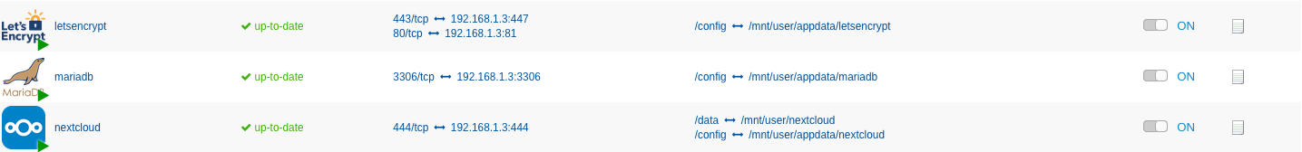

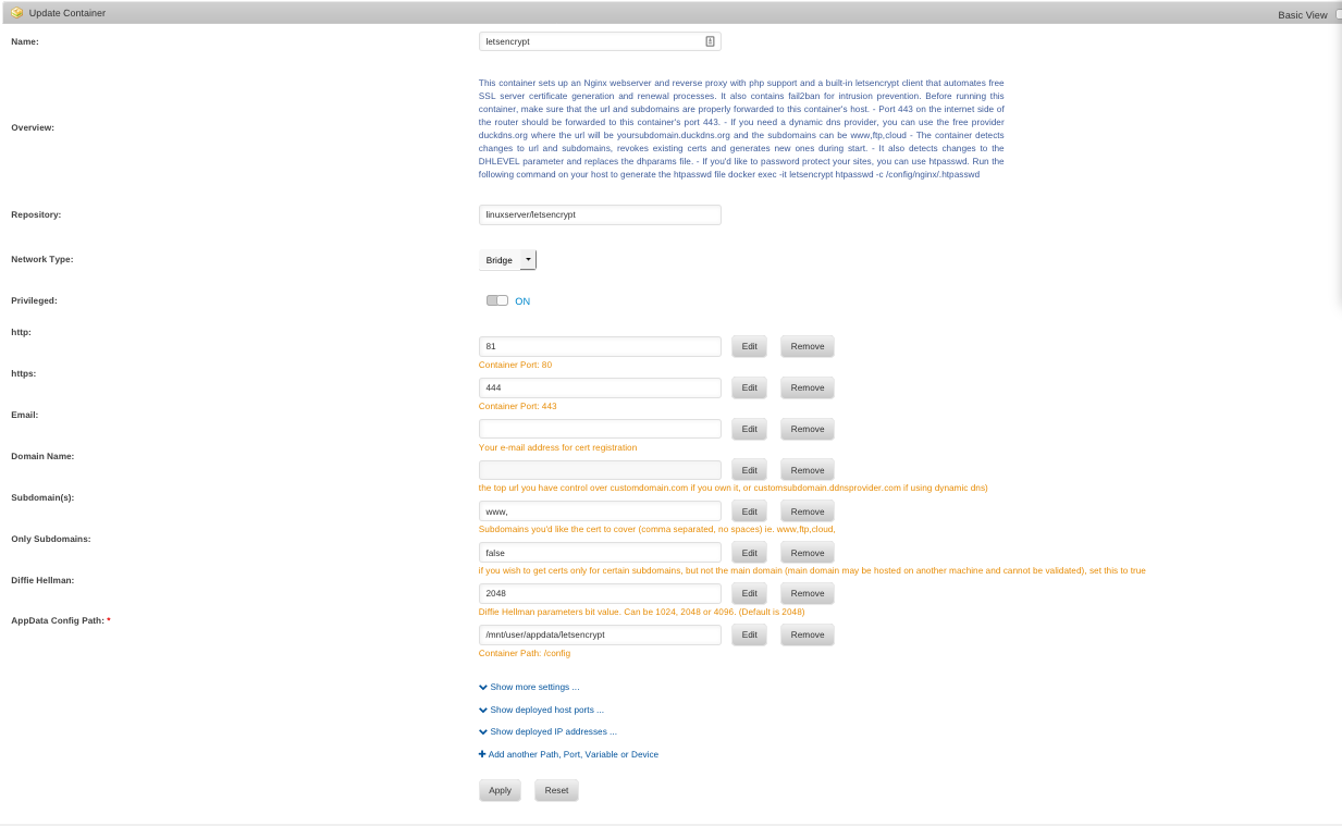

So I hate to add to the chaos...but I use this docker daily for my business in conjunction with NextCloud.... Basically I read about the problem and issued the fix (HTTPSVAR True & Router 80 to 81 & Router 443 to 444) Upon UnRaid update and reboot I can't even start my container. I've attached images. (I know the email and domain are missing I took them out) The log simply reads: "Error grabbing logs: EOF" I've tried uninstalling and reinstalling the container. Thanks for all you guys do to keep us running. I hope I included enough info.
