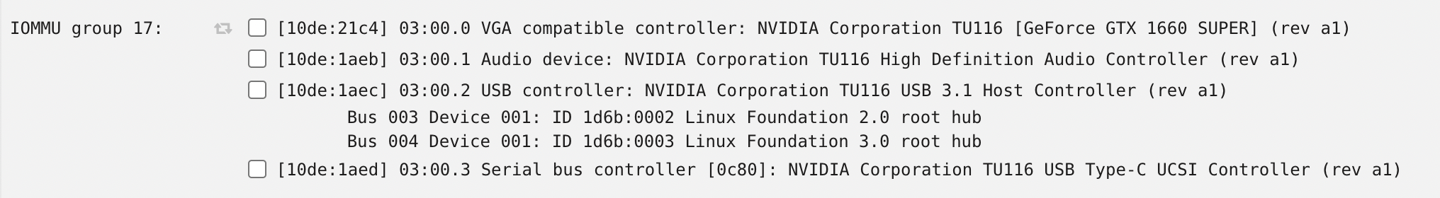

I have a windows vm with a nvidia 3070 passed through to it, I want to add a 1660 super. When I try to start the vm I get this error: internal error: qemu unexpectedly closed the monitor: 2021-11-02T22:10:45.645683Z qemu-system-x86_64: -device vfio-pci,host=0000:03:00.0,id=hostdev0,bus=pci.0,addr=0x6: vfio 0000:03:00.0: group 17 is not viable Please ensure all devices within the iommu_group are bound to their vfio bus driver. In tools system devices I can see this group groups 17 And here is all the info from system devices: CI Devices and IOMMU Groups IOMMU group 0: [8086:3ec6] 00:00.0 Host bridge: Intel Corporation 8th Gen Core Processor Host Bridge/DRAM Registers (rev 07) IOMMU group 1: [8086:1901] 00:01.0 PCI bridge: Intel Corporation 6th-10th Gen Core Processor PCIe Controller (x16) (rev 07) [10de:2484] 01:00.0 VGA compatible controller: NVIDIA Corporation GA104 [GeForce RTX 3070] (rev a1) [10de:228b] 01:00.1 Audio device: NVIDIA Corporation GA104 High Definition Audio Controller (rev a1) IOMMU group 2: [8086:3e96] 00:02.0 Display controller: Intel Corporation CoffeeLake-S GT2 [UHD Graphics P630] IOMMU group 3: [8086:1911] 00:08.0 System peripheral: Intel Corporation Xeon E3-1200 v5/v6 / E3-1500 v5 / 6th/7th/8th Gen Core Processor Gaussian Mixture Model IOMMU group 4: [8086:a379] 00:12.0 Signal processing controller: Intel Corporation Cannon Lake PCH Thermal Controller (rev 10) IOMMU group 5: [8086:a36d] 00:14.0 USB controller: Intel Corporation Cannon Lake PCH USB 3.1 xHCI Host Controller (rev 10) Bus 001 Device 001: ID 1d6b:0002 Linux Foundation 2.0 root hub Bus 001 Device 002: ID 0781:5530 SanDisk Corp. Cruzer Bus 001 Device 003: ID 046b:ff01 American Megatrends, Inc. Virtual Hub Bus 001 Device 004: ID 046b:ffb0 American Megatrends, Inc. Virtual Ethernet Bus 001 Device 005: ID 046b:ff10 American Megatrends, Inc. Virtual Keyboard and Mouse Bus 002 Device 001: ID 1d6b:0003 Linux Foundation 3.0 root hub [8086:a36f] 00:14.2 RAM memory: Intel Corporation Cannon Lake PCH Shared SRAM (rev 10) IOMMU group 6: [8086:a368] 00:15.0 Serial bus controller [0c80]: Intel Corporation Cannon Lake PCH Serial IO I2C Controller #0 (rev 10) [8086:a369] 00:15.1 Serial bus controller [0c80]: Intel Corporation Cannon Lake PCH Serial IO I2C Controller #1 (rev 10) IOMMU group 7: [8086:a360] 00:16.0 Communication controller: Intel Corporation Cannon Lake PCH HECI Controller (rev 10) [8086:a361] 00:16.1 Communication controller: Intel Corporation Device a361 (rev 10) [8086:a364] 00:16.4 Communication controller: Intel Corporation Cannon Lake PCH HECI Controller #2 (rev 10) IOMMU group 8: [8086:a352] 00:17.0 SATA controller: Intel Corporation Cannon Lake PCH SATA AHCI Controller (rev 10) [3:0:0:0] disk ATA WDC WD80EZAZ-11T 0A83 /dev/sdb 8.00TB [4:0:0:0] disk ATA WDC WD80EZAZ-11T 0A83 /dev/sdc 8.00TB [5:0:0:0] disk ATA WDC WD80EZAZ-11T 0A83 /dev/sdd 8.00TB [6:0:0:0] disk ATA WDC WD80EZAZ-11T 0A83 /dev/sde 8.00TB [7:0:0:0] disk ATA CT120BX500SSD1 R013 /dev/sdf 120GB IOMMU group 9: [8086:a340] 00:1b.0 PCI bridge: Intel Corporation Cannon Lake PCH PCI Express Root Port #17 (rev f0) IOMMU group 10: [8086:a32c] 00:1b.4 PCI bridge: Intel Corporation Cannon Lake PCH PCI Express Root Port #21 (rev f0) IOMMU group 11: [8086:a338] 00:1c.0 PCI bridge: Intel Corporation Cannon Lake PCH PCI Express Root Port #1 (rev f0) IOMMU group 12: [8086:a330] 00:1d.0 PCI bridge: Intel Corporation Cannon Lake PCH PCI Express Root Port #9 (rev f0) IOMMU group 13: [8086:a331] 00:1d.1 PCI bridge: Intel Corporation Cannon Lake PCH PCI Express Root Port #10 (rev f0) IOMMU group 14: [8086:a332] 00:1d.2 PCI bridge: Intel Corporation Cannon Lake PCH PCI Express Root Port #11 (rev f0) IOMMU group 15: [8086:a328] 00:1e.0 Communication controller: Intel Corporation Cannon Lake PCH Serial IO UART Host Controller (rev 10) IOMMU group 16: [8086:a309] 00:1f.0 ISA bridge: Intel Corporation Cannon Point-LP LPC Controller (rev 10) [8086:a323] 00:1f.4 SMBus: Intel Corporation Cannon Lake PCH SMBus Controller (rev 10) [8086:a324] 00:1f.5 Serial bus controller [0c80]: Intel Corporation Cannon Lake PCH SPI Controller (rev 10) IOMMU group 17: [10de:21c4] 03:00.0 VGA compatible controller: NVIDIA Corporation TU116 [GeForce GTX 1660 SUPER] (rev a1) [10de:1aeb] 03:00.1 Audio device: NVIDIA Corporation TU116 High Definition Audio Controller (rev a1) [10de:1aec] 03:00.2 USB controller: NVIDIA Corporation TU116 USB 3.1 Host Controller (rev a1) Bus 003 Device 001: ID 1d6b:0002 Linux Foundation 2.0 root hub Bus 004 Device 001: ID 1d6b:0003 Linux Foundation 3.0 root hub [10de:1aed] 03:00.3 Serial bus controller [0c80]: NVIDIA Corporation TU116 USB Type-C UCSI Controller (rev a1) IOMMU group 18: [144d:a808] 04:00.0 Non-Volatile memory controller: Samsung Electronics Co Ltd NVMe SSD Controller SM981/PM981/PM983 [N:0:4:1] disk Samsung SSD 970 EVO Plus 1TB__1 /dev/nvme0n1 1.00TB IOMMU group 19: [8086:1533] 05:00.0 Ethernet controller: Intel Corporation I210 Gigabit Network Connection (rev 03) IOMMU group 20: [1a03:1150] 06:00.0 PCI bridge: ASPEED Technology, Inc. AST1150 PCI-to-PCI Bridge (rev 04) [1a03:2000] 07:00.0 VGA compatible controller: ASPEED Technology, Inc. ASPEED Graphics Family (rev 41) IOMMU group 21: [8086:1533] 08:00.0 Ethernet controller: Intel Corporation I210 Gigabit Network Connection (rev 03) CPU Thread Pairings Pair 1: cpu 0 / cpu 6 Pair 2: cpu 1 / cpu 7 Pair 3: cpu 2 / cpu 8 Pair 4: cpu 3 / cpu 9 Pair 5: cpu 4 / cpu 10 Pair 6: cpu 5 / cpu 11 USB Devices Bus 001 Device 001: ID 1d6b:0002 Linux Foundation 2.0 root hub Bus 001 Device 002: ID 0781:5530 SanDisk Corp. Cruzer Bus 001 Device 003: ID 046b:ff01 American Megatrends, Inc. Virtual Hub Bus 001 Device 004: ID 046b:ffb0 American Megatrends, Inc. Virtual Ethernet Bus 001 Device 005: ID 046b:ff10 American Megatrends, Inc. Virtual Keyboard and Mouse Bus 002 Device 001: ID 1d6b:0003 Linux Foundation 3.0 root hub Bus 003 Device 001: ID 1d6b:0002 Linux Foundation 2.0 root hub Bus 004 Device 001: ID 1d6b:0003 Linux Foundation 3.0 root hub SCSI Devices [0:0:0:0] disk SanDisk Cruzer 1.26 /dev/sda 8.00GB [3:0:0:0] disk ATA WDC WD80EZAZ-11T 0A83 /dev/sdb 8.00TB [4:0:0:0] disk ATA WDC WD80EZAZ-11T 0A83 /dev/sdc 8.00TB [5:0:0:0] disk ATA WDC WD80EZAZ-11T 0A83 /dev/sdd 8.00TB [6:0:0:0] disk ATA WDC WD80EZAZ-11T 0A83 /dev/sde 8.00TB [7:0:0:0] disk ATA CT120BX500SSD1 R013 /dev/sdf 120GB [N:0:4:1] disk Samsung SSD 970 EVO Plus 1TB__1 /dev/nvme0n1 1.00TB what can I do to get the 1660 working?

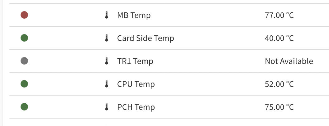

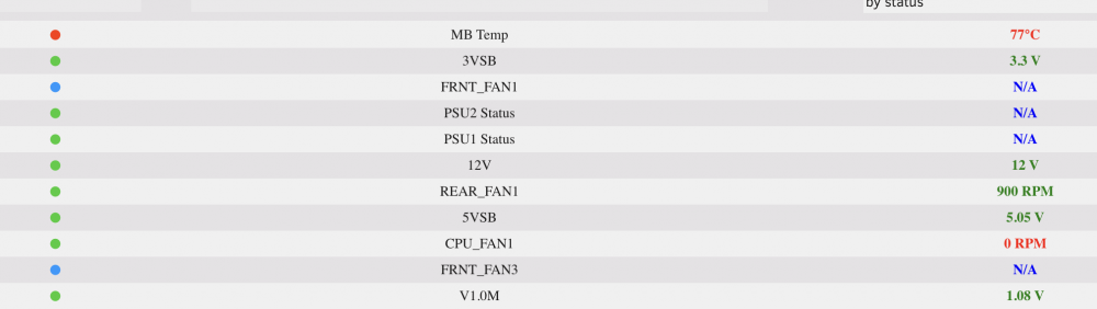

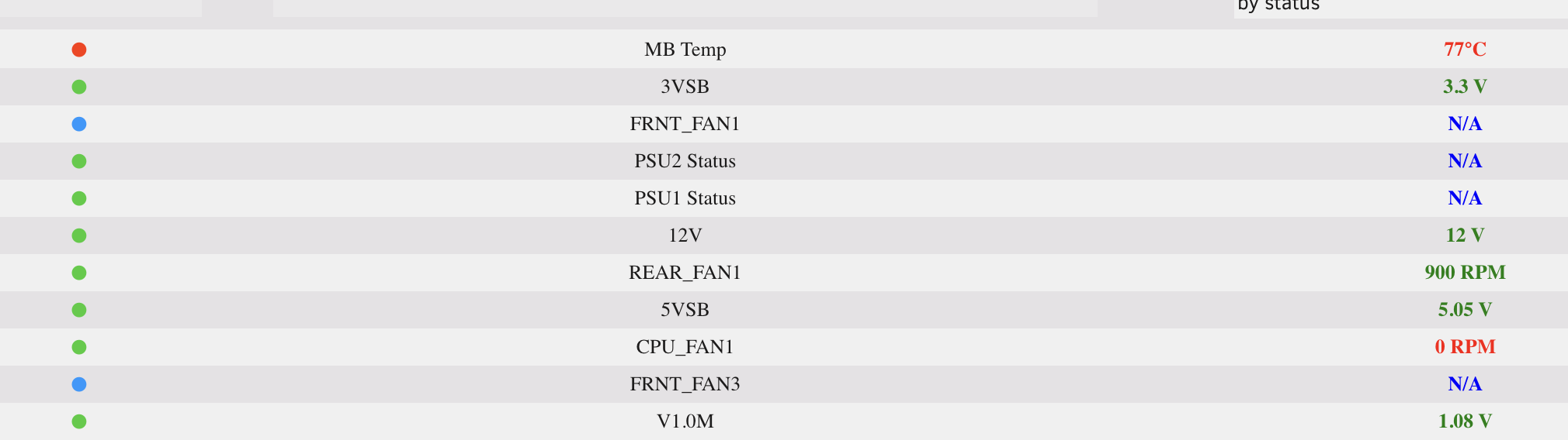

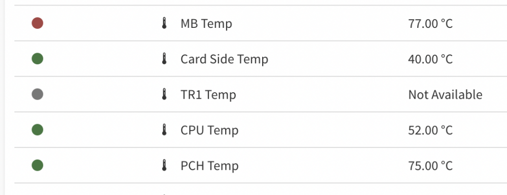

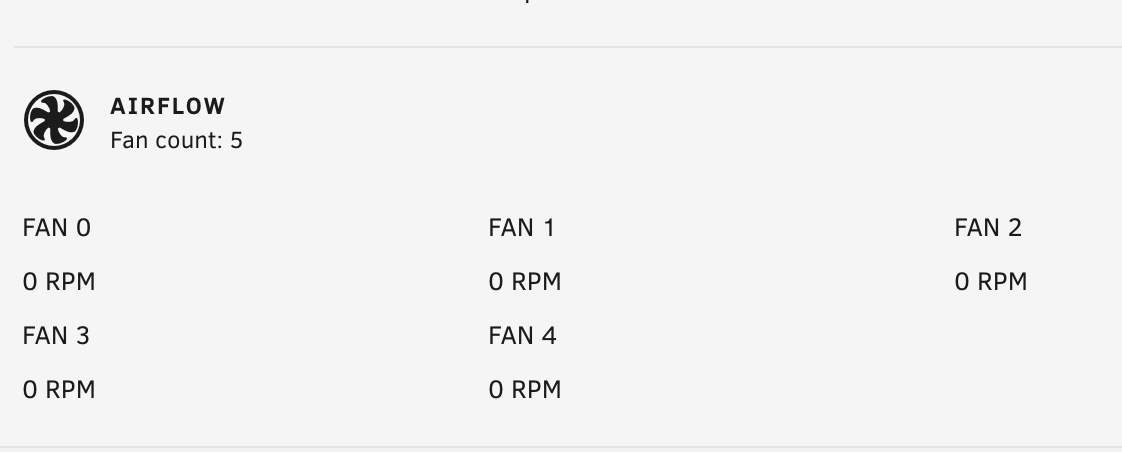

My board is currently reporting as hot from ipmi ipmi plugin Also I'm using a Fractal design meshify 2 which has a smart hub where I connect all the fans to including the 4 pin cpu fan then it connects to cpu_fan1. Problem is it's reporting as 0rpm and the red light next to cpu_fan1 on the motherboard is flashing. The fans which are plugged into the hub are spinning.
