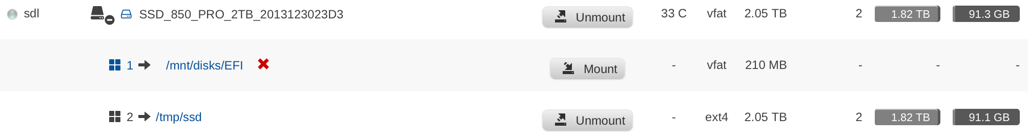

Me too, df has a strange way to round.
It does, except for the rounding where UD shows 91.1 GB while CLI df -H shows 92 GB. UD's 91.1 is the correct value if we can believe the free block count.
df is a bit of mystery for me. Even taking into account the reserved blocks the figures don't add up and also the rounding is strange: 500048128 blocks of 4096 Bytes each would result in 2048197132288 Bytes. With SI Terabytes this would be 2.048 TB or, rounded 2.0 TB, not 2.1 TB Anyway, I think the idea to display the free value from df instead of the calculated one is good, although you will then get questions as to why they don't add up :-)
:-) Now I am really confused. Why do I get different values on the console than UD? The disk is mounted read-only, so there is no way that the value could have changed between the read-out in CLI vs. GUI and anyway the values are still the same now. I also tested whether device vs. mount point would make a difference, but they don't: root@Tower:/# df /dev/sdl2 Filesystem 1K-blocks Used Available Use% Mounted on /dev/sdl2 1968675628 1779677440 88972180 96% /tmp/ssd root@Tower:/# df /tmp/ssd Filesystem 1K-blocks Used Available Use% Mounted on /dev/sdl2 1968675628 1779677440 88972180 96% /tmp/ssd root@Tower:/# df -H /dev/sdl2 Filesystem Size Used Avail Use% Mounted on /dev/sdl2 2.1T 1.9T 92G 96% /tmp/ssd root@Tower:/# df -H /tmp/ssd Filesystem Size Used Avail Use% Mounted on /dev/sdl2 2.1T 1.9T 92G 96% /tmp/ssd By adding the reserved blocks I get closer to UD's numbers, but still not the same: root@Tower:/# tune2fs -l /dev/sdl2 | more tune2fs 1.43.6 (29-Aug-2017) Filesystem volume name: <none> Last mounted on: /media/ssd_out Filesystem UUID: 39d177ab-434d-4c62-b51a-dd892fef93f8 Filesystem magic number: 0xEF53 Filesystem revision #: 1 (dynamic) Filesystem features: has_journal ext_attr resize_inode dir_index filetype extent flex_bg sparse_super large_file huge_file un init_bg dir_nlink extra_isize Filesystem flags: unsigned_directory_hash Default mount options: user_xattr acl Filesystem state: clean Errors behavior: Continue Filesystem OS type: Linux Inode count: 125018112 Block count: 500048128 Reserved block count: 25002406 Free blocks: 47249547 Free inodes: 125004626 First block: 0 Block size: 4096 Fragment size: 4096 Reserved GDT blocks: 904 Blocks per group: 32768 Fragments per group: 32768 Inodes per group: 8192 Inode blocks per group: 512 Flex block group size: 16 Filesystem created: Wed Aug 10 02:35:21 2016 Last mount time: Fri Oct 27 18:55:12 2017 Last write time: Sat Oct 28 18:29:47 2017 Mount count: 78 Maximum mount count: -1 Last checked: Wed Aug 10 02:35:21 2016 Check interval: 0 (<none>) Lifetime writes: 19 TB Reserved blocks uid: 0 (user root) Reserved blocks gid: 0 (group root) First inode: 11 Inode size: 256 Required extra isize: 28 Desired extra isize: 28 Journal inode: 8 Default directory hash: half_md4 Directory Hash Seed: 9d471dae-1834-4b79-ad17-cbe71464c01f Journal backup: inode blocks Any ideas? Is "free" in UD the df value for free or is it size minus used?
